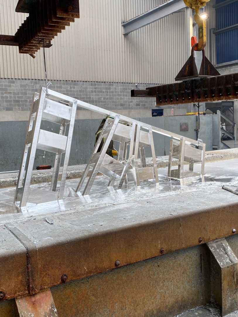

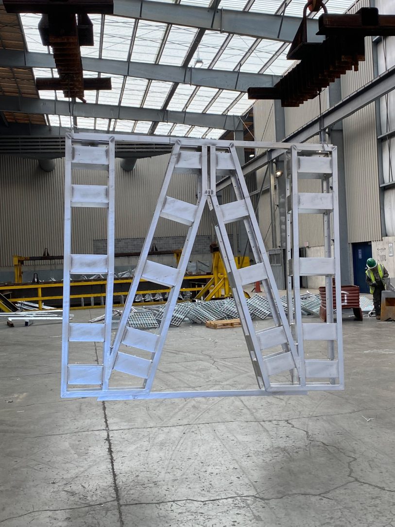

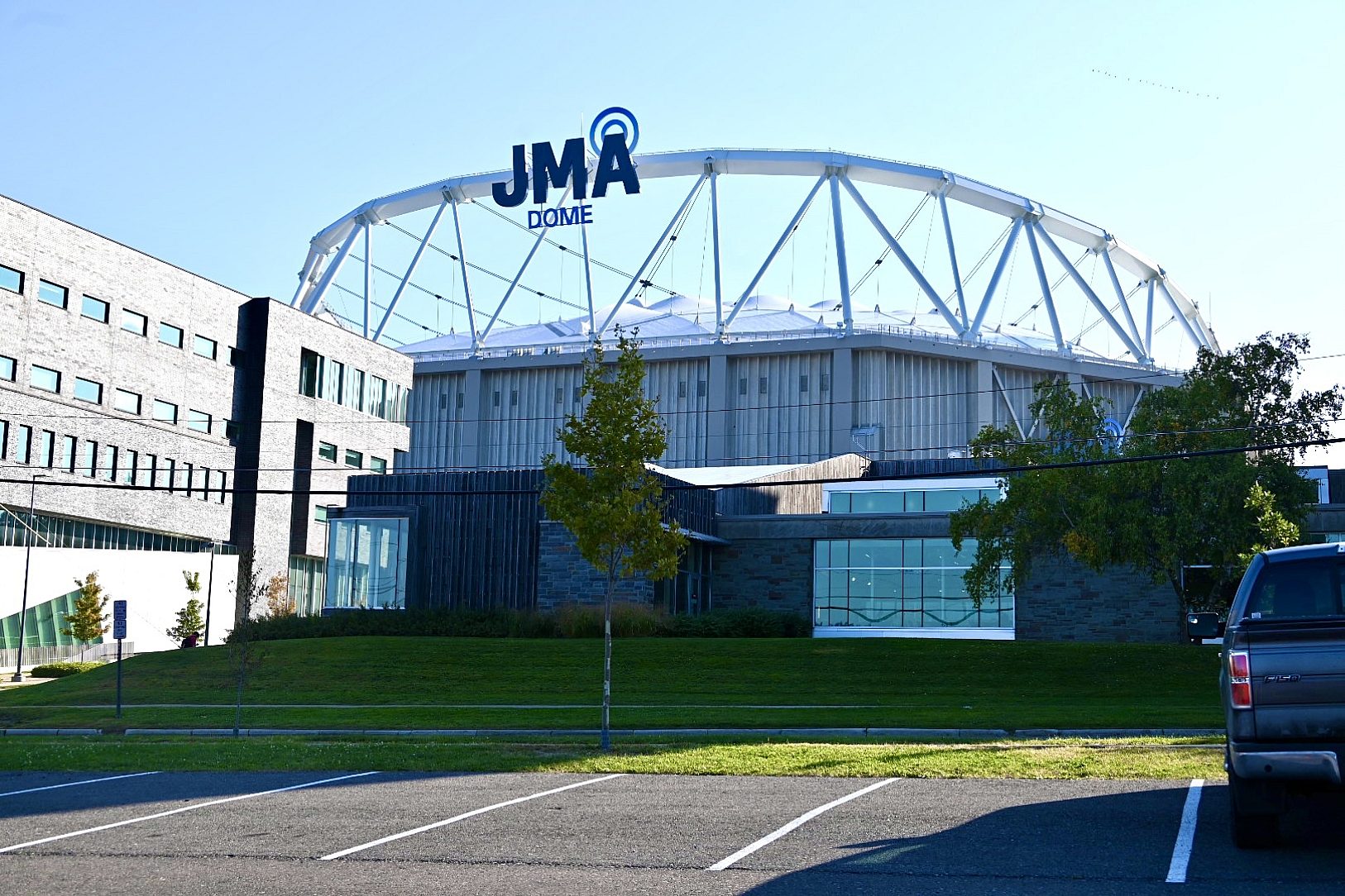

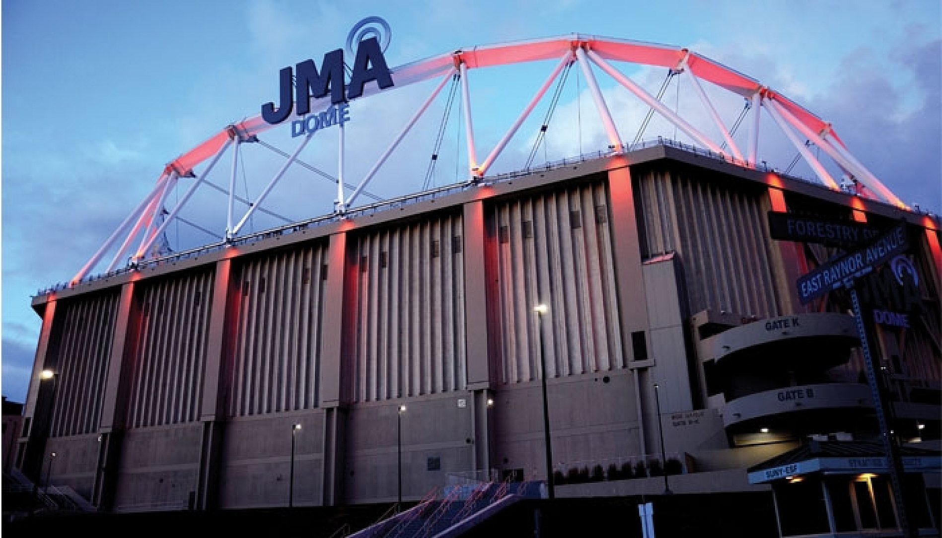

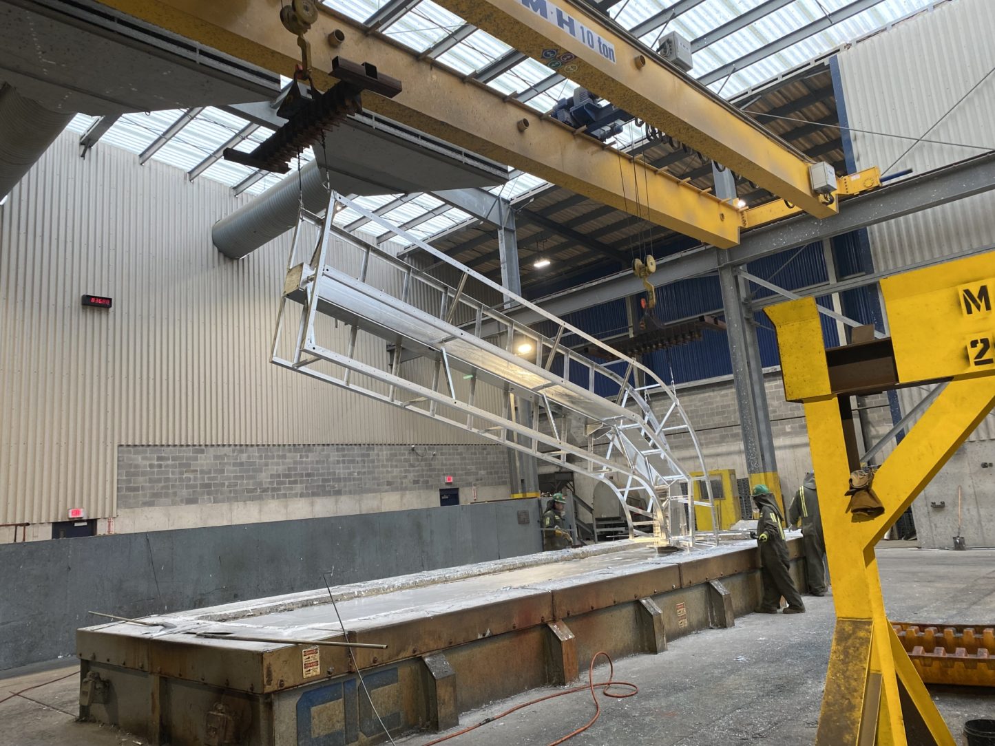

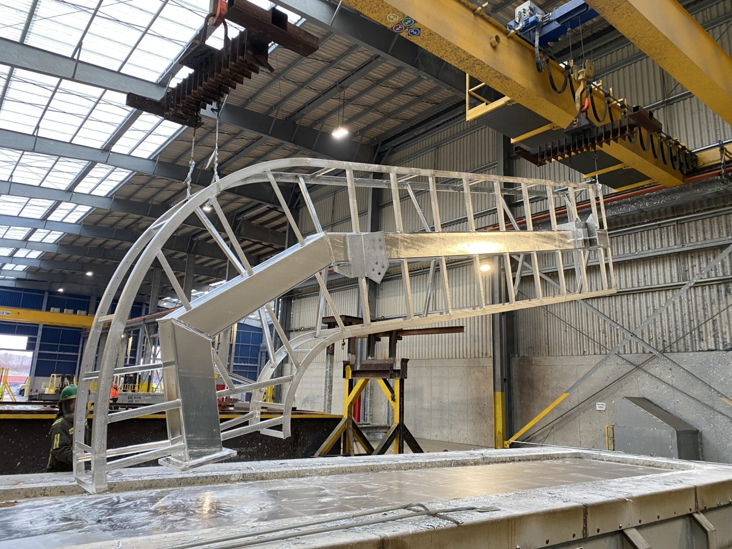

Four individual signs of the JMA Wireless logo were fabricated for this project. All the signs benefit from hot-dip galvanizing for corrosion protection then had a “skin” added to them made of stainless plates that were painted in the JMA logo color pallet. The signs are broken down by location on the dome. The crown truss sign, the largest of the four is mounted on the west side of the building, attached to the crown truss. The North sign was mounted on the north wall of the building and required a 56’ long tube truss to support it. Made in two assemblies, the tube truss was mounted between existing concrete precast columns that support the original structure. The southeast and southwest signs are identical to each other and placed on opposite corners of the building.
