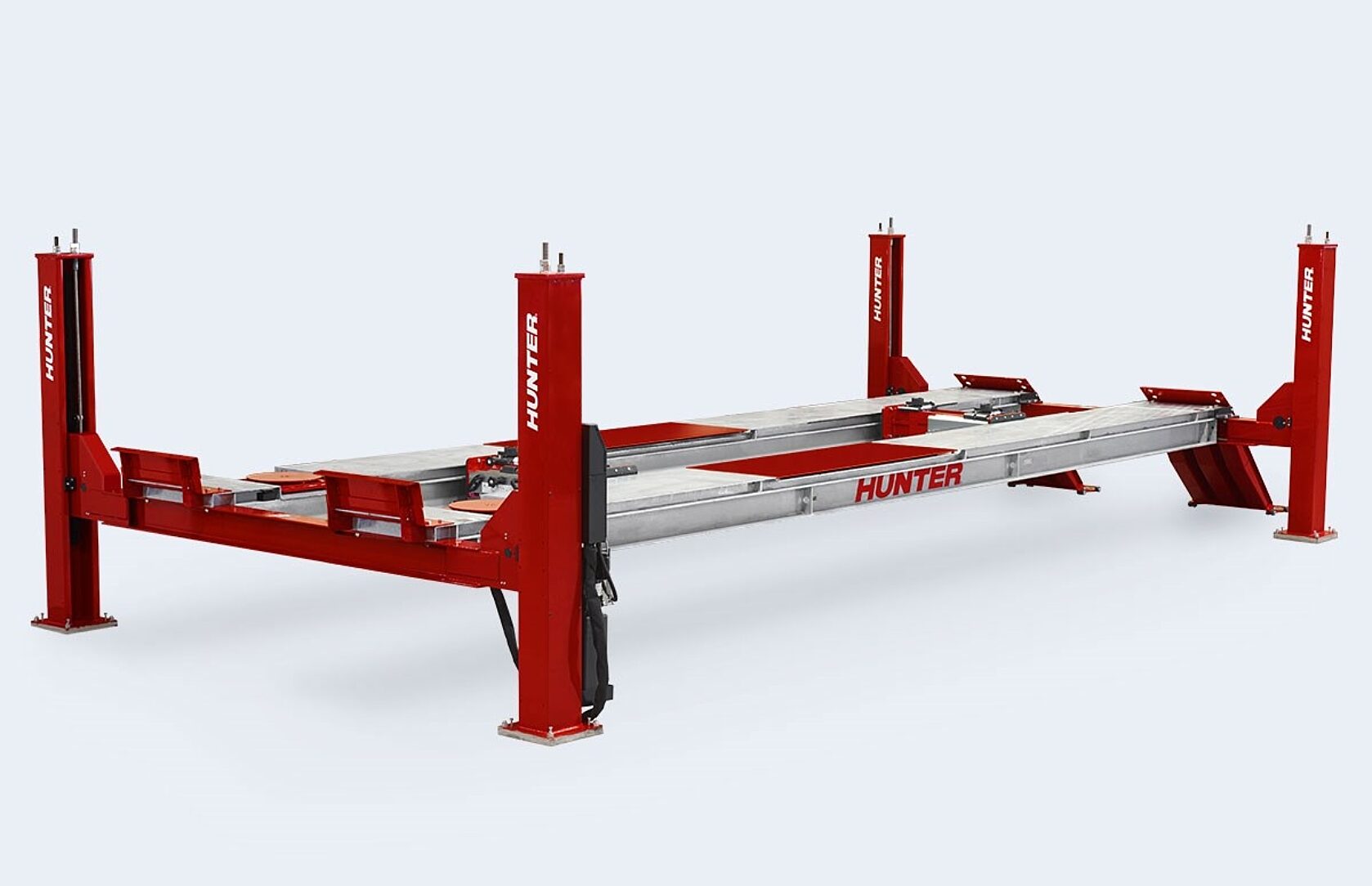

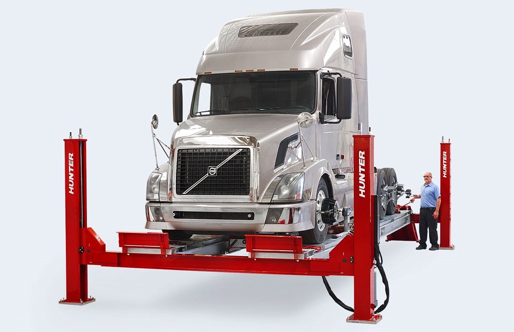

Hunter’s Heavy-Duty Four-Post semi and truck lift features a 35,000-lb. lifting capacity and 300-in. alignment wheelbase capability. The hot-dip galvanized runways offer the best in corrosion protection for your investment.

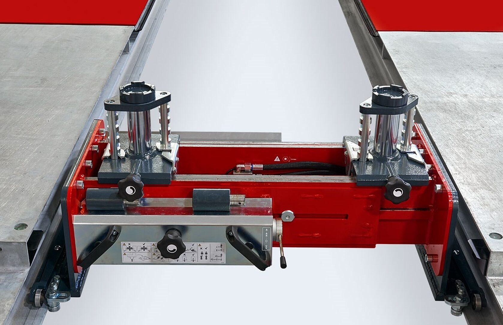

The lift comes alignment ready with turn plate pockets and slip plates for servicing standard vehicles. It can be equipped with optional Power slide and FIA turn plates and slip plates saving time by eliminating trips around the truck when locking and unlocking plates. The aligner can be connected to control all lock and unlock functions automatically.

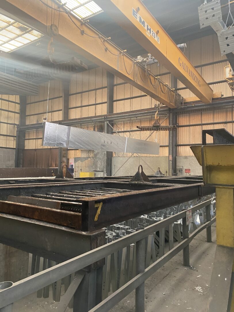

“Our customers were seeing a lot of corrosion of their lift ramps in the northern states due to road salts. Our customers have been very happy with the hot dip-galvanized option, and it has been a very popular choice.”
Originally the semi ramps used on the semi truck lifts were painted. When Hunter Engineering decided to hot-dip galvanize the ramps it took several meetings with the galvanizer and close review of AGA design materials to make the ramps suitable for hot-dip galvanizing. Ramps up to 30”x27’0”’ are now being galvanized.
