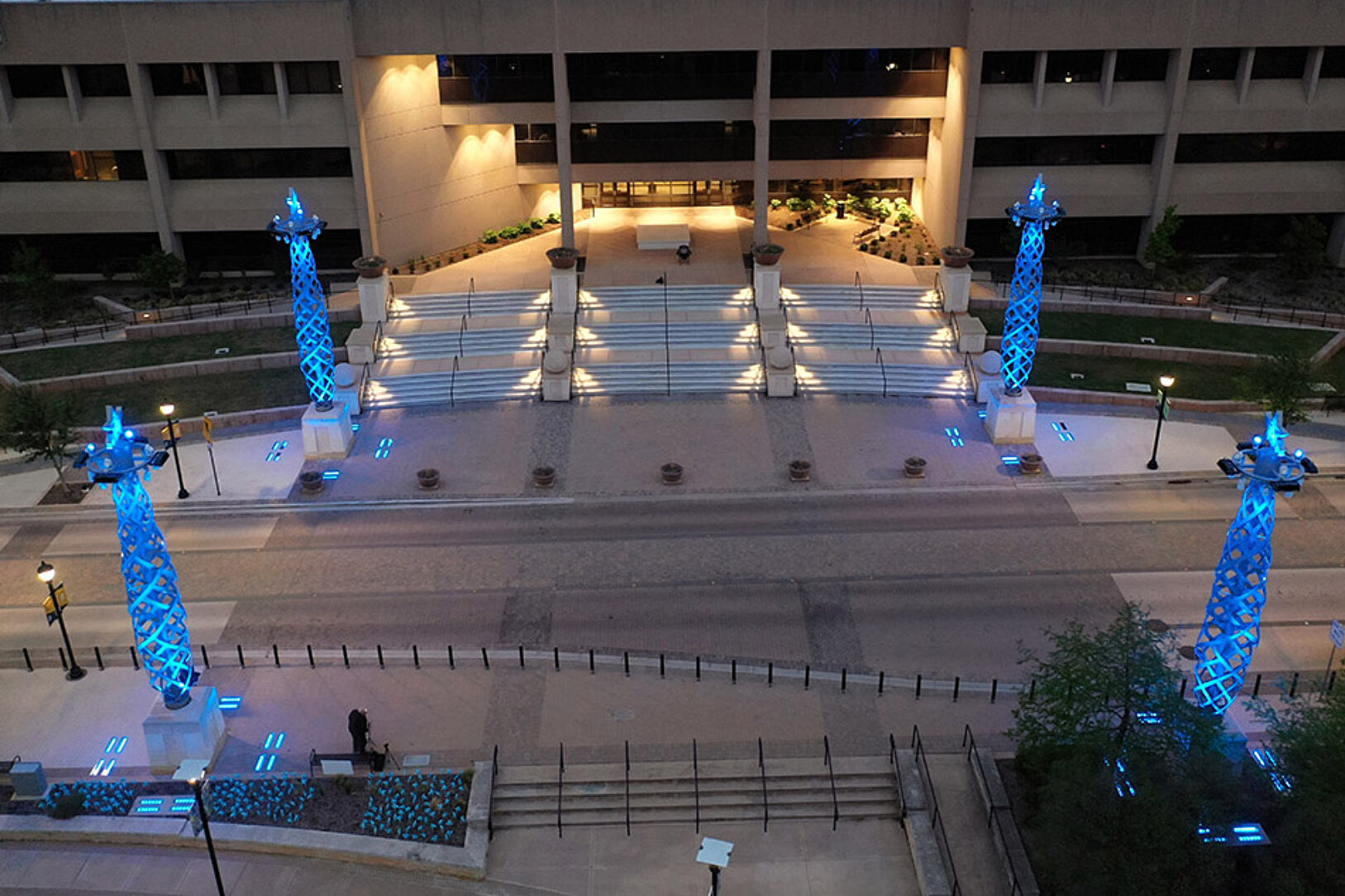

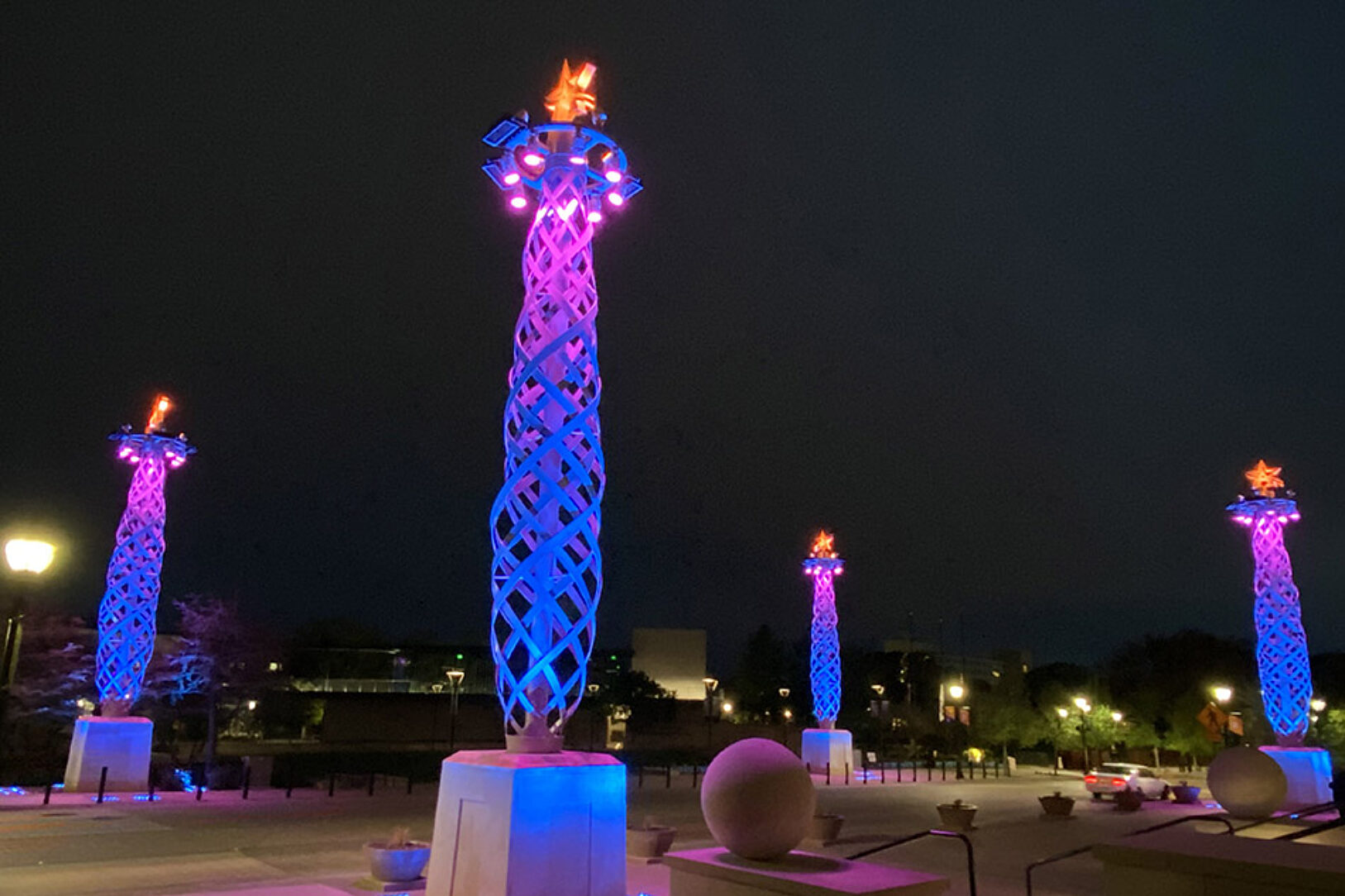

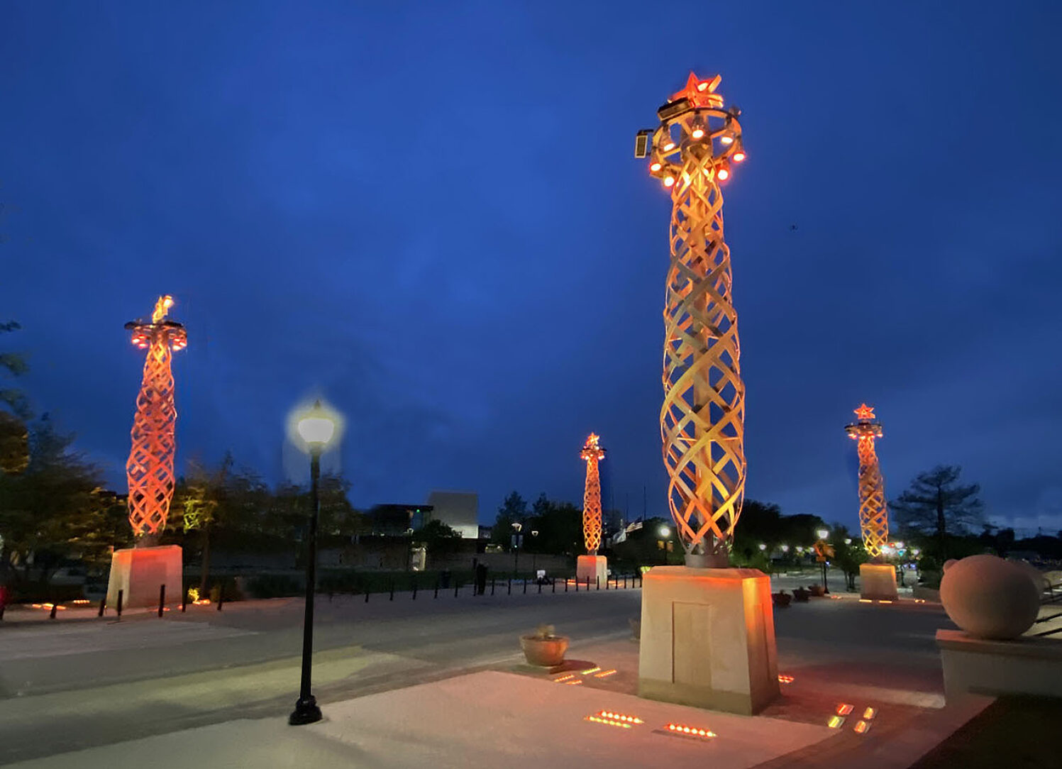

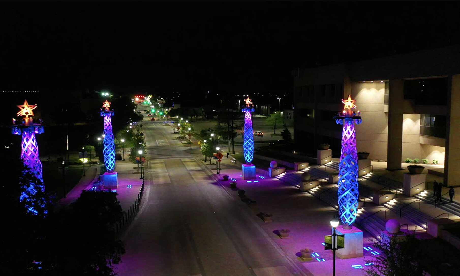

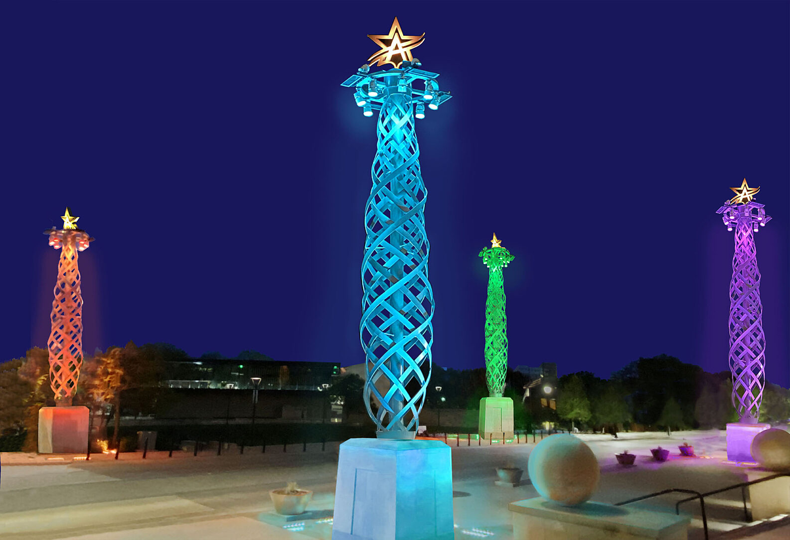

In 2021, O’Michael was commissioned by the City of Arlington to create an architectural enhancement for City Hall. The four Flamme d’Illuminacion sculptures define Arlington’s Cultural Arts District’s festival area. The four, four-story, computerized, light towers demark City Hall, Abrams Street Festival Zone and the Founder’s Park space. The sculptures are the culmination and pinnacle of the seven-year, $28 million renovation of Arlington’s Abrams Street infrastructure and City Hall’s public main entrance architecture.
Each tower is constructed of twelve bands, separated into two layers of six bands paired together with three in a clockwise rotation and the other three counterclockwise. The bands are separated by two-inch spacing made by one-inch round bar spacers. The spacers function as vibration stabilizers but also allowed enough space for an inserted paint gun to thoroughly coat the interior and exterior of the bands. The layers are offset 60-degrees with the layered pairs offset by 120-degrees which give the visual appearance of woven steel.
The three-ton obelisk towers sit atop seven-foot-tall concrete plinths and encase a ten-inch central pipe-mast. The pipe-mast is crowned with a four-spoke ring carrying twelve, full-color spectrum, LED lighting lamps and four stadium area lamps, and topped with the City of Arlington’s Star A logo. The color-programable LED lights can be changed for public events and holidays. Upon their unveiling, the Flamme d’Illuminacion towers were blue for Police week, pink for Breast Cancer Month, and red and gold for Christmas.

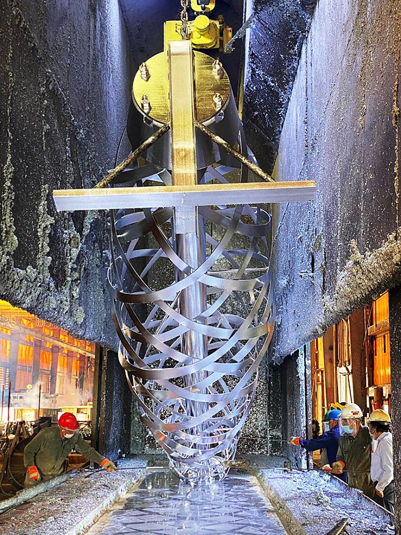

Prior to initiation of fabrication, O’Michael consulted with the galvanizer, as it is her practice to use galvanizing for her sculptures that necessitate industrial corrosion protection to extend the wet paint or powder coat finish durability. During the consultation, they discussed the placement and drilling of holes necessary for dipping in the molten zinc as well as the fabrication of stands for both ends of each tower to support them horizontally while in the bath. All the steel pieces were CAD-CAM cut, then hand formed before being welded with independent AWS inspectors at every phase. After galvanizing, the sculptures were finished with a high-tech primer and top-coated with industrial epoxy paint.
All finish work was done while the sculptures laid horizontally in the various shops. Future maintenance takes place in an open-exterior, public space with the sculptures vertically standing, touching sky. With the 40-foot height and complex jacket weave, durability is a prime requirement for Arlington. Hot-dip galvanizing was a critical design solution for the final coating durability.
