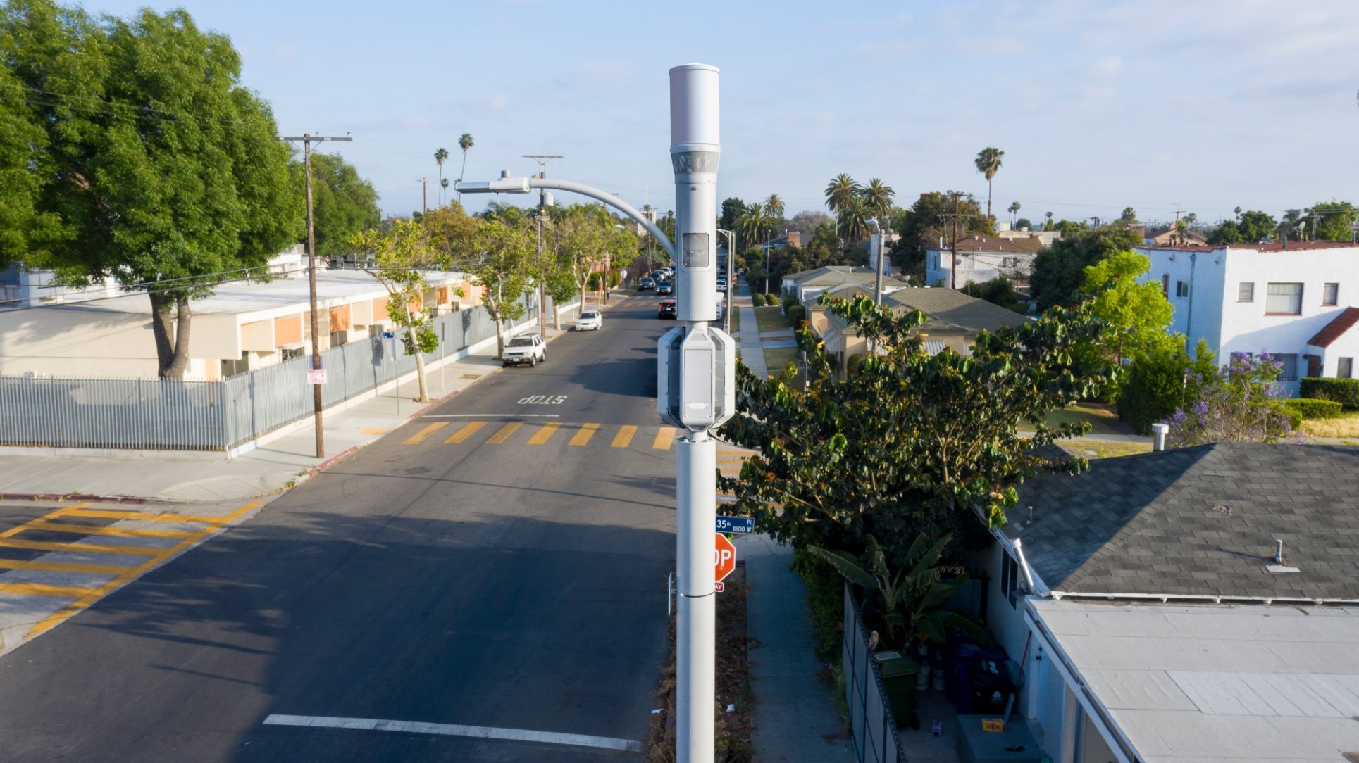

5G signals operate at a higher radio wave frequency and are much more easily blocked by objects, meaning antennas must be placed closer together and in much greater volume, thus creating the demand for hundreds of thousands of smaller 5G antennas. These additional antennas are classified as small-cells. Small-cell poles are generally about the size of streetlights, with a coverage area ranging from a few hundred feet, and upwards of 1,000 feet, depending on topography and capacity needs.
While municipalities encouraged a fast plan to facilitate an expedited 5G roll out across the country, cities concerned with the negative visual aspects of additional antennas, began passing legislation requiring that cell carriers disguise, camouflage, or obscure these small-cell antennas. This obstacle created a huge demand for innovative solutions for concealment with the flexibility to meet varying aesthetic and color demands.
Founded in 2007, ConcealFab of Colorado Springs, a Valmont Company, recognized this expansive opportunity, becoming one of the fastest-growing small-cell companies in the telecom industry. ConcealFab offers small-cell concealments for nearly every hybrid spectrum radio and antenna in the sector with a variety of steel pole and pole attachment styles to choose from. The designated locations for these small-cell concealments include commercial, industrial and residential areas in every major city across the country.

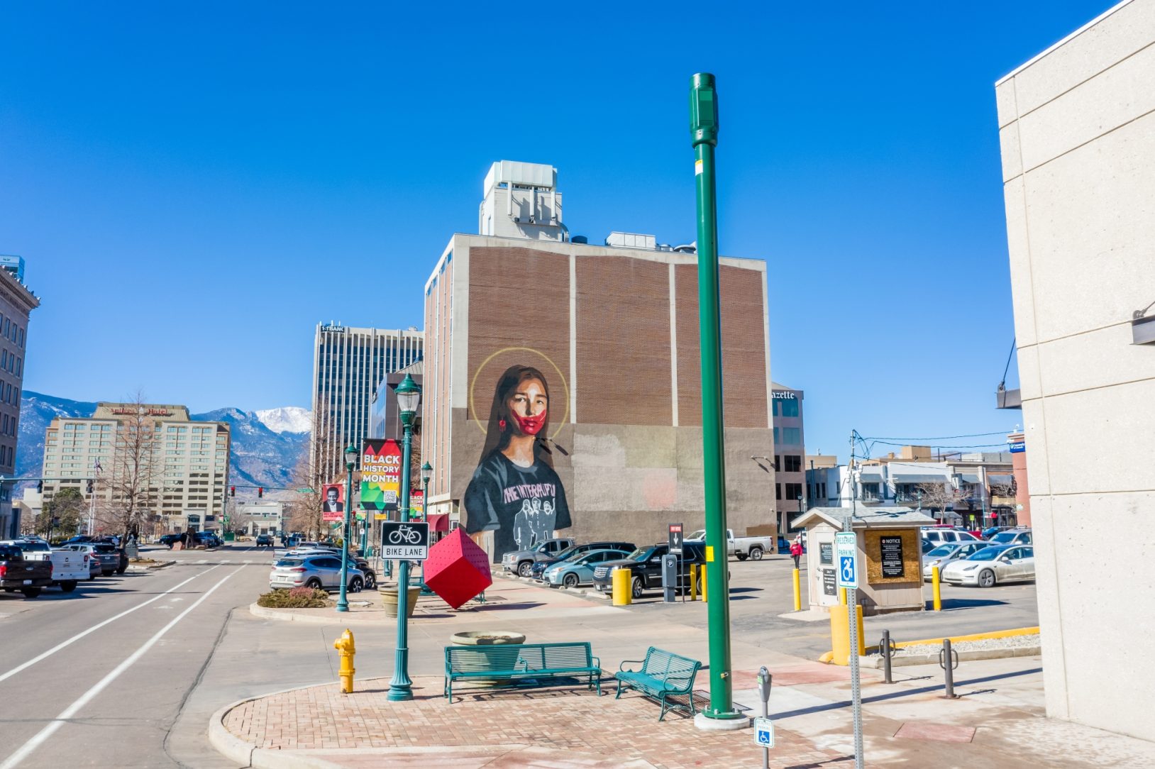

It comes as no surprise that these steel small-cell poles, laden with radio equipment are exposed to a diverse range of corrosive elements. These include the corrosive effects of ice-melt chemicals and road salts prevalent in the northern cities, pollutants in heavily industrialized areas, and the corrosive impact of saltwater along the coastal regions. ConcealFab utilizes hot-dip galvanizing (HDG) to provide decades of unmatched protection from corrosion in these highly corrosive environments. HDG produces a durable, cost effective, maintenance free, zinc and iron alloy coating over all steel surfaces (internal and external). The internal protection of HDG prevents the possibility of undetected internal corrosion taking hold within these hollow concealments.
The aesthetics requirements for these small-cell applications are stringent and ConcealFab worked closely with the galvanizer to incorporate specific design features for efficient processing and optimum coating results.
Once galvanized, the majority of poles are returned to ConcealFab for a secondary color coat, tailored to the specific requirements of each project. Applying a secondary coat over the galvanized protection is often referred to as a duplex system. The duplex coating advantage provides an additional synergistic benefit, that increases the combined life expectancies of both coatings by 1.5 – 2 times. In preparation for the duplex system, ConcealFab performs a light sweep blast over the external HDG coating to produce a roughened surface for anchoring the secondary coat.

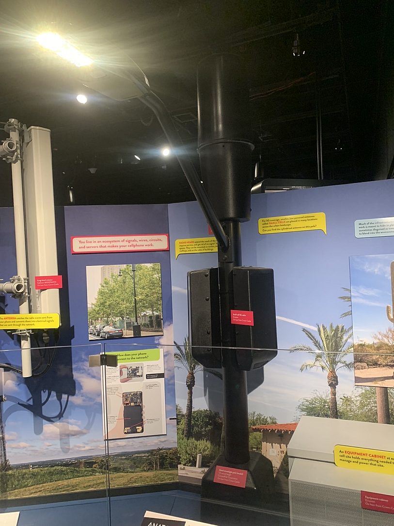

The significance of small-cell technology and concealments is widely recognized in today’s transformative era, symbolized by the inclusion of one of ConcealFab’s 5G poles now residing on display in the Smithsonian Institution’s esteemed collection.
