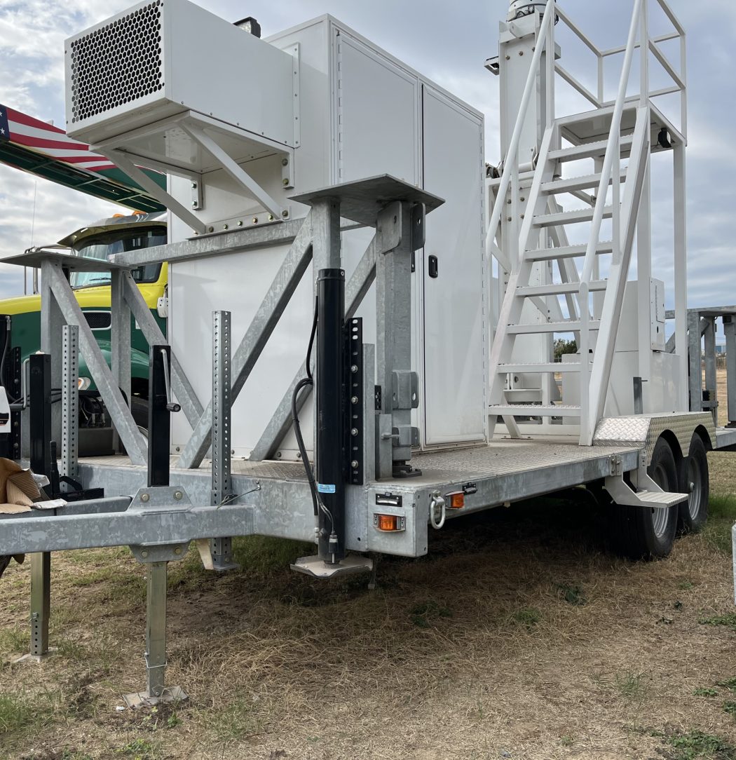

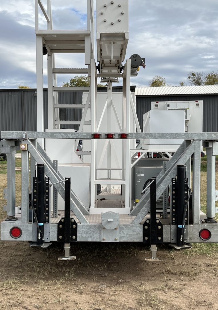

Durability is a standout feature of the Combat Training Communication Trailer, with hot-dip galvanized components ensuring long-lasting reliability in harsh environments. The trailer frame, along with smaller uprights on the frame and back of the trailer, undergoes a galvanizing process that immerses steel components in molten zinc. This creates a tough, corrosion-resistant coating that can withstand heavy loads, rough terrain, and prolonged exposure to the elements. Hot-dip galvanizing is especially suited for demanding applications like military training, offering superior protection against moisture, salt, and environmental wear. The intermetallic layers formed during the process safeguard structural components, ensuring that critical elements remain intact for years of use.
The galvanizer played a vital role in the trailer project, particularly in managing the challenges of a mostly tubular frame that required numerous holes for proper venting and draining. They reviewed and marked the appropriate hole sizes and locations on the design drawings, which Rolltechs then incorporated into their AutoCAD files. This ensured the fabrication shop could consistently produce frames with the necessary vent and drain holes for every unit, streamlining production and maintaining quality standards. The galvanizer then helped the customer source plugs for the holes to provide a finished look on the frames.

The galvanized components of this are the trailer frame as well as some of the smaller uprights on the frame and back of the trailer.
