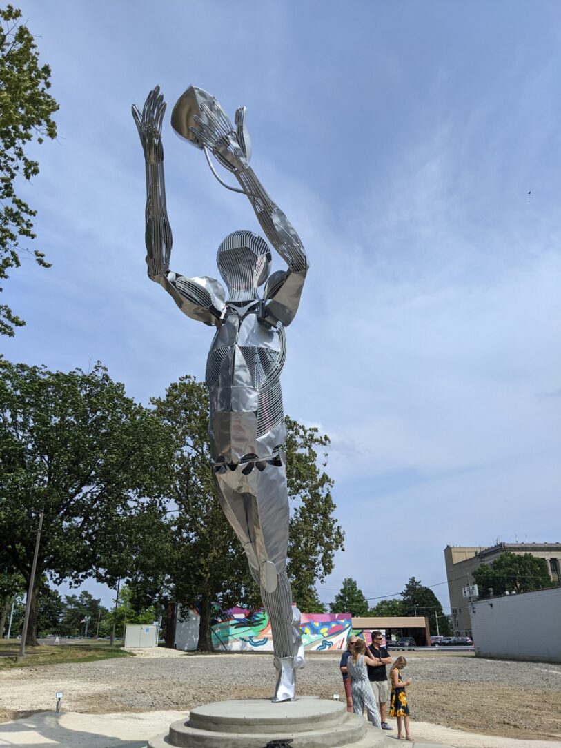

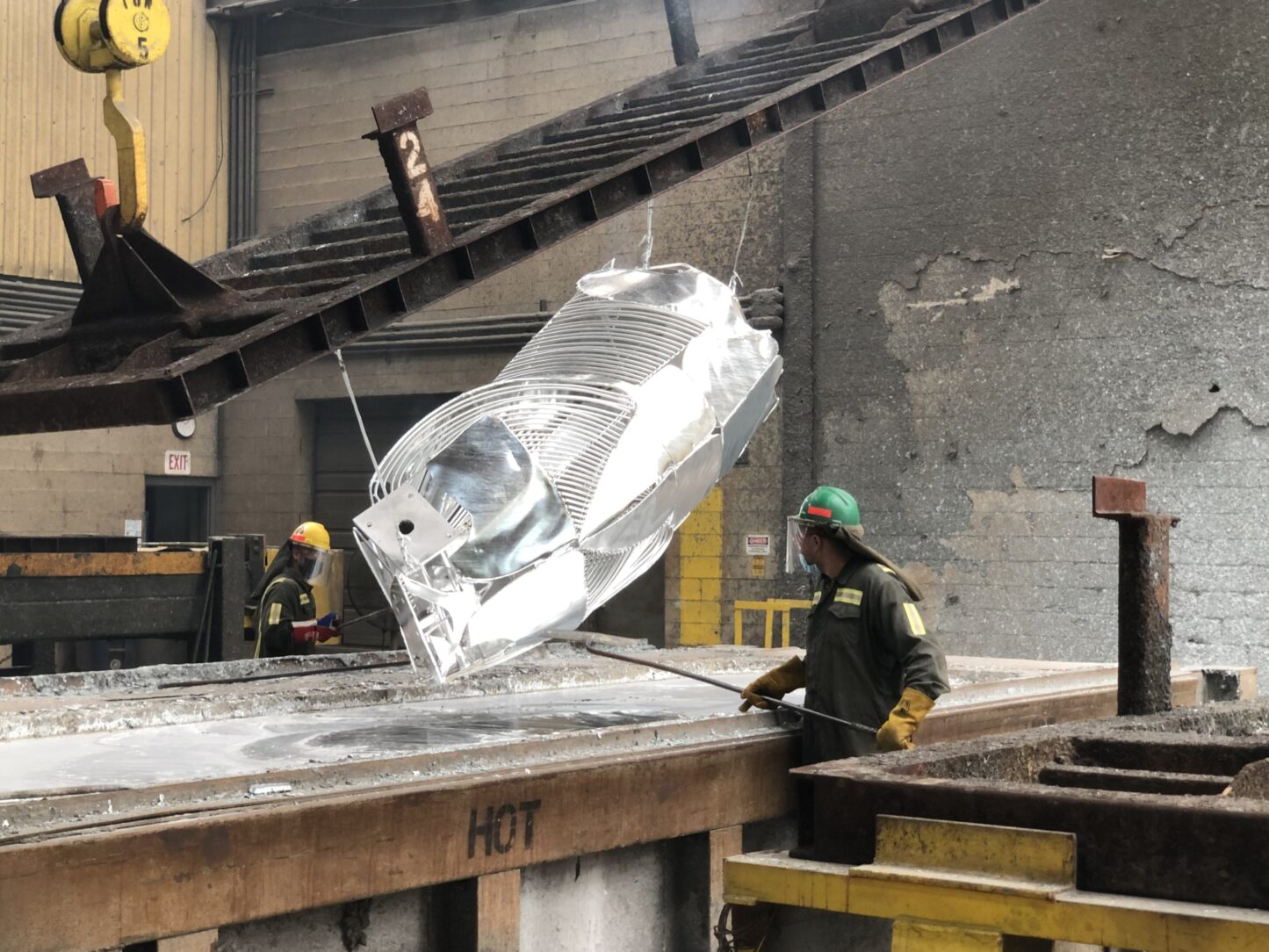

The statue is 32’ high and consist of 6 separate pieces designed to fit in the artists local galvanizing kettle. Each section was made specifically for the hot-dip galvanizing process. Keeping in mind the size, distortion potential, venting and draining all for an outstanding finish. Jack Howard-Potter was in contact with the galvanizer throughout the design and fabrication of each section. The galvanizer has been working with Jack Howard-Potter for years and he loves the look, durability and corrosion performance of hot-dip galvanizing. The strong relationship has allowed the artist to push the boundaries between art and the durable zinc coating process.
