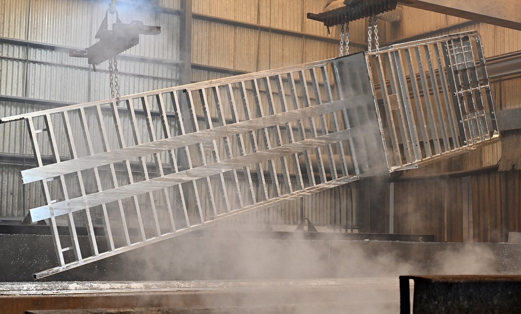

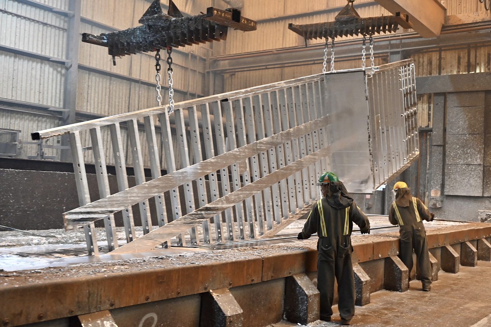

Evolve is innovating for the future with their transport lines. Meeting with the galvanizer started at Evolve in Painesville, Ohio with their Operations Manager and VP of Operations to discuss their need to increase the overall durability of their transporters. Galvanizing the trailer was the obvious choice moving forward.
Based on the original length of the trailer, the Operations Manager for the galvanizer suggested manufacturing the new design into three sections. Proper draining and ventilation were discussed and approved to hot-dip galvanize the trailer frame safely and efficiently. By breaking this unit into three sections it allowed for the sections to be a single dip scenario, which was more cost effective.
The next step involved Evolves Operation Manager to visit the galvanizer to see the trailer parts being galvanized. Once dipped and inspected, it was given the thumbs up moving forward. A final meeting back at Evolve and then everything moved forward with galvanizing their first trailer. since the first trailer was galvanized, another 4 transporters have been delivered and galvanized. Evolve is now following their history of being innovative by hot-dip galvanizing their transporters which provides coating durability, corrosion performance and sustainability for many years to come.
