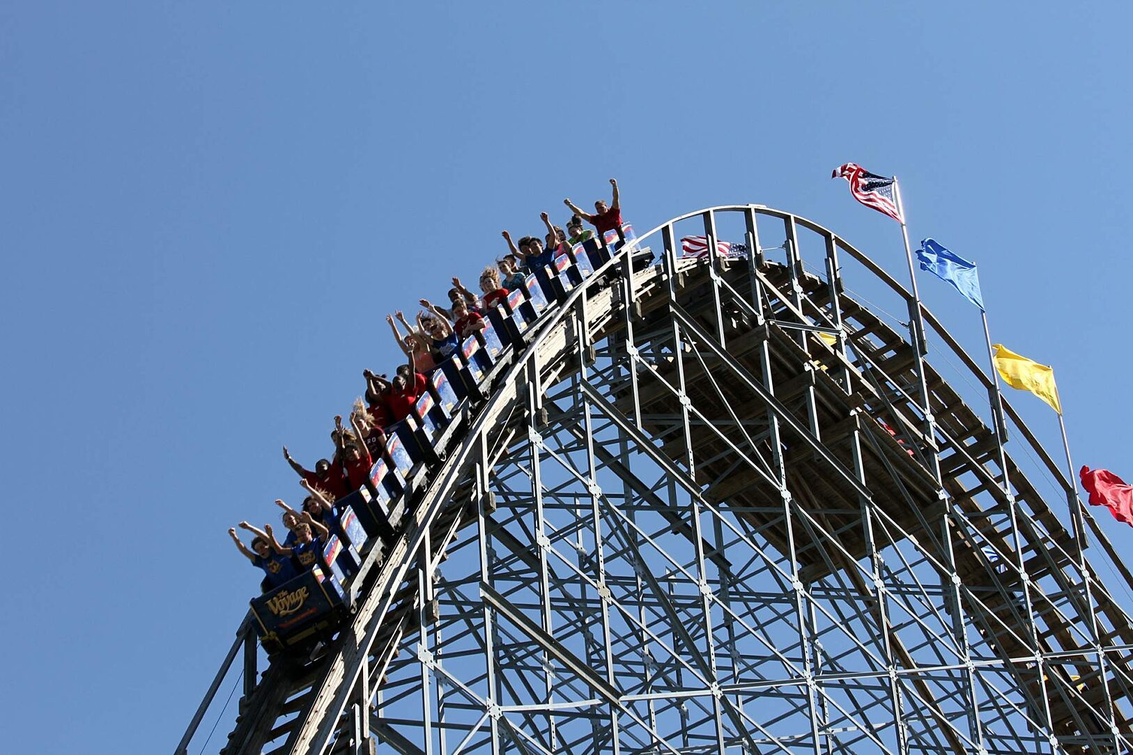

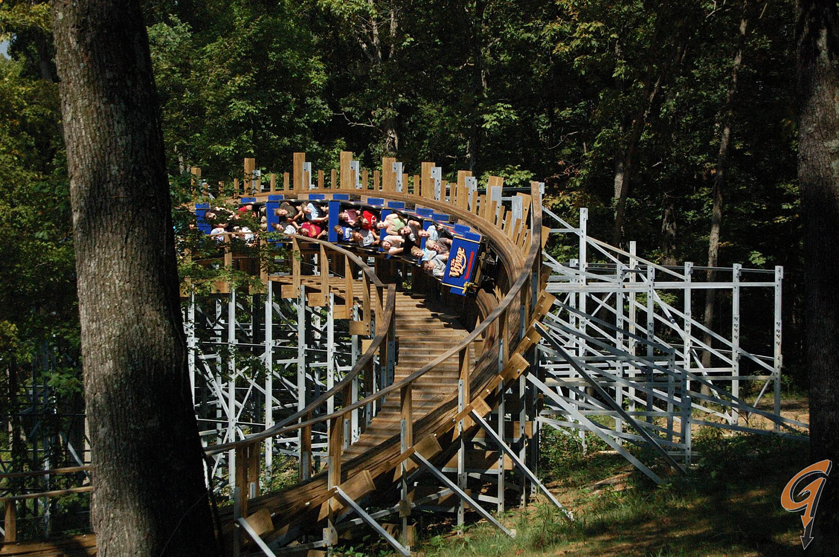

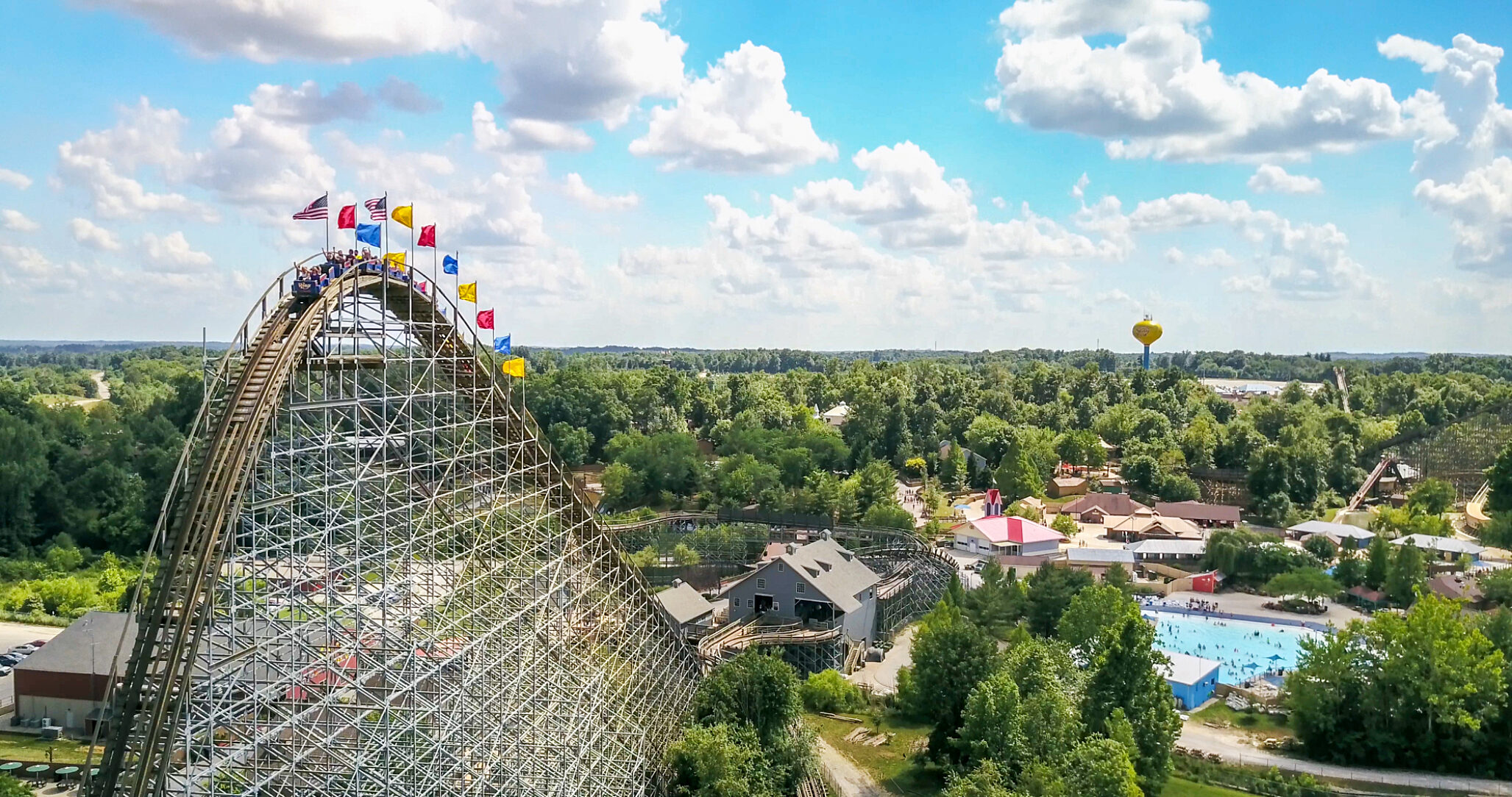

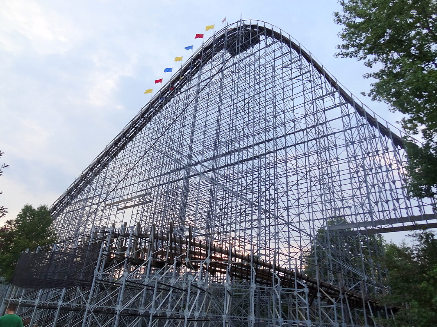

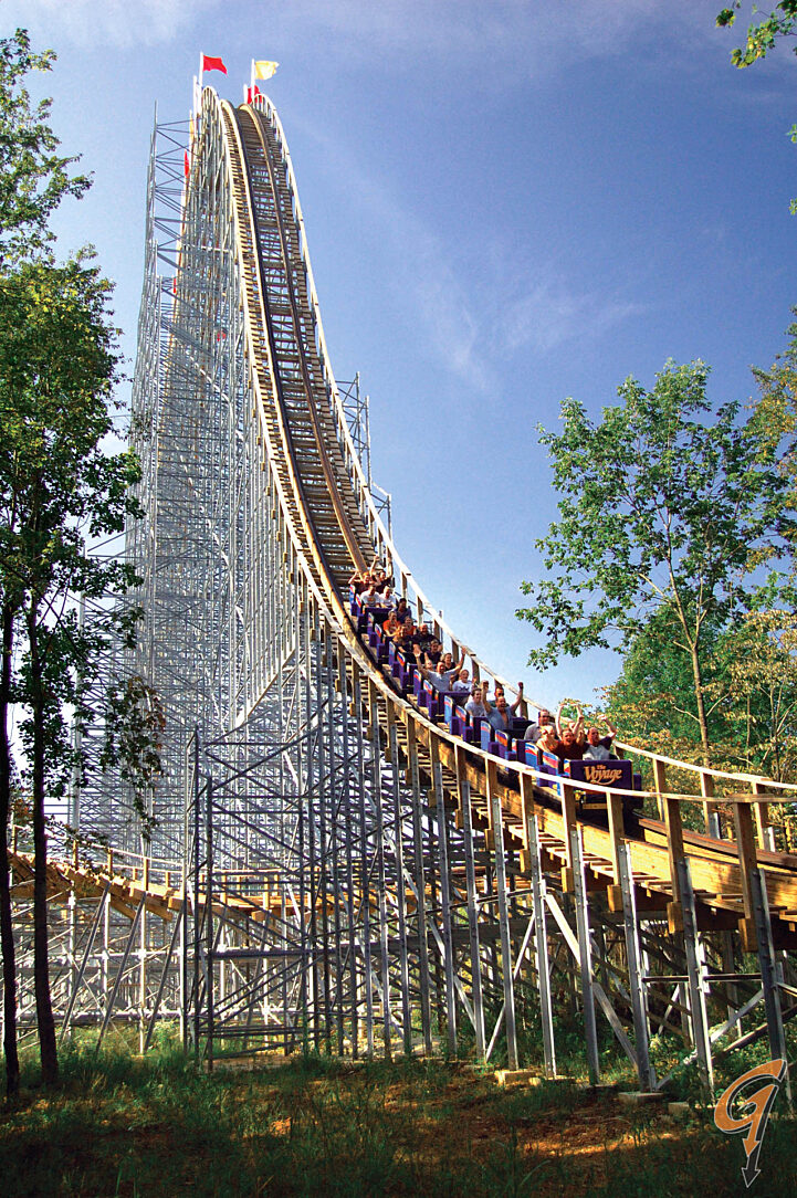

When Holiday World was building The Voyage, which has over 6,400 feet of track, they desired the classic look of a wooden roller coaster without the time-consuming, costly maintenance. So, rather than use wooden frames to support the track, they used galvanized structural steel. The galvanized steel will provide a durable and corrosion-free ride, without the logistical nightmare of maintenance painting or the safety hazard of loose bolts. Choosing to galvanize the structural support of The Voyages track will ensure Holiday World will have a cost effective, maintenance-free roller coaster to wow thrill seekers well into the future.
New wooden coasters are relatively rare these days, as park owners opt for steel-rail designs that are generally faster and higher (and less expensive to maintain) and have more queasiness-producing features like barrel rolls and corkscrew loops. When building The Voyage a considerable amount of time was spent discussing both initial cost and long term maintenance costs. When it came to the steel structure that supports the wooden coaster, the decision to hot-dip galvanize the steel helped to solve both challenges. We were able to provide a low cost coating system on the steel that has not required any maintenance costs since the day the coaster opened. Safety of the rider is number one when building a coaster. Corrosion is one of the top threats to steel on any coaster. The design team was able to provide the park's owners a relatively corrosion free steel solution with hot-dip galvanizing.
