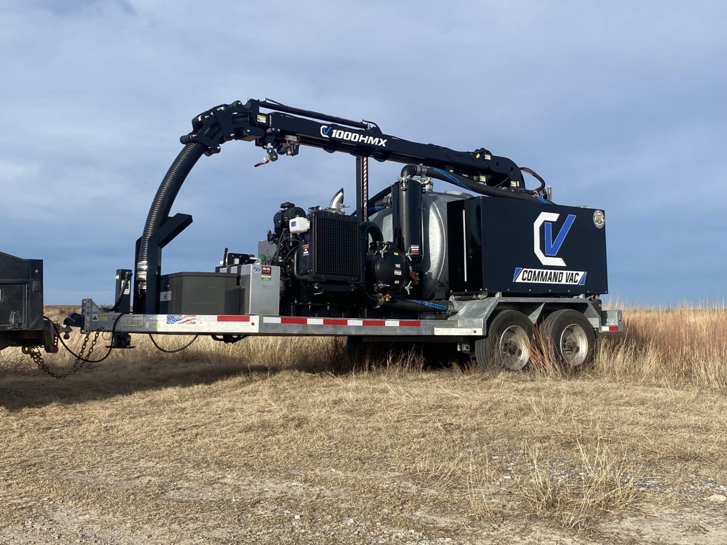

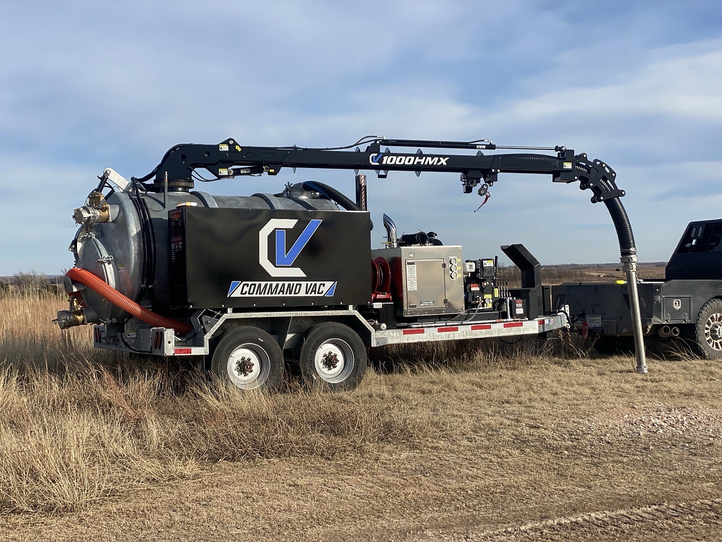

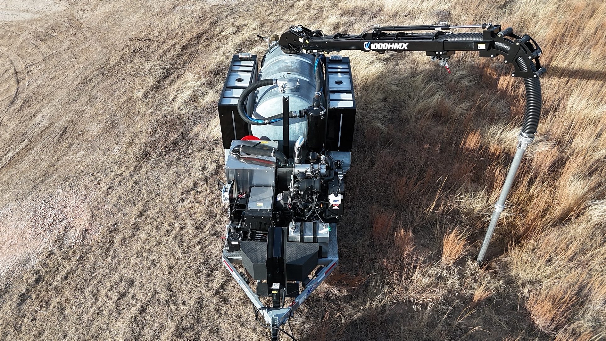

White’s latest offering is something familiar but unique, intuitive, & practical. Meet the Command Vac CV1000 Vacuum Excavator. This Clydesdale of a hydrovac trailer sports impressive capabilities advantageous to multiple sectors. Weighing in at 8,500 pounds with a 70-horsepower water-cooled diesel engine, a 4,000 PSI adjustable high-pressure wash pump, a 1,000 CFM vacuum system, a 270-degree rotating boom that extends up to 18 feet, and a 1,000-gallon tank, this robust and dynamic piece of equipment is built to do it all—and, more importantly, to last.

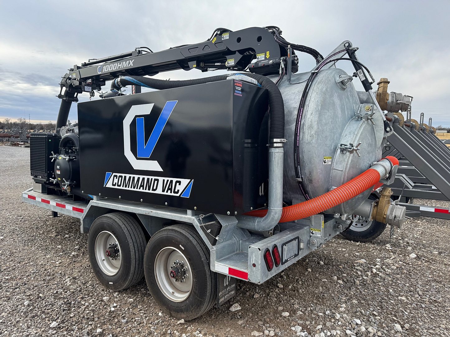

The X-factor of this iteration of the Command Vac is its impressive new finish, offering vitality, durability, and, most importantly, long-lasting corrosion-resistant zinc protection. “We over-engineer and over-build everything we do,” says Russell Thompson, lead design engineer. “Getting these trailer frames and tanks galvanized was just a natural progression of that philosophy. Nobody here wants our equipment to fail in the field at any time.” And that’s what makes White’s Welding’s approach different.

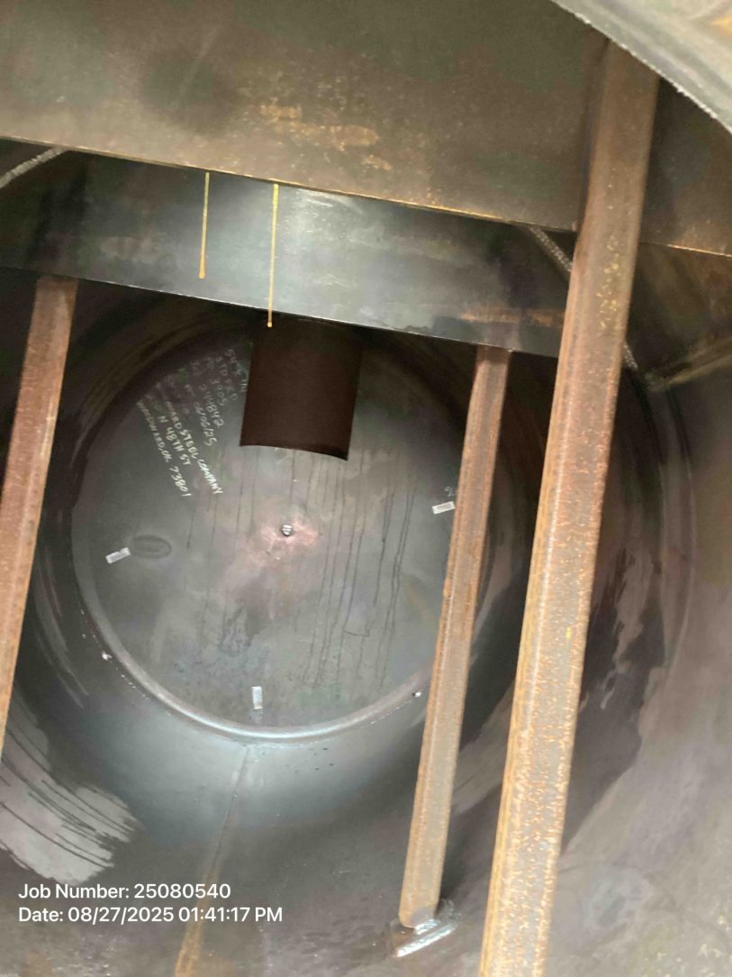

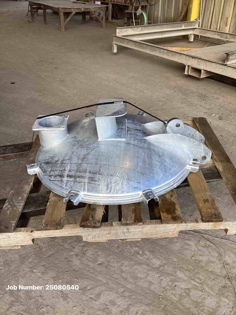

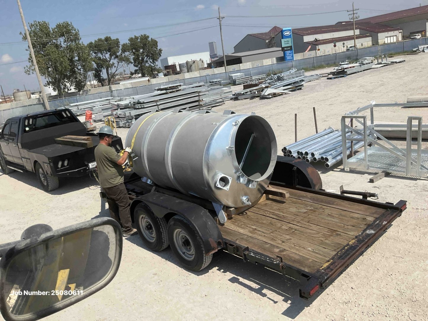

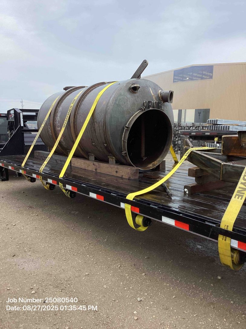

Galvanizing tanks can be challenging due to their large cavity and their capacity to hold zinc upon withdrawal from the kettle. Critical design discussions ensured the tank and trailer components were galvanizer-friendly, coated appropriately per ASTM A123, and finished to the highest quality. After the coating was completed, the pieces were delivered back to White’s facility in Woodward for final assembly and installation of electrical components and equipment, all in preparation for the trailer’s debut at the North American Trailer Dealers Association Trade Show in October 2025.
