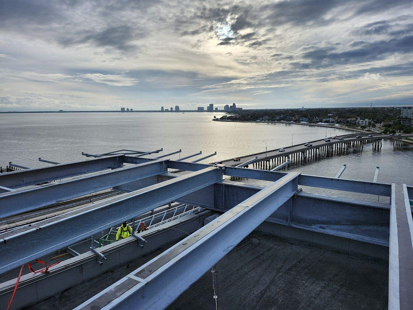

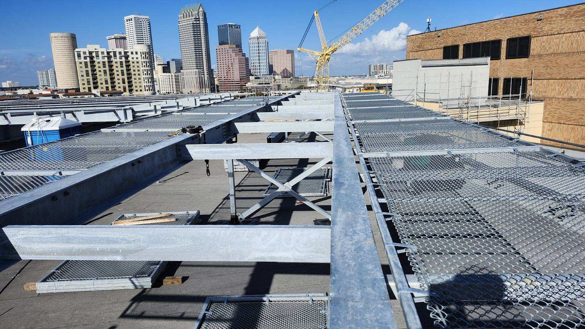

In response to these challenges, Tampa General Hospital made the decision to upgrade its helipad, which had originally been situated at ground level, adjacent to Tampa Bay. The saltwater spray and rotor wash from the Aeromed emergency helicopters intensified corrosion, and the area’s vulnerability to tropical storms and hurricanes only added to the strain. Moving the helipad to the hospital’s rooftop was the most practical solution, as it not only mitigated these environmental hazards but also provided better access for emergency air transport.

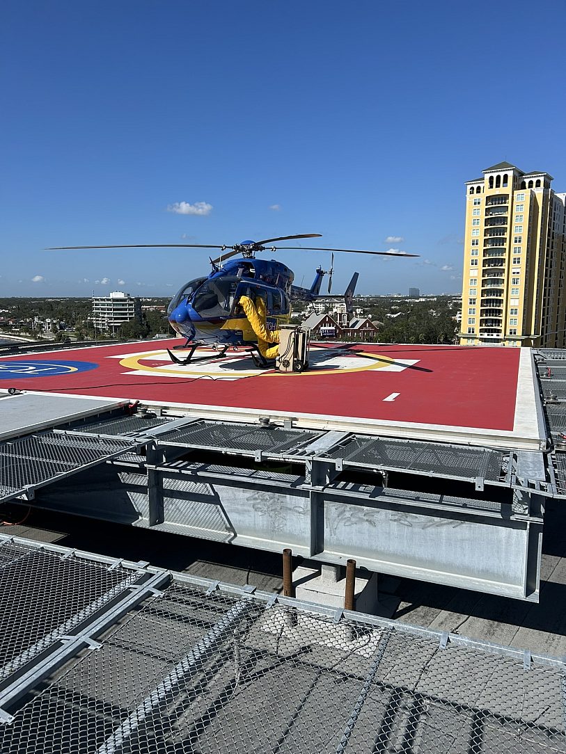

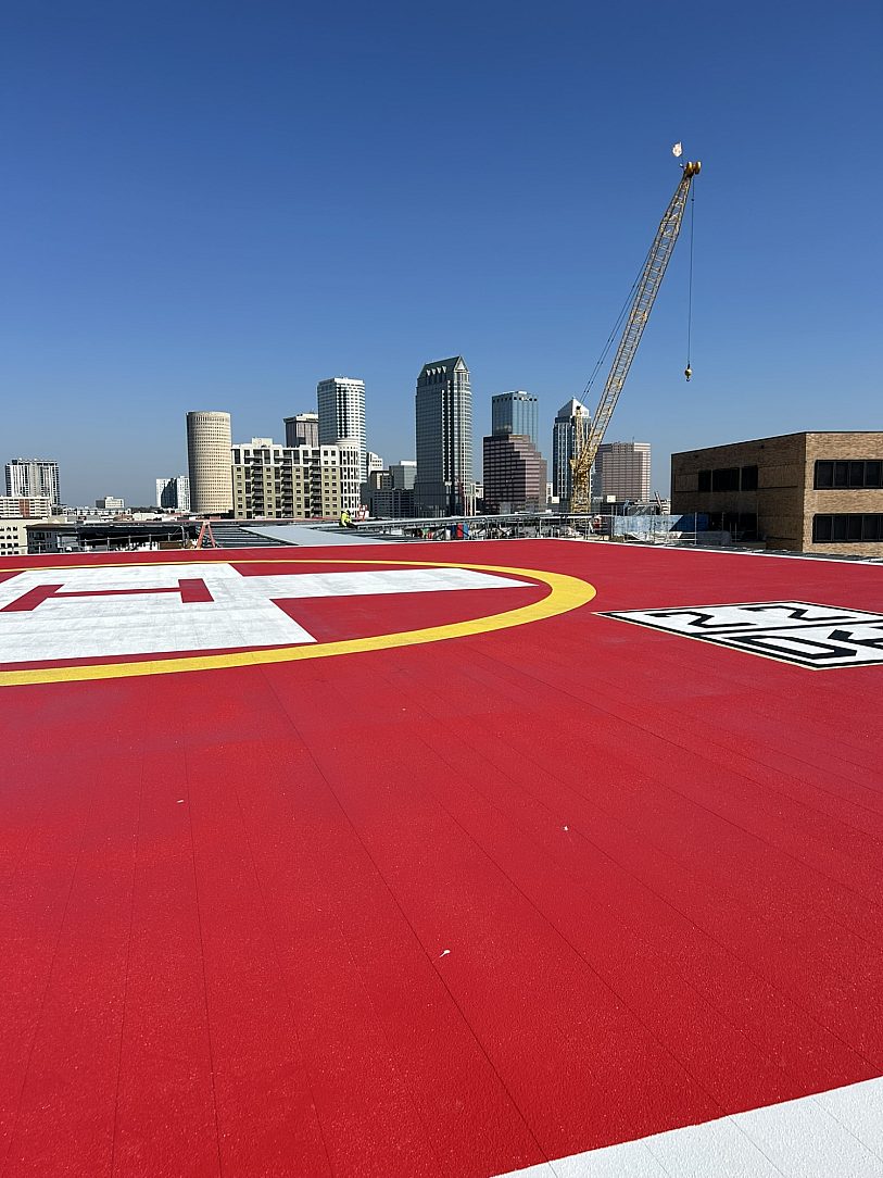

To handle this complex upgrade, Tampa General Hospital partnered with FEC Heliports, an industry leader known for its expertise in designing and constructing custom helipads. FEC Heliports, based in Cincinnati, Ohio, has decades of experience creating rooftop, ground-level, and offshore helipads worldwide. They provided a custom solution that included two landing pads, one of which was specifically designed to accommodate the U.S. Coast Guard’s large, heavy Jayhawk rescue helicopter. This dual-pad setup gives the hospital the flexibility to accommodate a range of emergency operations while ensuring operational resilience.

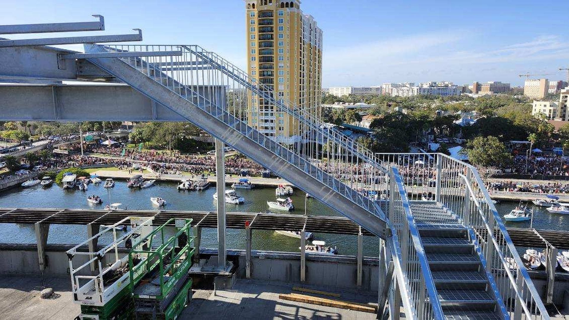

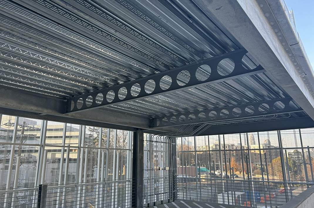

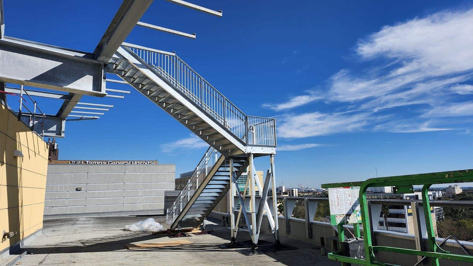

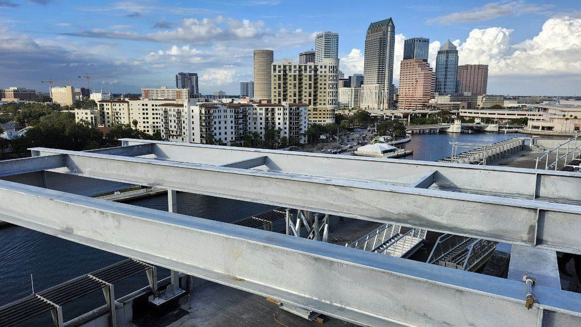

In terms of materials, FEC Heliports chose hot-dip galvanized steel for the construction of the helipad. This decision was driven by the need for a corrosion-resistant material that could withstand the harsh marine environment. Hot-dip galvanizing involves dipping steel into molten zinc, forming a tough zinc-iron alloy coating that protects the steel from corrosion and enhances its durability. This coating process ensures the helipad’s structural integrity against saltwater exposure, storm surges, and the abrasions caused by helicopter rotor wash.
The steel structure of the helipad weighs 122 tons and features a coating that averages 11.4 mils in thickness. With an expected lifespan of well over 100 years, this design not only ensures minimal maintenance but also offers significant sustainability benefits. After a century, it is projected that 95% of the helipad’s zinc coating will remain intact, providing long-term protection for the infrastructure.
