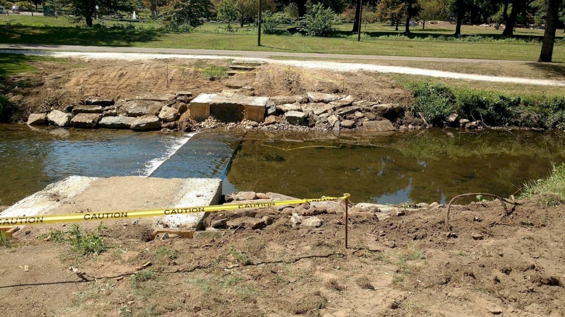

Located in Stadium Park, the Herb Fisher Walking Track is a two mile trail which functions as Canton's most popular exercise and recreational element. Approximately six years ago, a bridge that crossed the West Branch of Nimishillen Creek and was a half way point was destroyed by a 100 year flood. This bridge was a critical link in allowing community patrons to participate in exercise and recreation while cutting the overall distance to one mile. The bridge was also a key link to parking, restroom facilities, and a direct connection to the John Barker Spring House.

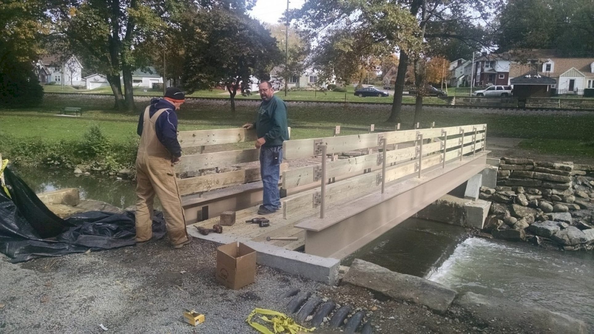

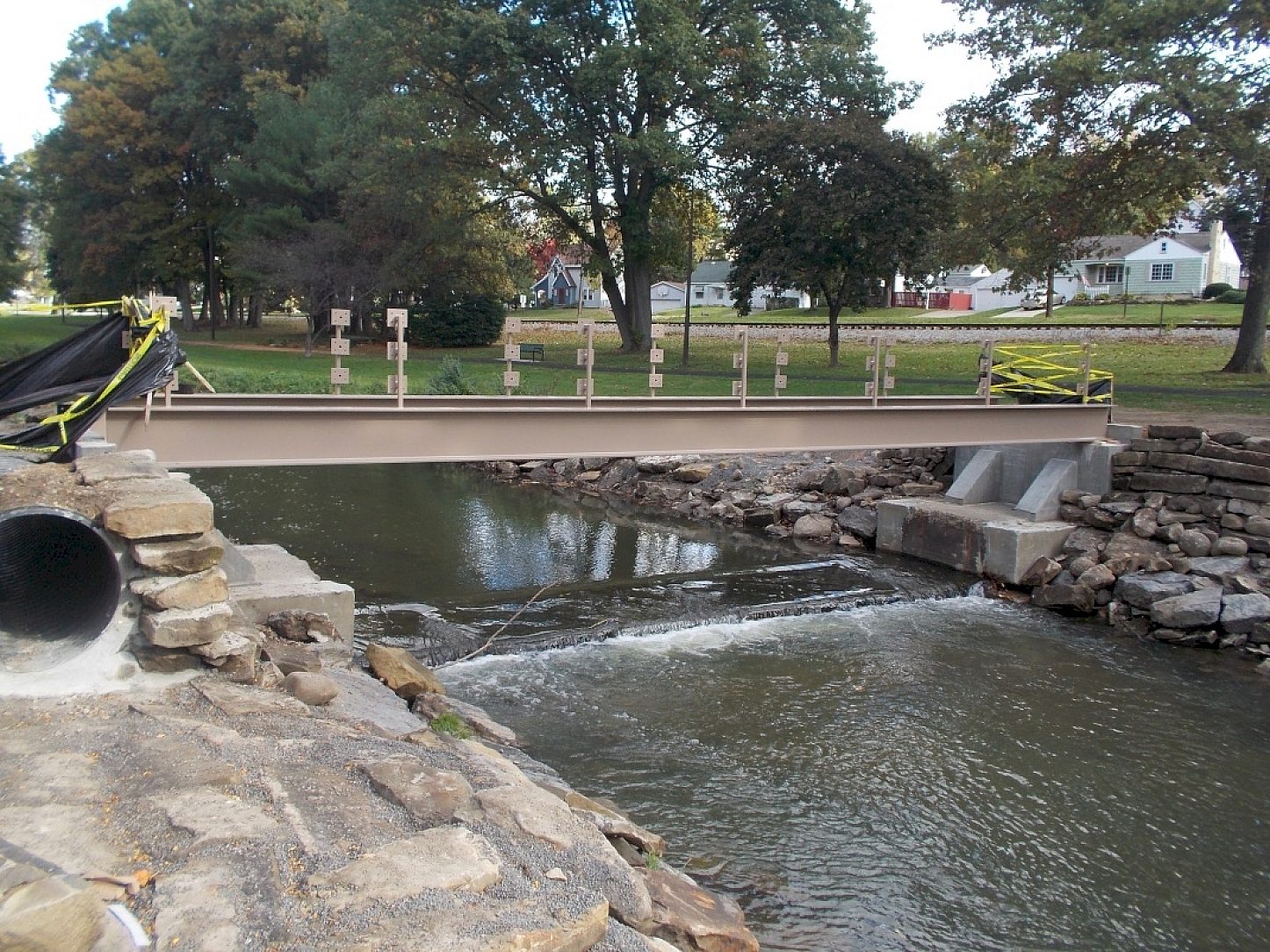

The replacement bridge needed to be built from more durable materials than the old wooden structure and designed to require minimal maintenance. A simple steel beam bridge was designed to fit into the nature friendly park environment. Canton Parks and Recreation had previous positive experience with hot dip galvanized projects and wanted the new bridge's steel components to have long term corrosion protection afforded by hot dip galvanizing. All steel components utilized in the construction of the bridge were hot dip galvanized.
Powder coating over the hot dip galvanized steel provided the opportunity to choose a color scheme conducive to blending the bridge into the park environment. Additionally, the synergistic effect of the powder coating over the hot dip galvanizing will extend the corrosion protection at least one and a half times the expected life of the galvanizing alone.

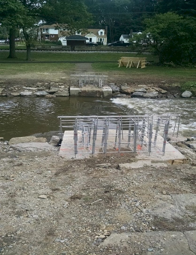

Reinforcing bar in bridge abutments, Main bridge beams, Railing mounting posts attached to main beams, Sole plates ( bearing plates), and Masonry Plates( bearing plates).
