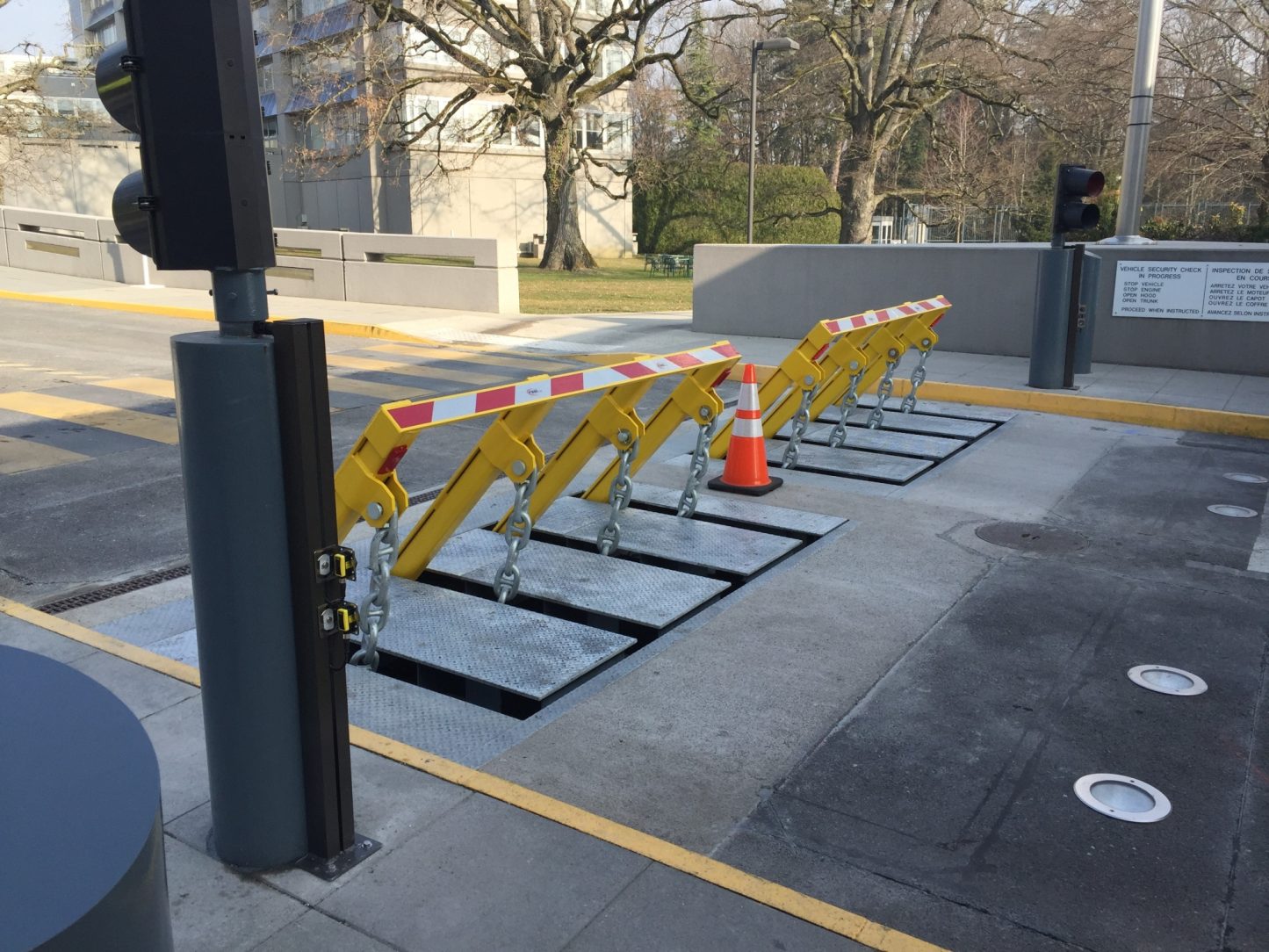

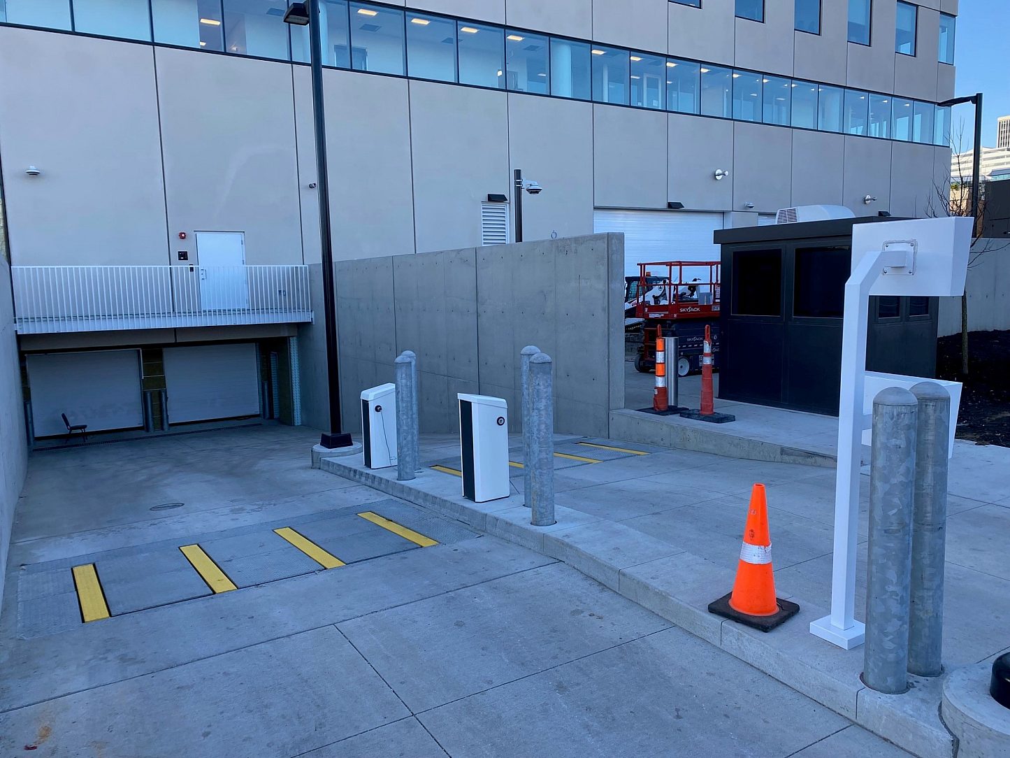

In October of 2023, the RSS-2000 wedge barrier was placed outside of the Des Moines Federal Courthouse. Operated by the judiciary staff as well as the US Marshals service, the barriers can be viewed by pedestrian and vehicular traffic as they do face the adjacent roadway to prevent incidental or attempted intentional forced entry to the protected area.
In the "UP" position, the barrier presents a visible obstacle to approaching vehicles capable of stopping and destroying heavily loaded trucks moving at high speeds. Red strobe lights on the posts flash to provide caution when the barriers are deployed. Upon impact, forces are transferred though the posts into the foundation. In the "DOWN" position, the barrier is completely flush with the roadway and will not damage tires, snowplows, sweeping machines, etc. A servo electromechanical actuator operates the barrier.
