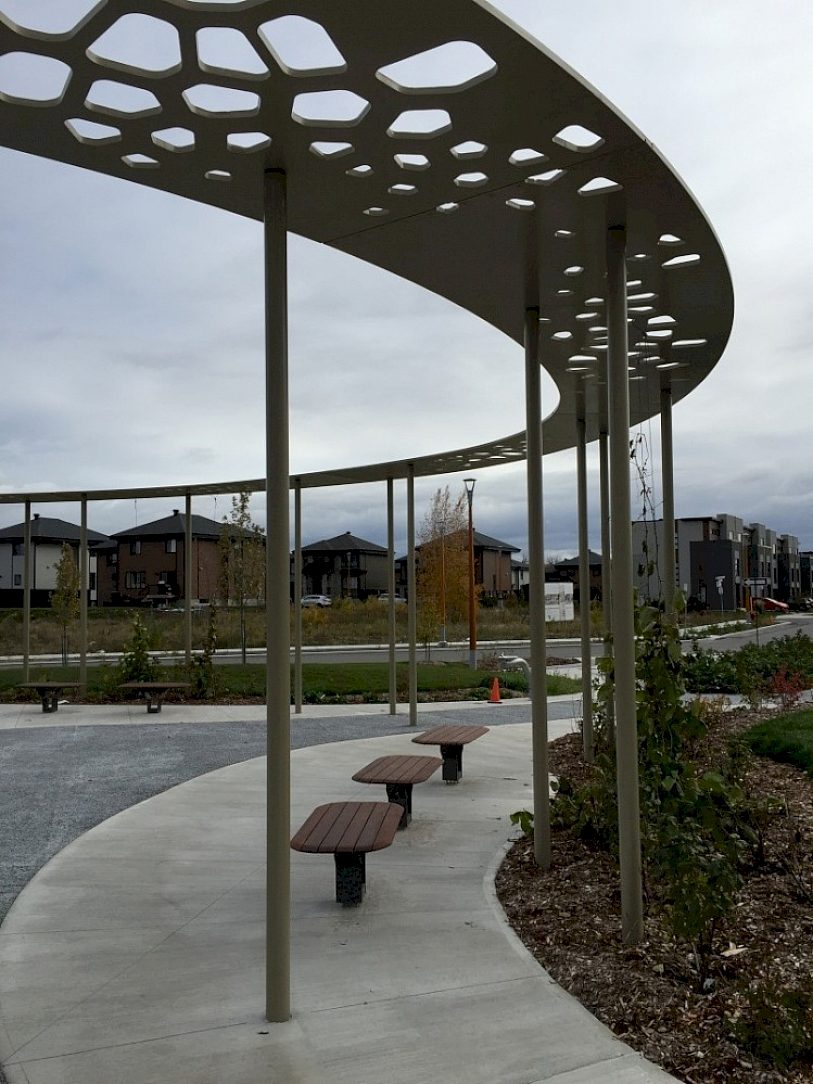

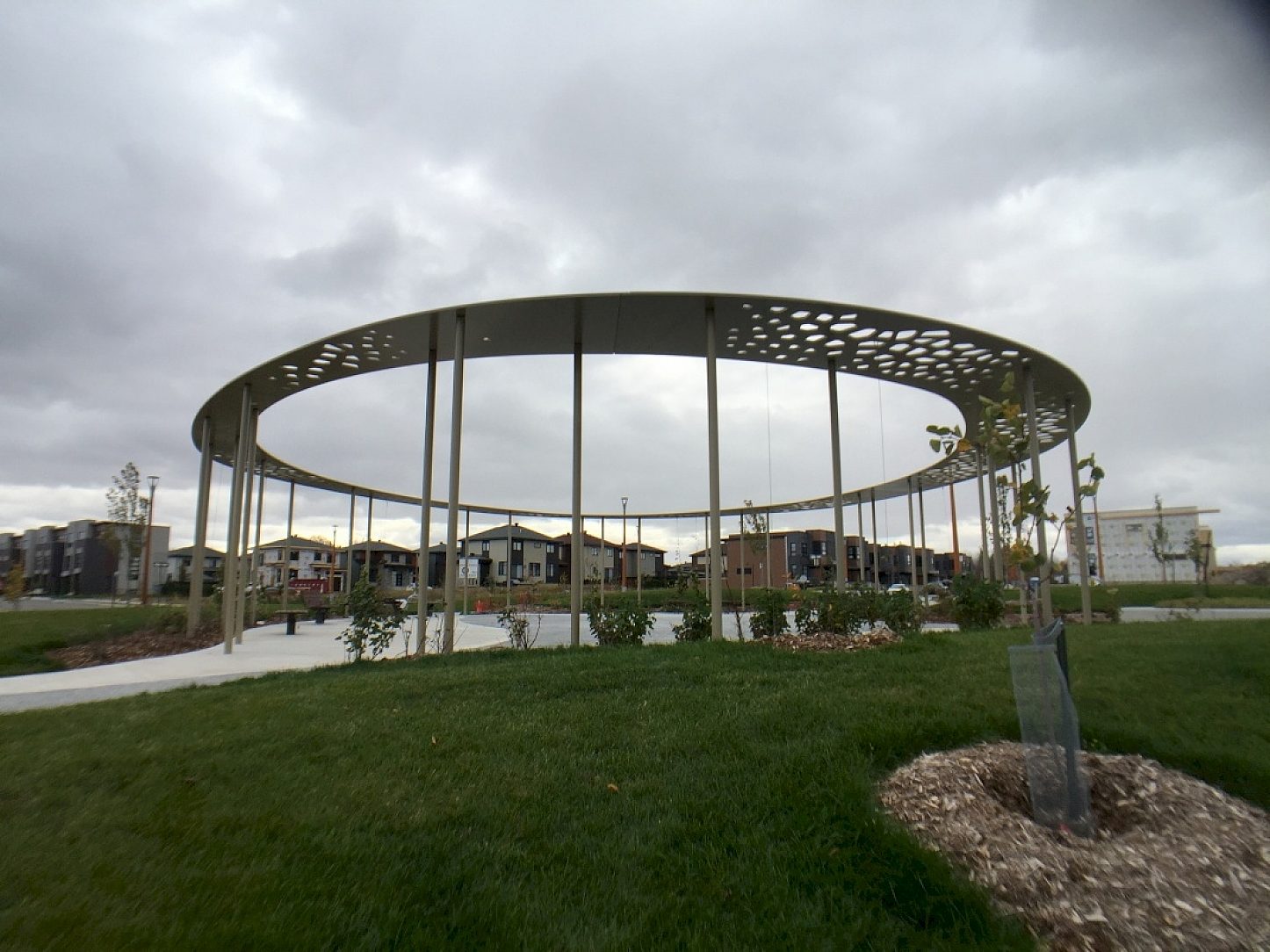

When the City leaders of Terrebonne (whose name literally means good earth) approved the development of Alta Vista, a cutting edge Eco-responsible neighborhood, they understood that some kind of symbolic representation of their vision for this new living area was needed.
Part of eco-responsibility is sustainability and hot-dip galvanizing fit in beautifully with naturally occurring zinc assuring a long service life especially with a duplex paint system bringing even greater durability.

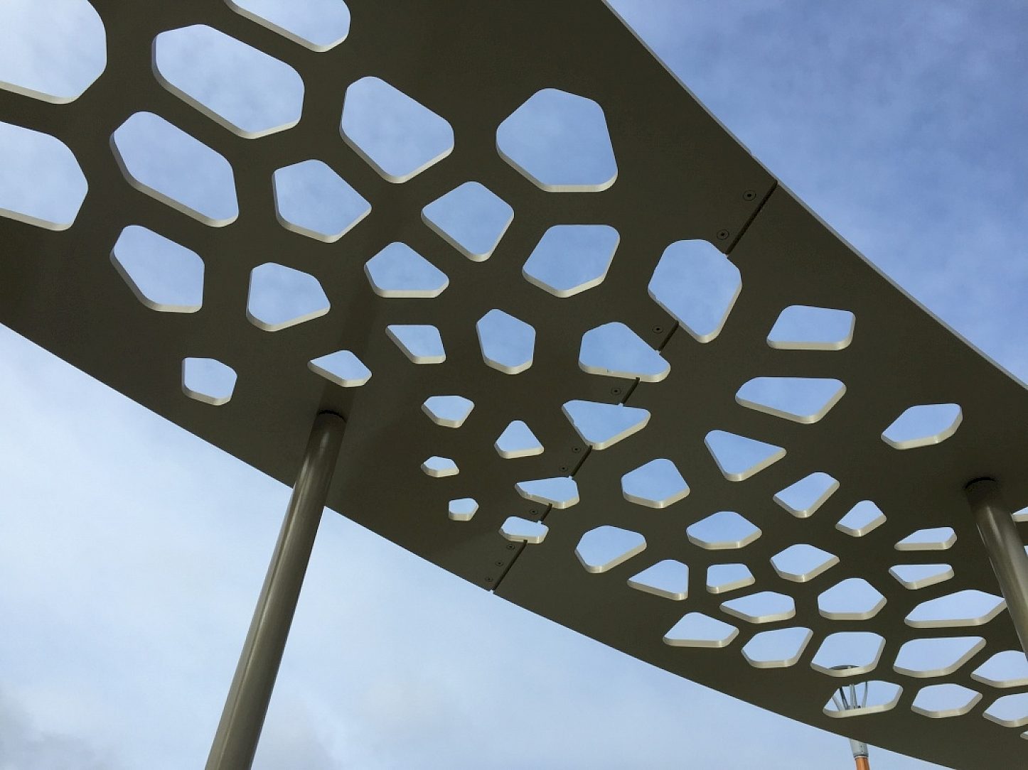

Since the ecological advances in this new development were a melding of basic biological understanding and high technology they decided upon a ring pergola with a Voronoi distribution design. A Voronoi diagram is a distribution of space between randomly positioned points where the perimeters are the equidistance between the points. While Voroni diagrams are used for various purposes such as urban planning and medical research in this case they represent organic cellular distribution as seen in diverse organisms such as the wing of an insect or the leaf of a tree.

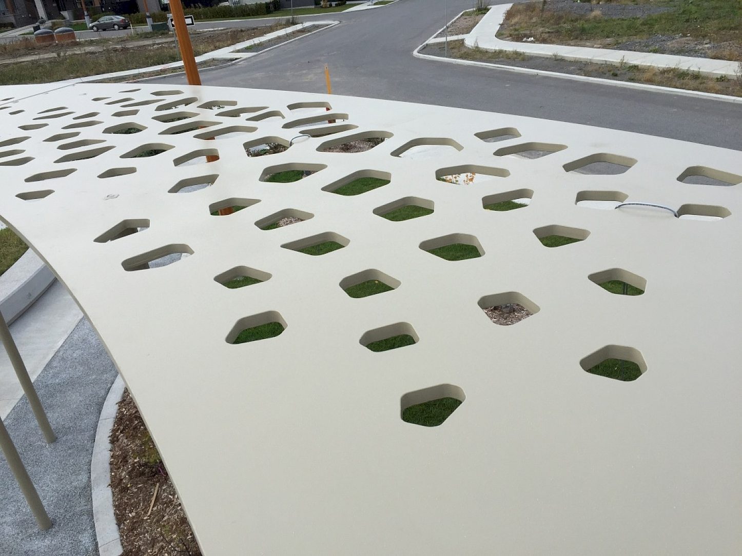

Part of eco-responsibility is sustainability and hot-dip galvanizing fit in beautifully with naturally occurring zinc assuring a long service life especially with a duplex paint system bringing even greater durability. The lithe looking structure has no welding, only precision plaza cutting was used and very high quality galvanizing was required to insure that the precision fit components would assemble on site effortlessly. The minimalist ring itself has 17% open area which was the precise amount required to reduce weight to the safe loading level of those thin columns while still leaving sufficient material to prevent any deflection of the ring from snow or ice load.
