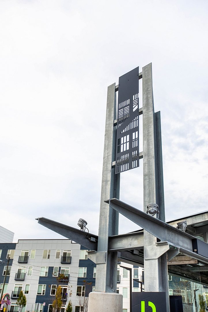

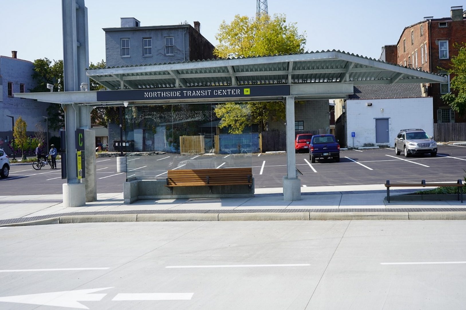

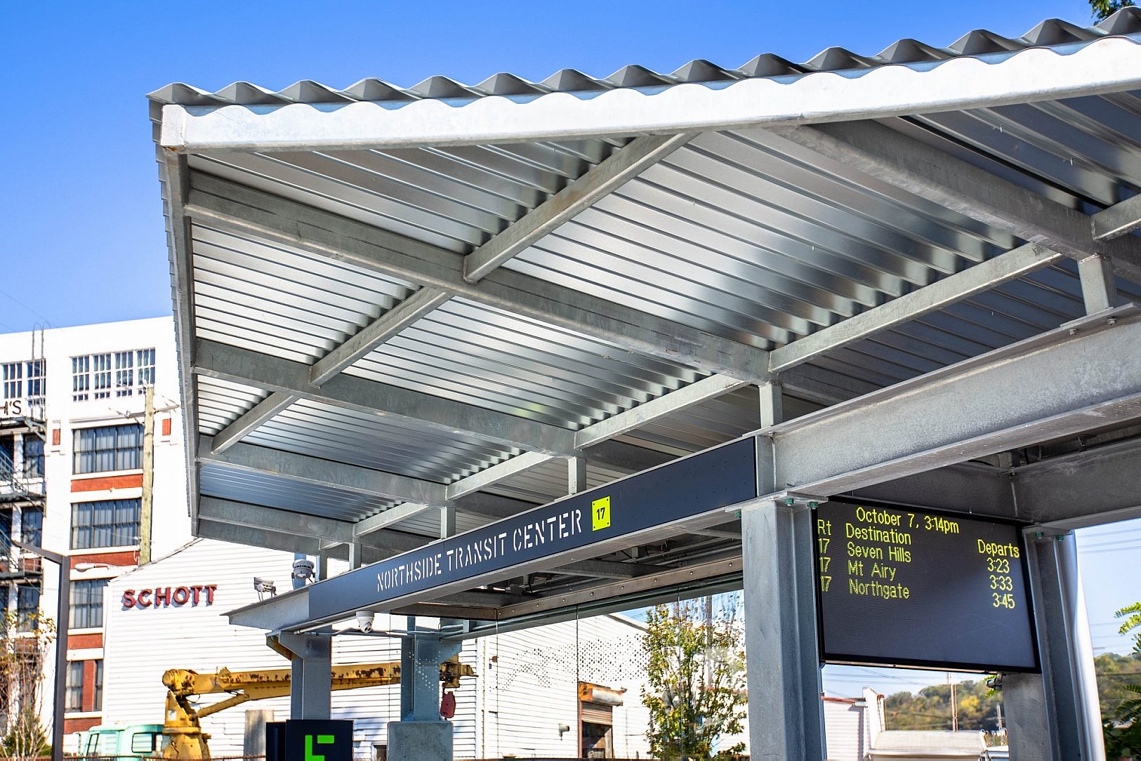

The fabricator and the galvanizer worked closely together to meet the deadlines for galvanizing and the installation for the October opening. Both initial appearance and long-term aesthetics were a major part of the early conversations with the design team and the fabricator. The fabricator relayed the concerns to the galvanizer prior to fabrication of the steel. The galvanizer was able to assist and educate both the design team and the fabricator of optimal design and fabrication for galvanizing. This included proper venting and draining, steel chemistry selection and weld wire selection.
Ultimately the appearance concerns were eased, and galvanizing was selected over paint due to life-cycle cost, coating durability and corrosion protection. This high traffic area will serve the area’s residents for many years to come thanks in part to the durability and protection of hot-dip galvanizing.
