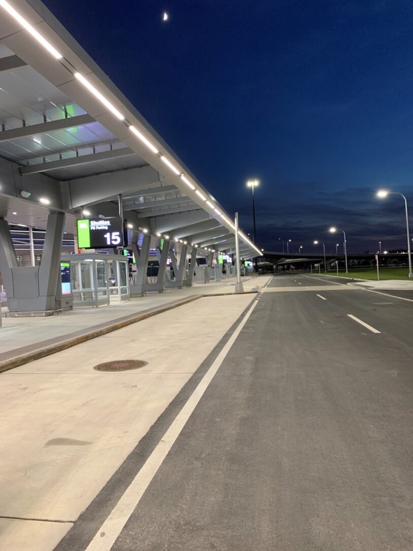

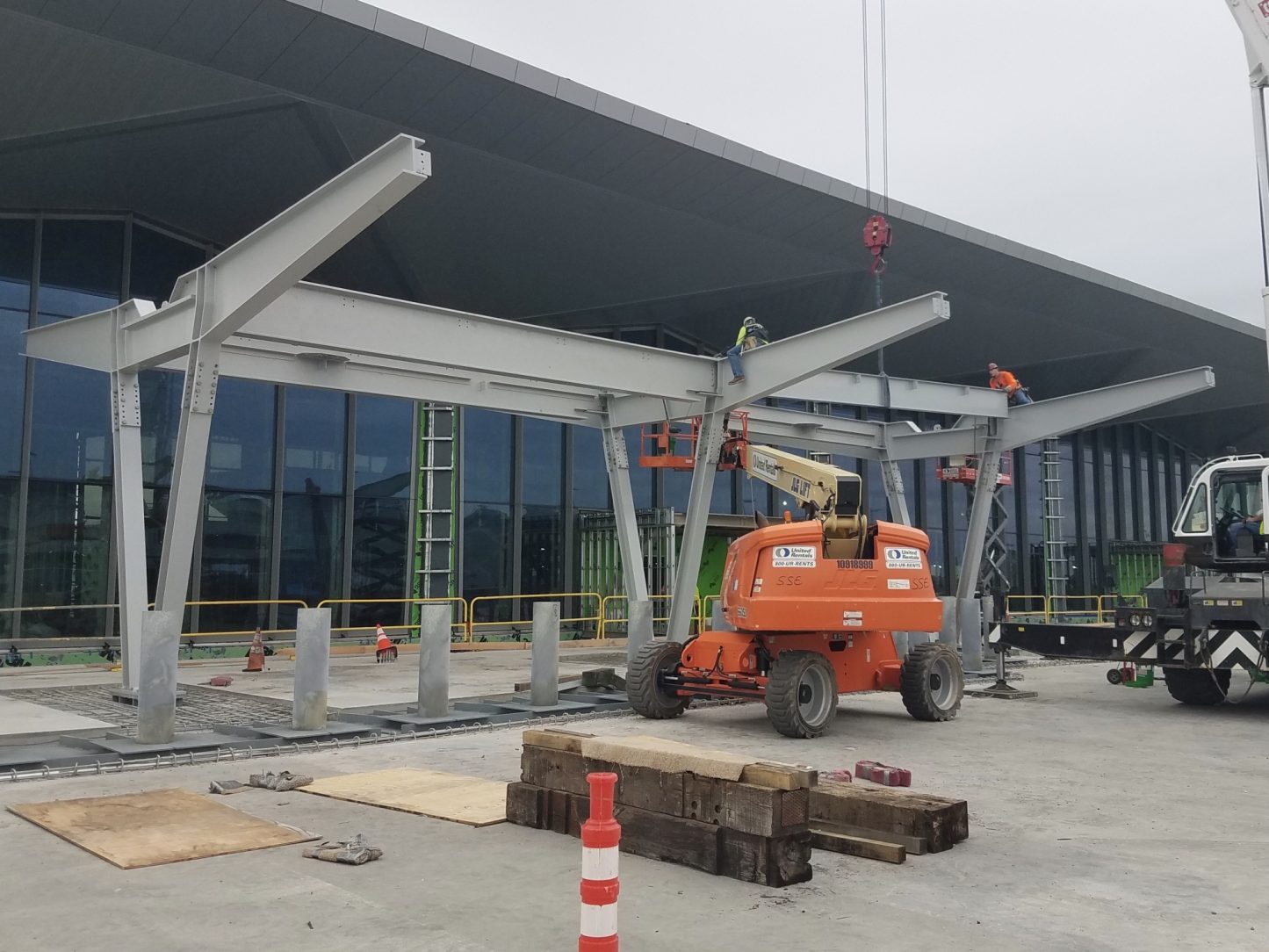

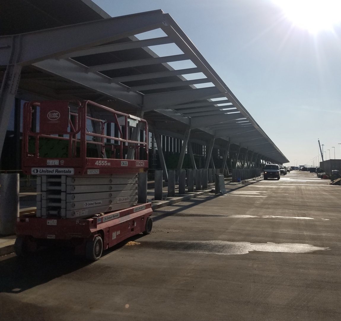

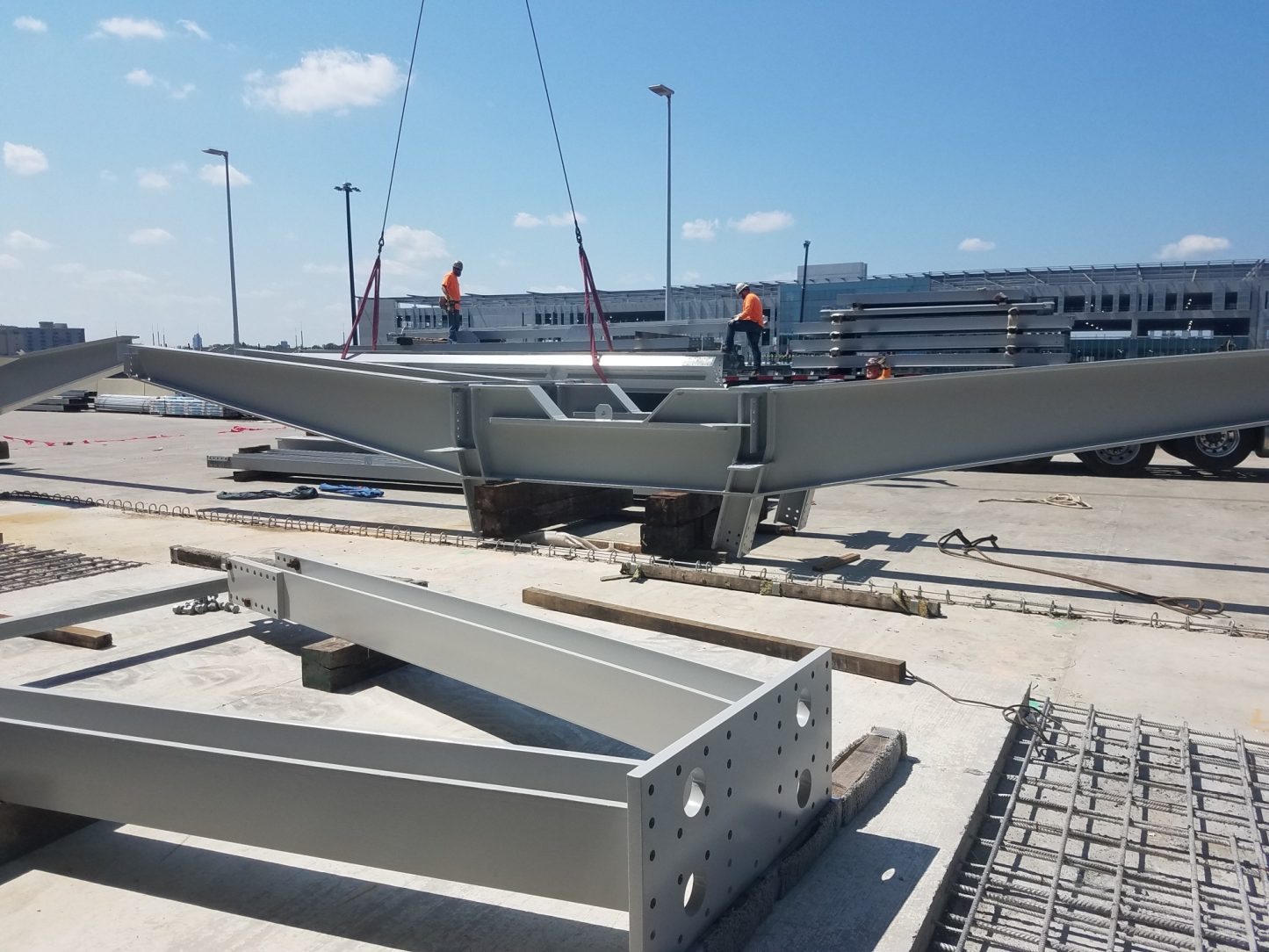

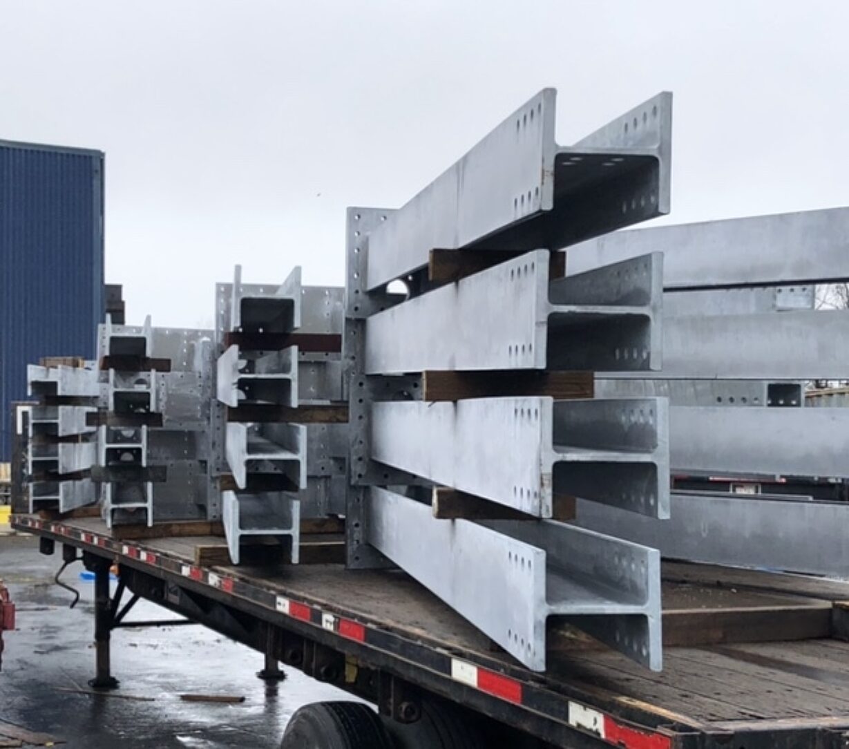

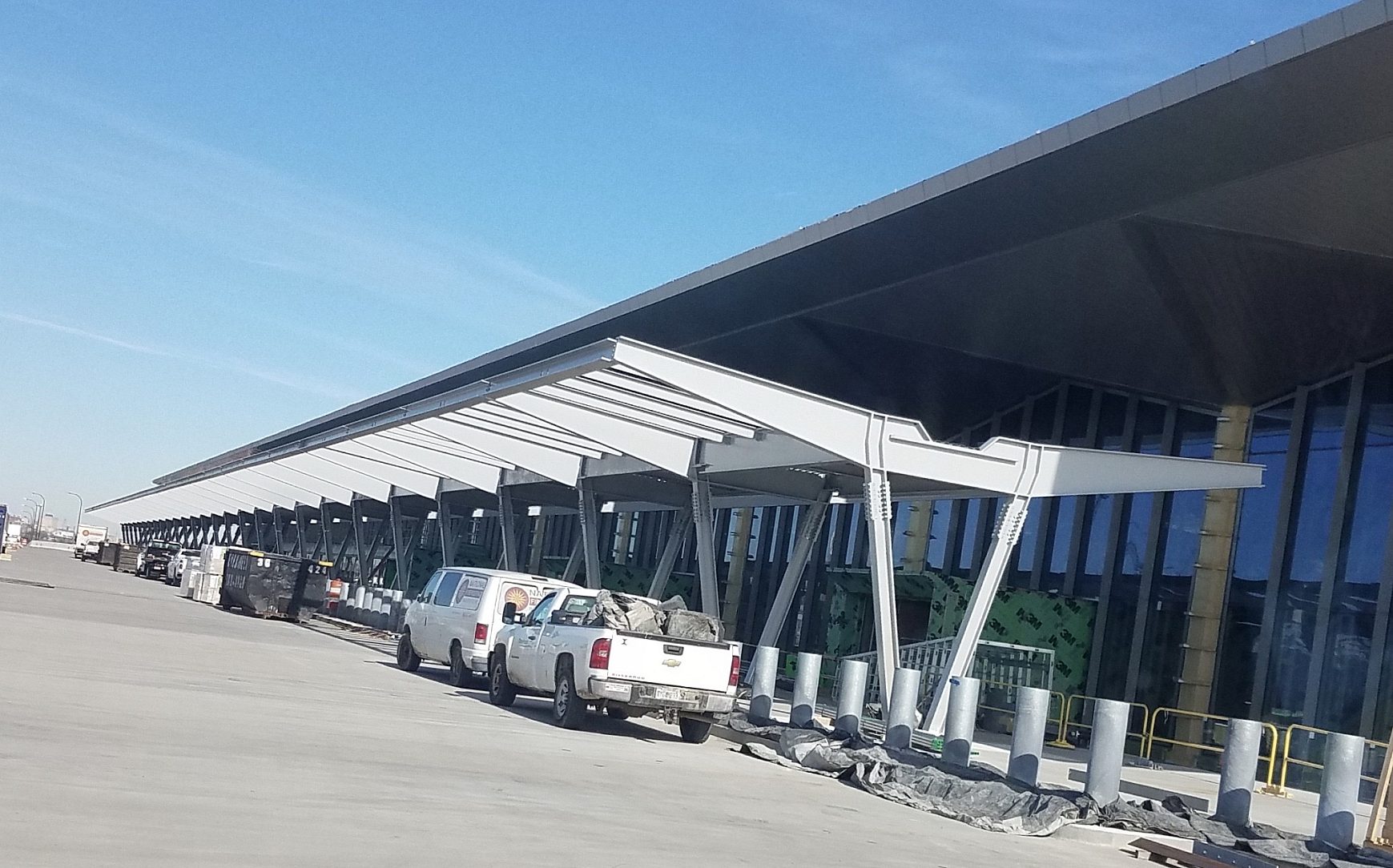

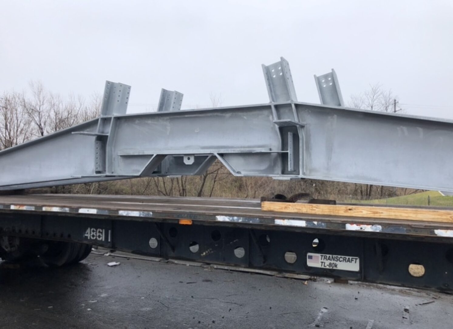

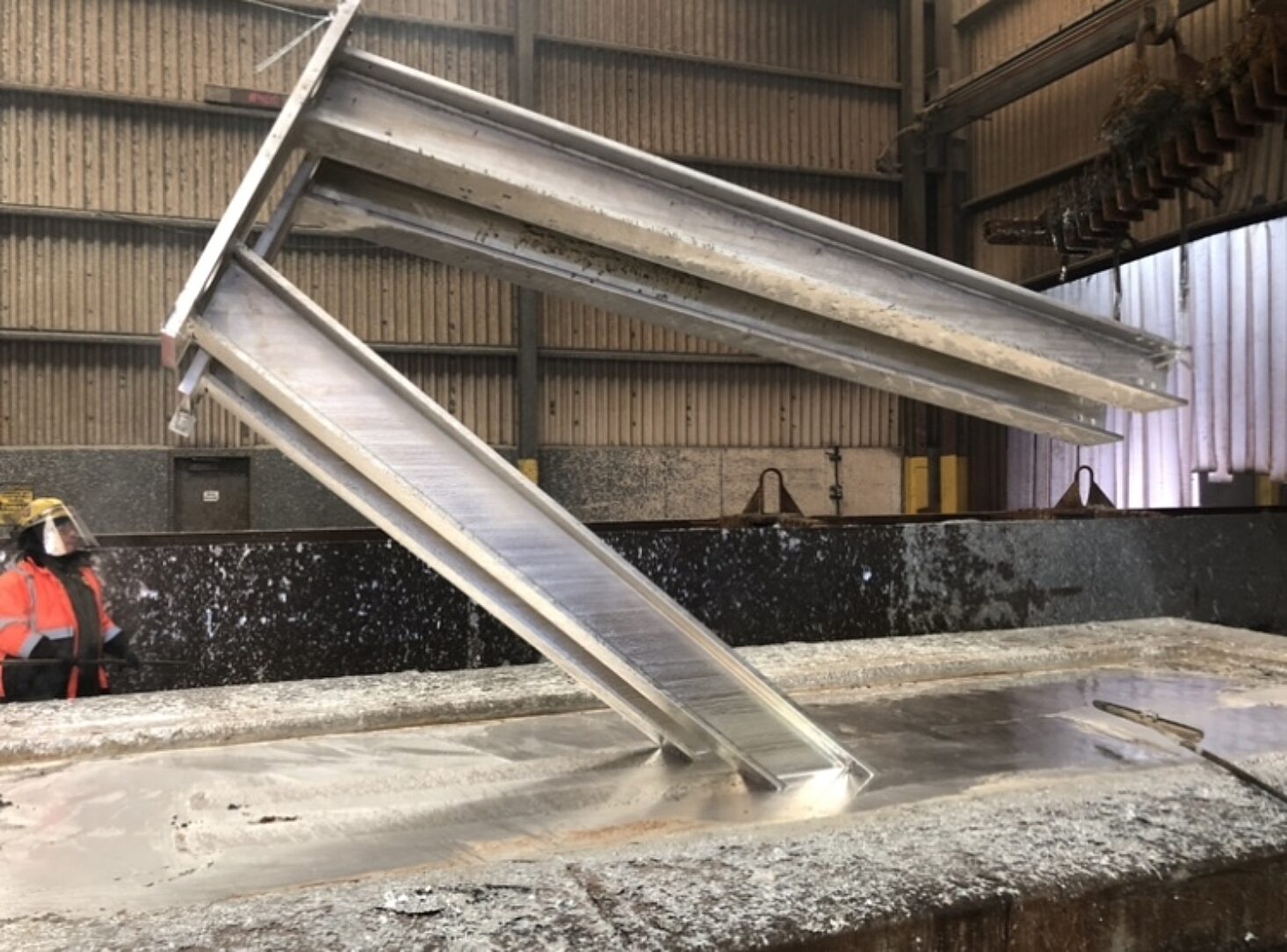

The two canopies for Terminal A were hot-dip galvanized and painted, to create modern looking, spacious pedestrian canopies, which are a beautiful duplex system. There was much communication between the galvanizer, fabricators, painter, and general contractor. Many of the pieces were intricate shapes and sizes and required extra attention to design proper ventilation. Due to the intricate shape of some of the plate girders, loading for shipment was a concern to uphold proper quality of the paint finish. After galvanizing was complete, the galvanizer, painter, and fabricator communicated on every load to complete a true team effort and a pristine duplex finish.

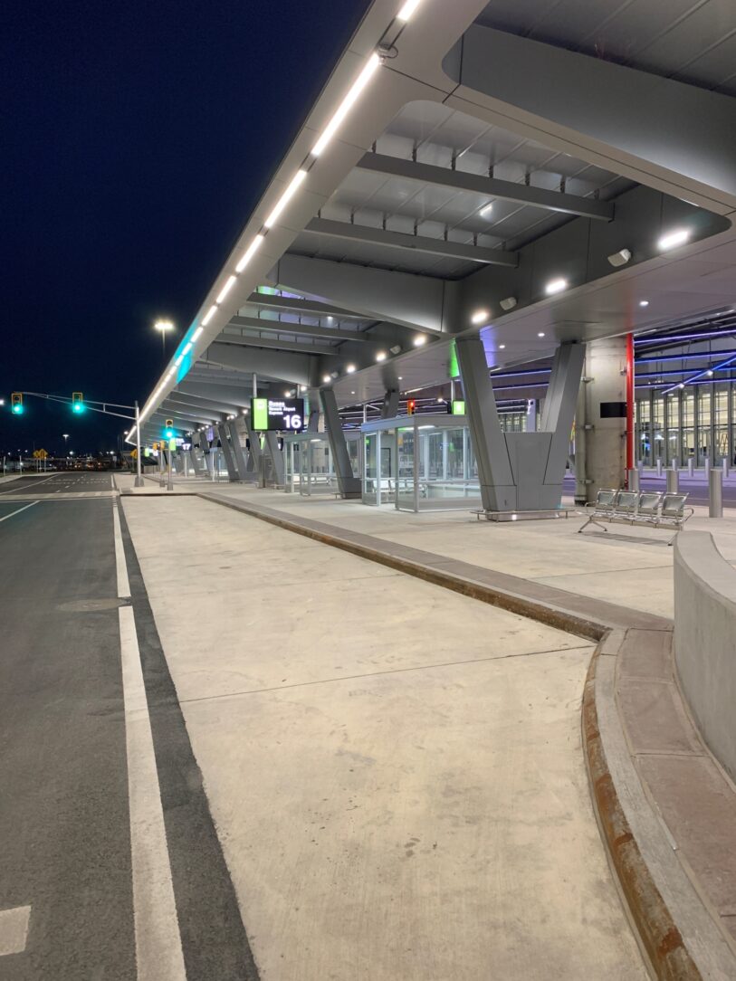

The Canopy is often the first impression passengers have of the “new” Terminal A at Newark Liberty Airport. Thanks to the durability of the hot-dip galvanized steel and added aesthetic of the duplex coating, the canopy will provide a warm welcome to air travels well into the future.
