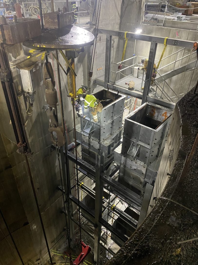

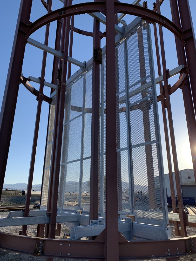

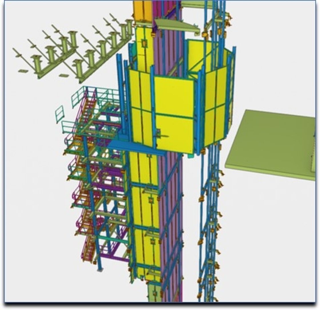

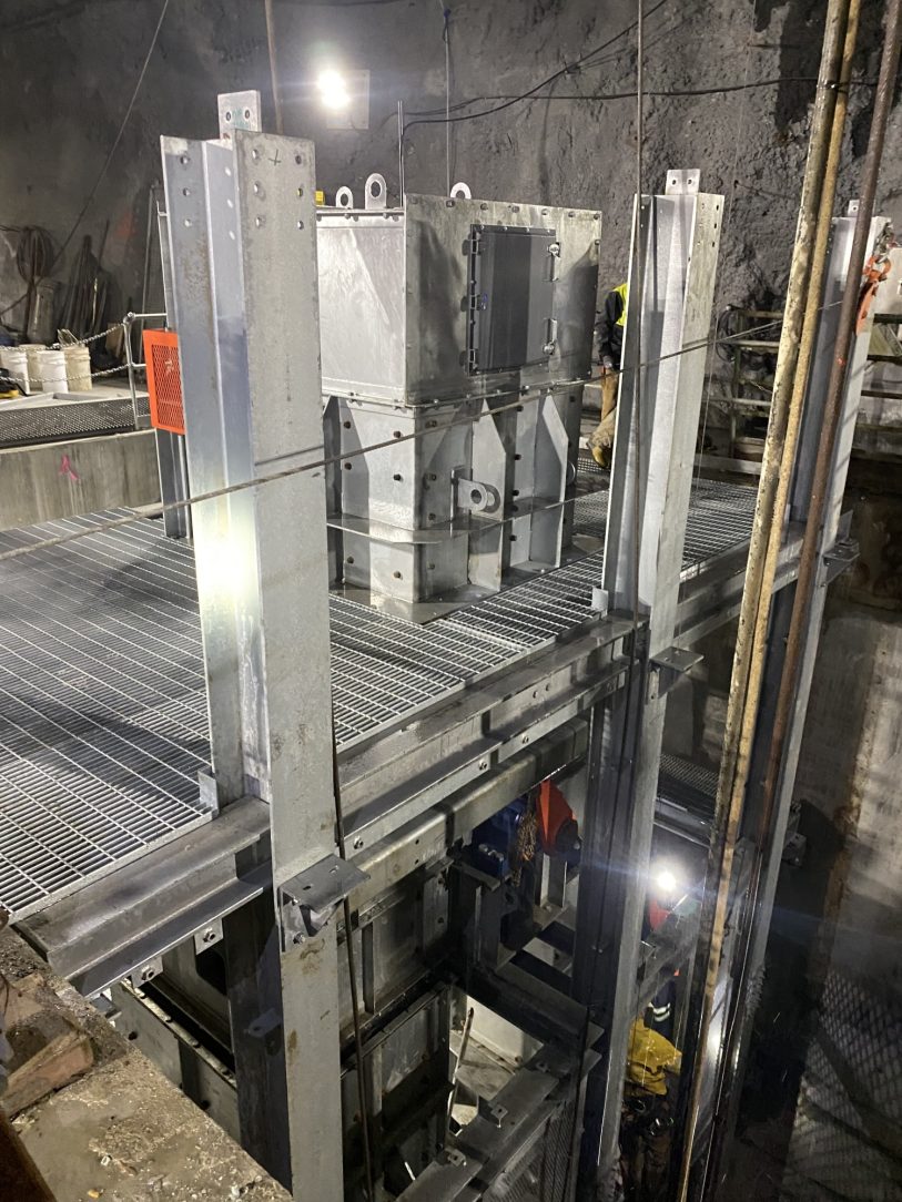

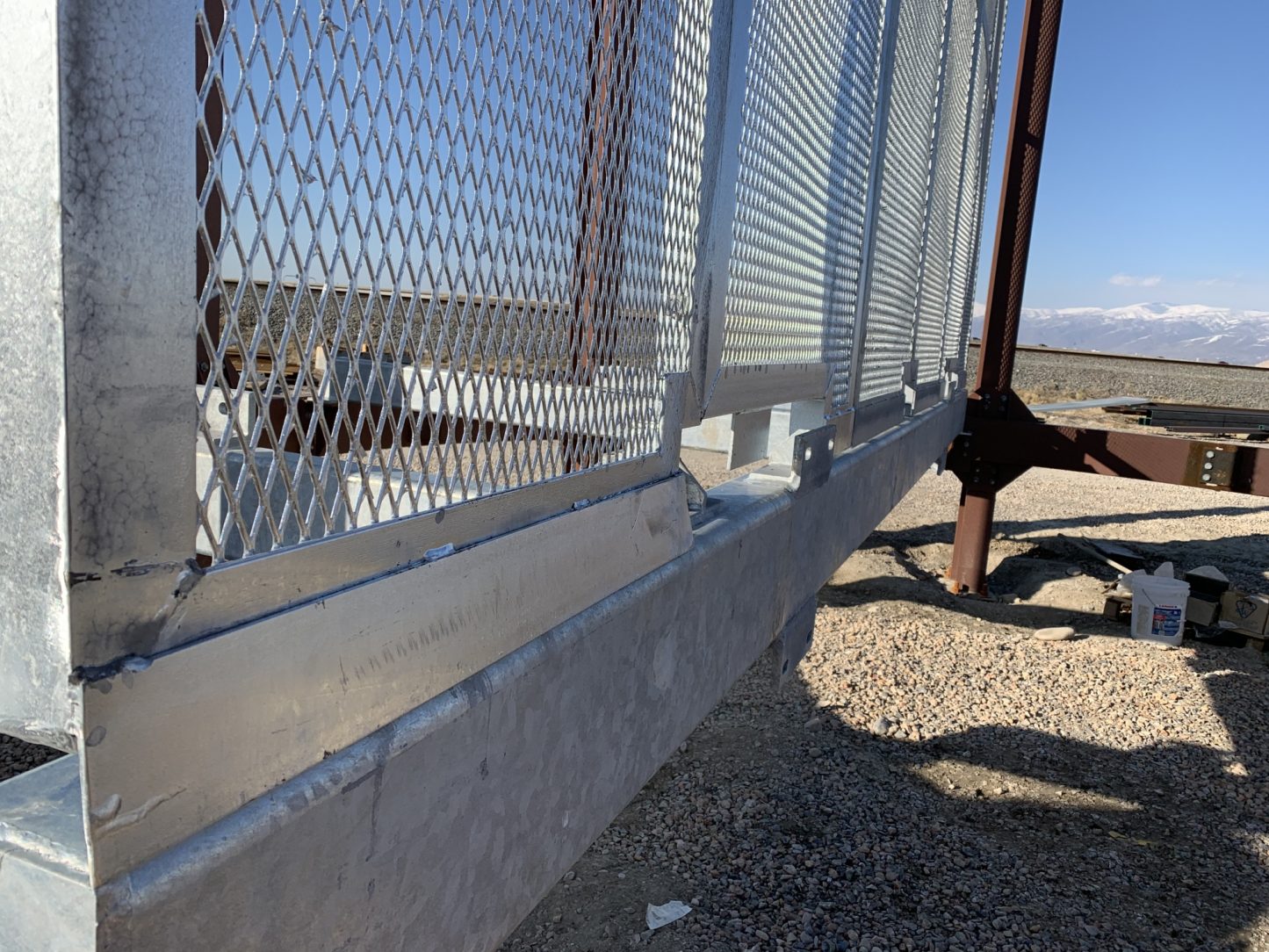

An expansion of the mine was required to increase production, ventilation, gold extraction and demand in the future. At a depth of 3,200 feet underground, the expansion is located in the deepest mine shaft in Nevada. Knowing the shaft would be in a moist environment, thousands of feet below the surface, a reliable form of corrosion protection was necessary to achieve the required 30-year life-cycle. Hot-dip galvanizing proved to be the best option due to its proven performance in a variety of corrosive environments. Other coating systems would be more expensive, require routine maintenance and have high VOC’s destructive to the environment. The brattice cages that guard the production and service shafts, load pocket steel in the underground material loading areas, handrails in the loading areas and set steel was galvanized for protection.
Throughout the project, the team experienced challenges that required effective communication across the project team. Some of the fasteners had to be welded to the structural steel prior to galvanizing. To meet this challenge, the fasteners were coated with silicone to prevent the zinc from adhering to threaded connections.
