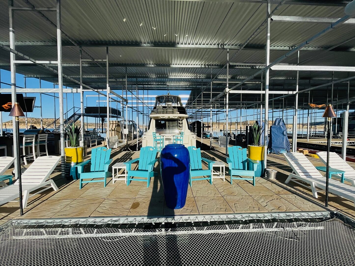

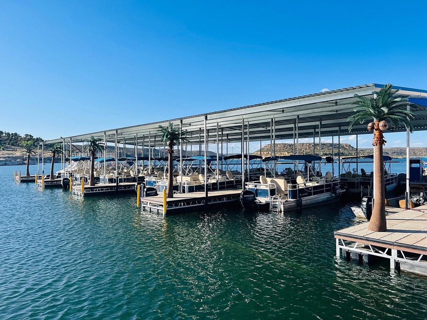

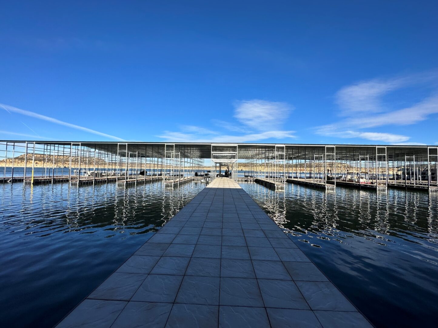

Designed, manufactured and installed by Marine Development Inc (MDI) the Navajo Lake Marina now includes more than 600 slips with over 100 mooring balls for rent. Metal structures located in or near bodies of water are some of the most challenging applications to protect from corrosion. Water hardness/softness, temperature, impurities, ph and movement of the water all play a role in the aggressiveness of corrosion.
The principles for MDI have been building boat docks, slips, marinas and other water structures for over ½ a century. As far back as the 1960’s, the most effective protection from corrosion for these water applications has been hot-dip galvanizing (HDG). Some of MDI’s earliest galvanized structures are still in use today, a reoccurring testimonial to the cost effectiveness of HDG. As explained by MDI’s Operations Manager; Jeff Otis: “Hot-dip galvanizing is vital to our company as well as our industry.”

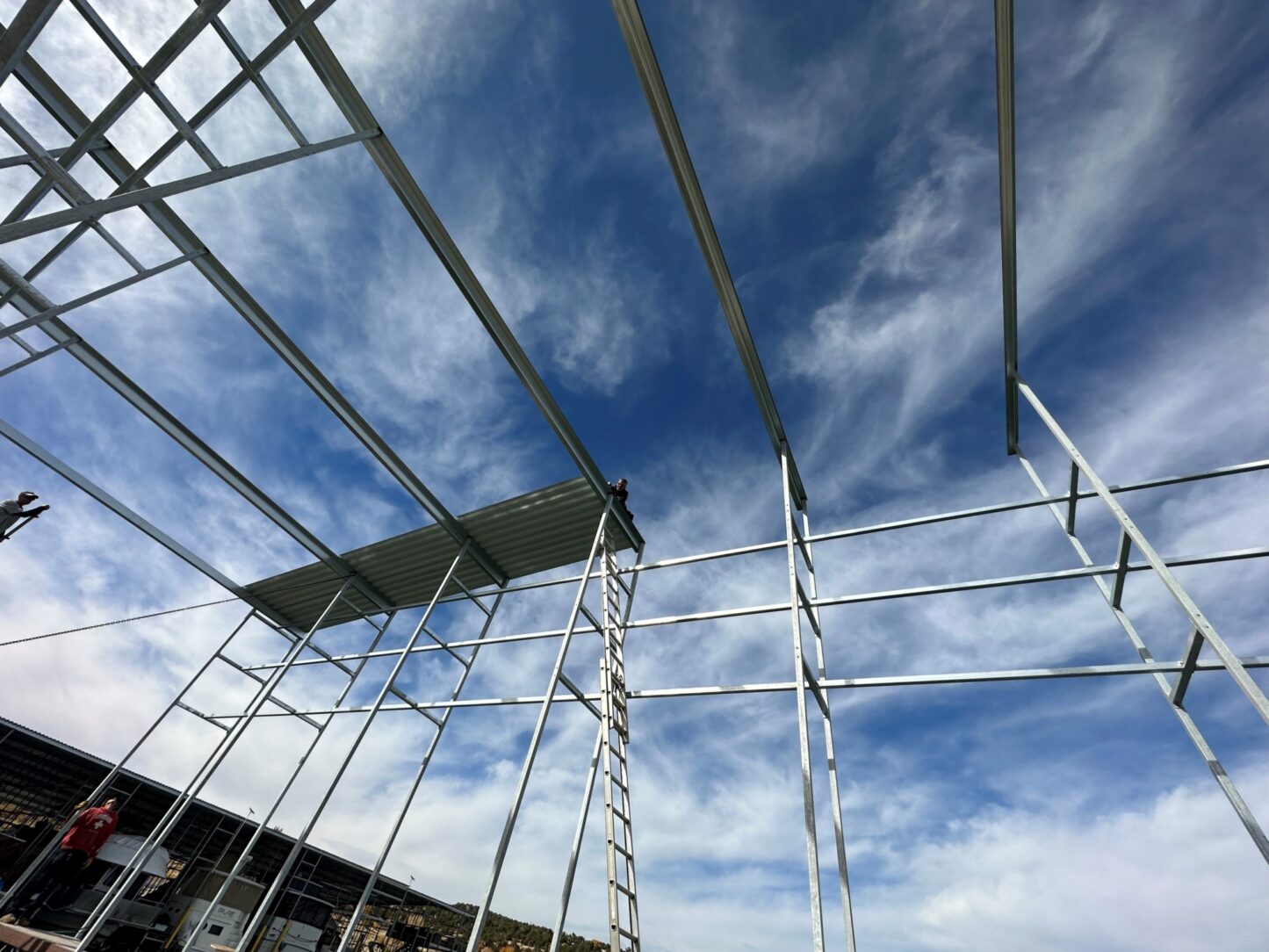

Boat dock sections
Tube columns
Arm stiffeners for water break
