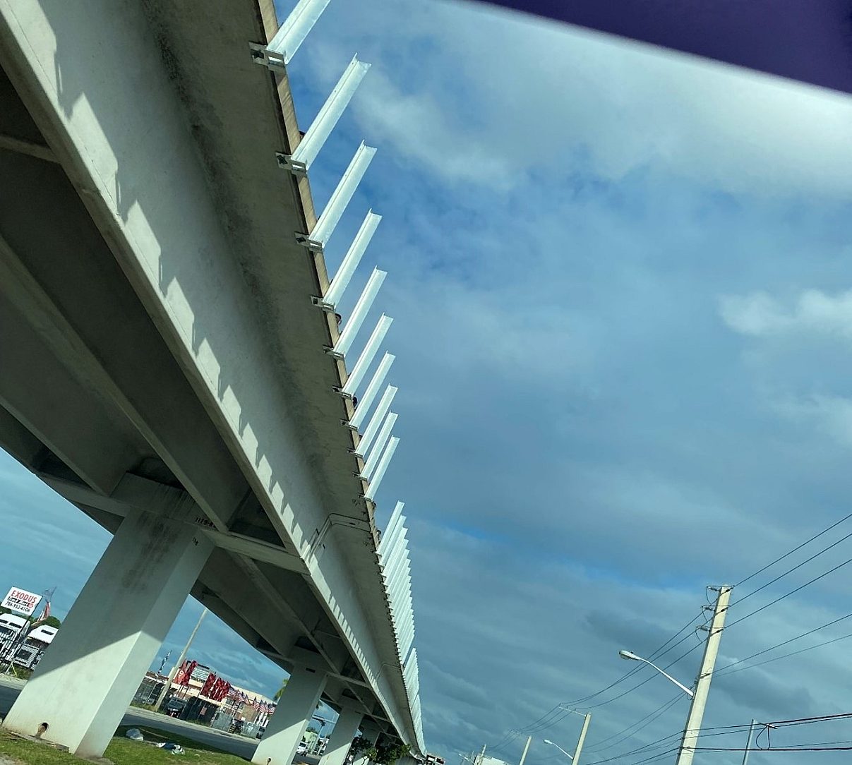

In 2019, the Miami-Dade County Department of Transportation and Public Works (DTPW) initiated a significant three-phase acoustical barrier replacement program aimed at improving quality of life for residents. The project, which had an $82 million budget, was launched due to the deteriorating condition of the old acoustical concrete barriers that posed a threat to citizens and the surrounding environment. Phases 1 and 2 were successfully completed, involving the removal of the old barriers.

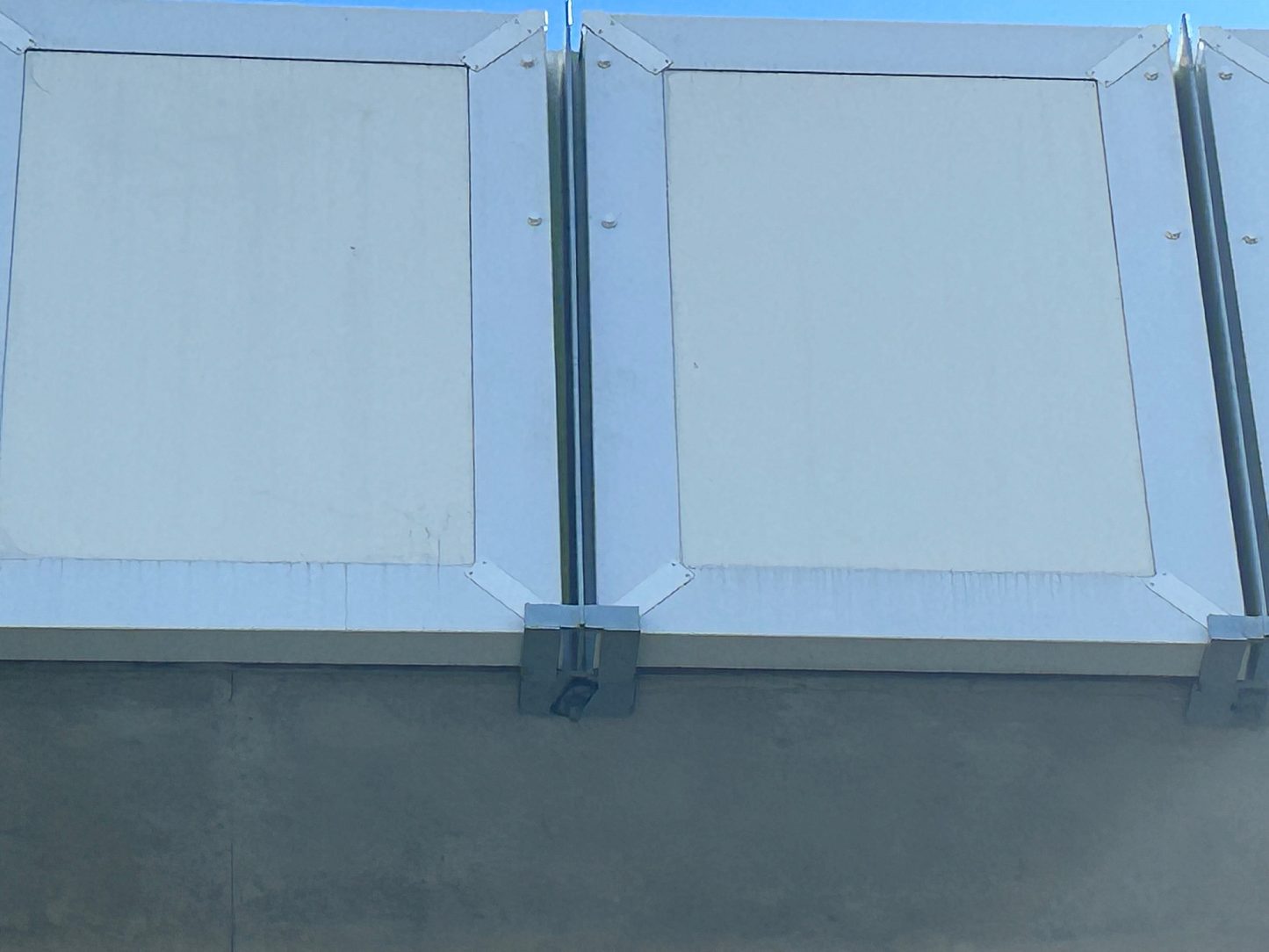

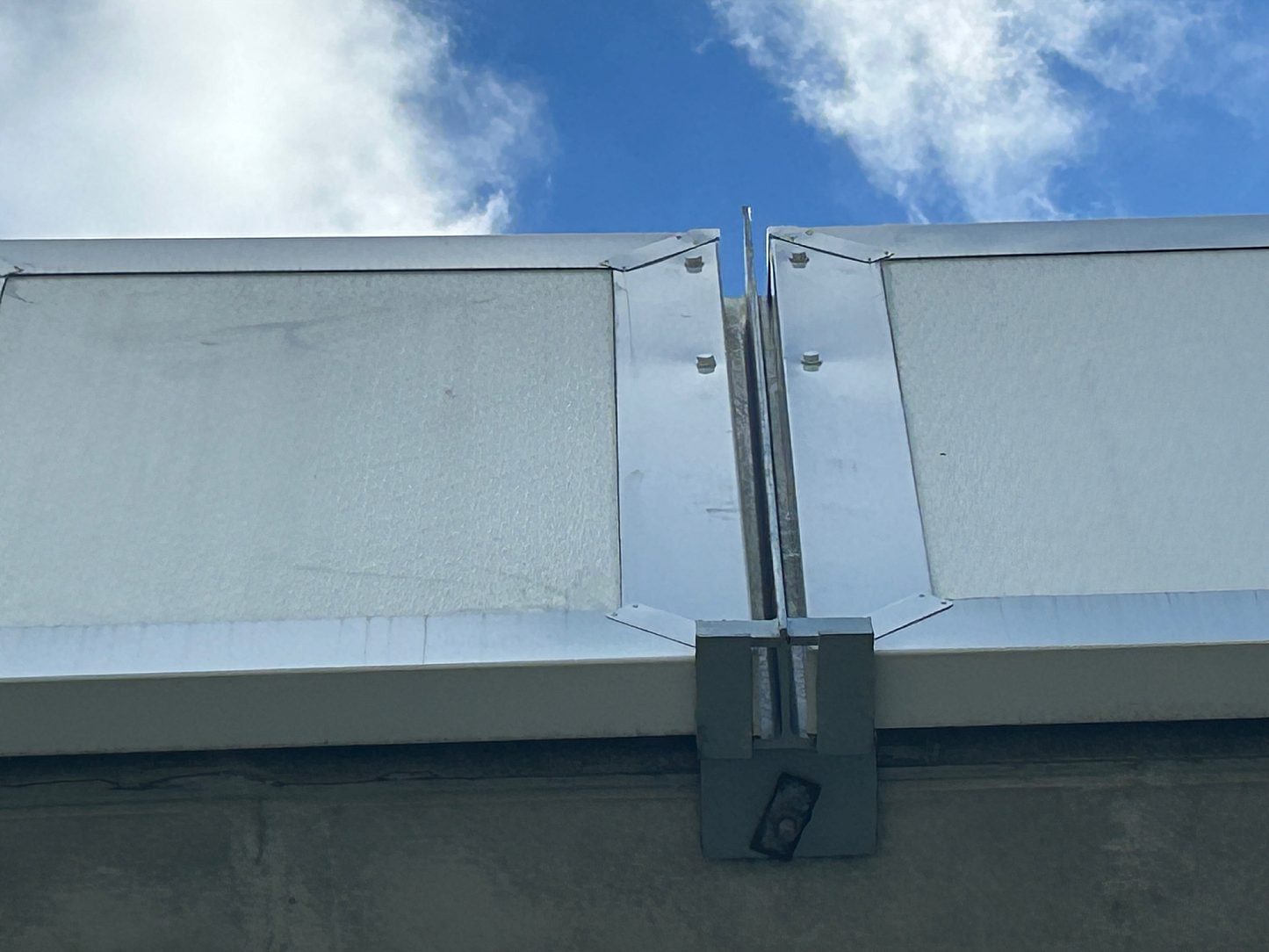

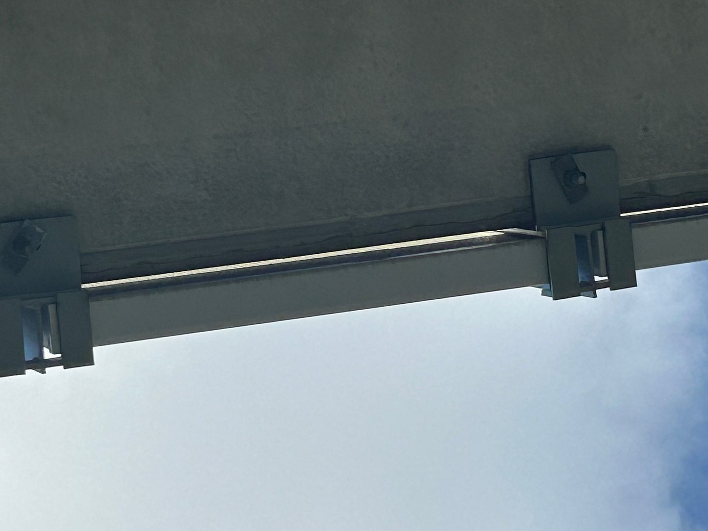

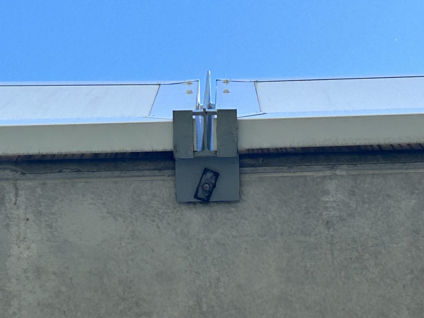

On January 4, 2021, DTPW commenced Phase 3 of the program, focusing on replacing the acoustical barriers in areas where the old panels were removed. The new acoustical barriers were designed to mitigate the noise produced by passing trains and prevent it from affecting nearby properties. Key components of the new acoustical barrier system included steel t-beams that served as the backbone of the system and connected the panels to the Metrorail infrastructure.

To address these challenges, various adaptations were implemented to keep the project moving forward. A unique palletizing method was developed by the fabricator to efficiently handle the flat t-beams during galvanizing. This approach facilitated the processing of a high volume of t-beams while maintaining quality and consistency. The teams involved in the project needed to be highly focused on throughput, given the substantial weight of the t-beams (80 lbs each). Efficiently stacking the beams for galvanizing was essential to meet the production requirements. A partnership between the galvanizer and customer was essential to the project’s success.
The project's focus on efficiently galvanizing the steel t-beams, which serve as a critical component of the new acoustical barrier system, demonstrates a commitment to creating a long-lasting, durable, and hurricane-resistant solution. This project not only addresses noise reduction but also has economic and employment benefits, making it a valuable asset to the Miami-Dade community for decades to come.
