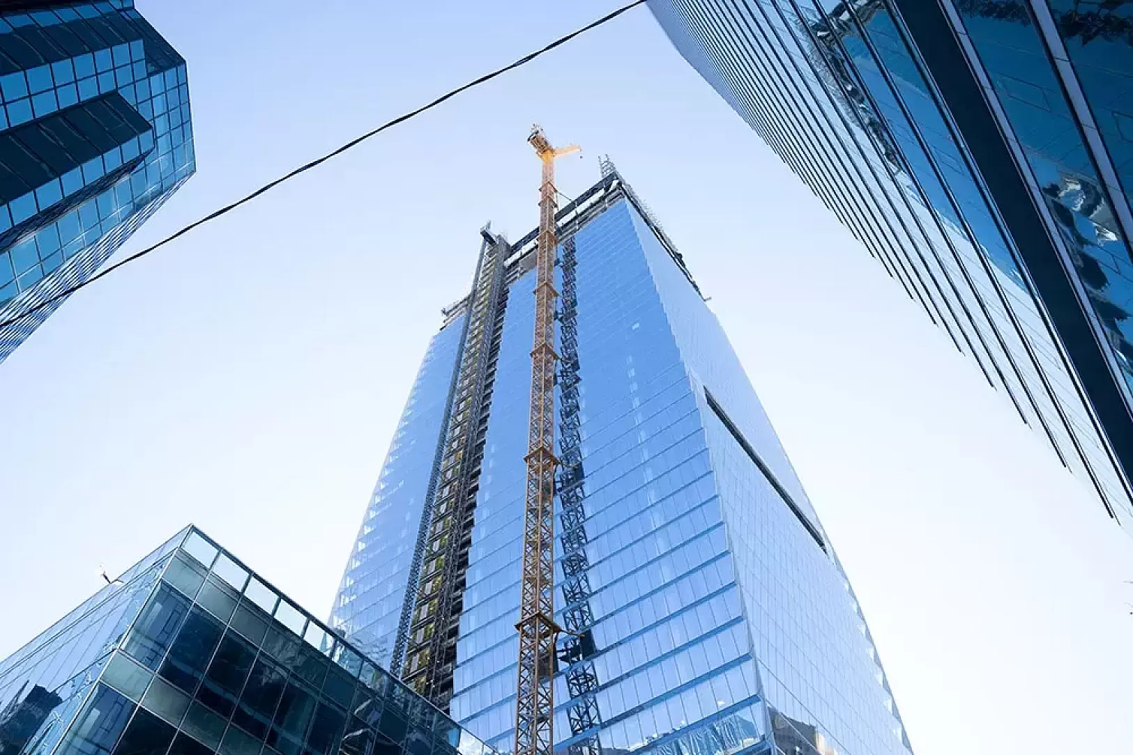

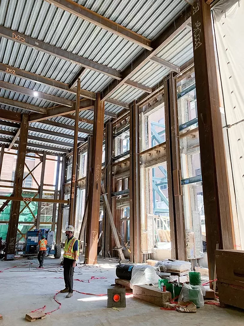

Glass and steel surround the structure, serving both aesthetic and practical purposes. The structure strategically channels lateral forces to its central axis, resulting in a tapered shape that optimizes wind resistance while offering unobstructed corner views. As for the size and caliber of the project, the vast gross floor area is nearly 1.2 million square feet.

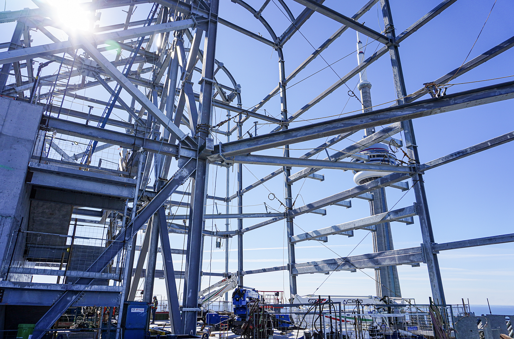

The most remarkable feature of the project is the crown that shelters the mechanical and Building Maintenance Unit (BMU) components. The complex design of the crown required meticulous structural work and a protective coating that would be able to withstand the harsh environmental conditions. Stability of the structure was paramount and after considering other options for protection, galvanizing stood above the rest due to its durable and long-lasting benefits. Along with durability, galvanizing reduces the need for frequent touch-ups compared to traditional paint coatings. The adaptability of galvanized steel allowed the team to efficiently address the intricate design and size challenges posed by the project.

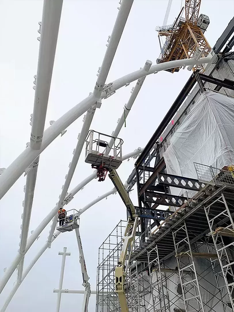

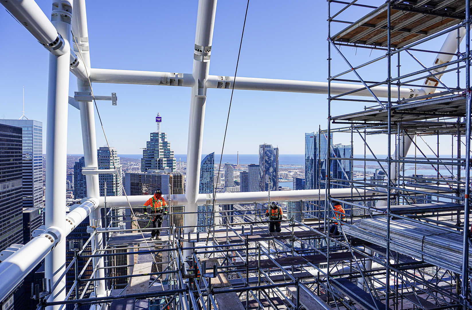

The curved, exposed structural steel (AESS) pipes received a 3-coat polyurethane duplex system. The top white coat provided a clean and modern look as the final aesthetic.
Throughout the project, there were challenges that required the galvanizer to communicate regularly with the customer. The design stage of the project was crucial as the galvanizer was able to share expertise on vent and drain hole placement. This was pivotal for the project to create the highest quality product for the customer. Some of the larger pieces also required progressive dipping, which required fluid communication between both parties to ensure the pieces would be coated completely.

Primary structure that is galvanized is the crown that covers the mechanical and BMU components.
