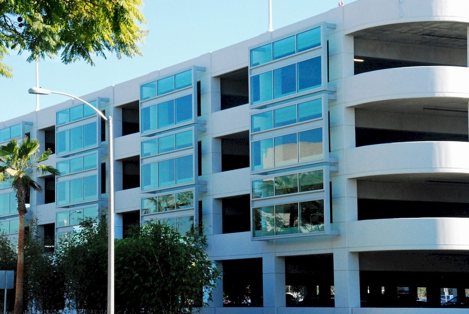

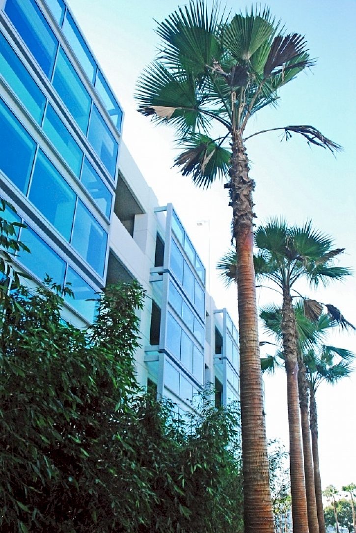

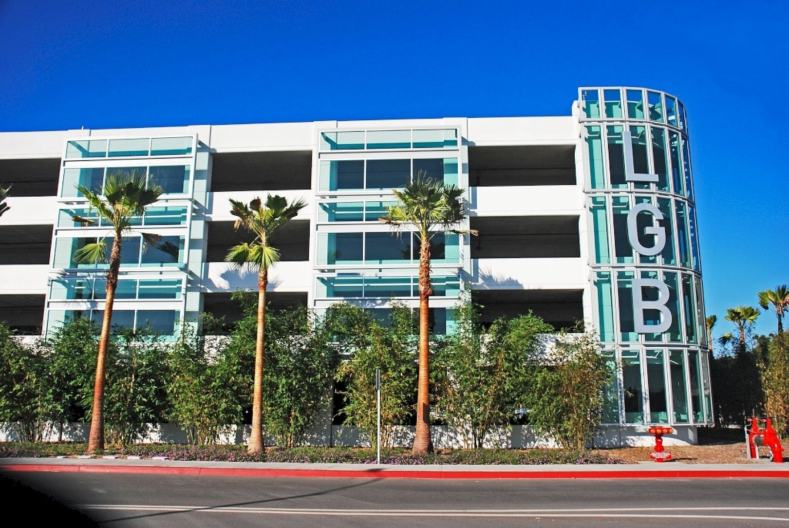

Long Beach Airport's new parking structure is visible upon entrance to the airport property. The large structural steel tube frames was specified with a paint over galvanized end product to ensure extended product life while offering a unique appearance to all airport visitors. During the design phase, great attention was placed on the scale of the parking garage relative to the Long Beach airport's main terminal, a historic city landmark.
Unfortunately, however, there is limit to what can be done to reduce the visual impact of a parking garage. Their solution was to fabricate (architecturally exposed) painted steel frame facades to adorn the outside of the parking garage, giving it a very 1950's Art Deco look and feel. A duplex coating was absolutely essential in protecting the steel from corrosion in this aggressive temperate marine climate. (The Long Beach Airport is just 9 miles from the Pacific Ocean.) Paint over galvanizing was the perfect synergistic combination to accomplish this monumental feat. Effectively, adding many additional years of service life to the project.
2011
Long Beach, CA United States
Coating Durability, Ease of Specifying
Large / Offset Tube Steel Frames (10' W x 20' L x 2" H)
