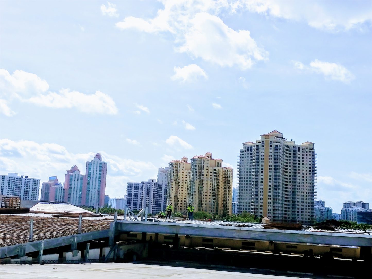

Although parking garages are essential space saving structures, traditional concrete garages are not a one-size fits all solution. The Turnberry Resort team determined a galvanized steel frame parking garage was the best fit for their project due to long-term durability and design flexibility. By using steel, instead of concrete, they were able to fit more parking spots in less space, leaving extra outdoor space for guests to enjoy while also providing options for future expansion.
A sleek, open steel frame is also more attractive than a concrete structure. Although the steel structure saved space on the resort, it would be vulnerable to the environment and residents without a protective coating. When the team learned about the numerous benefits hot-dip galvanizing added to the project, the decision was easy. Due to its immersion process, all the steel would have complete coverage and protection from the corrosive properties of salt water from the ocean. The durable and abrasion resistant coating would also extend the life expectancy of the structure.
The resort can also rest assured that little to no maintenance would be required on the galvanizing throughout the structure's design life rounding out the value of using a galvanized steel frame instead of concrete.
