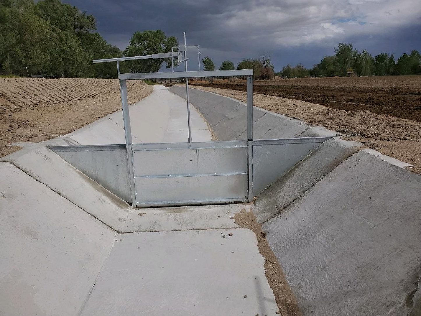

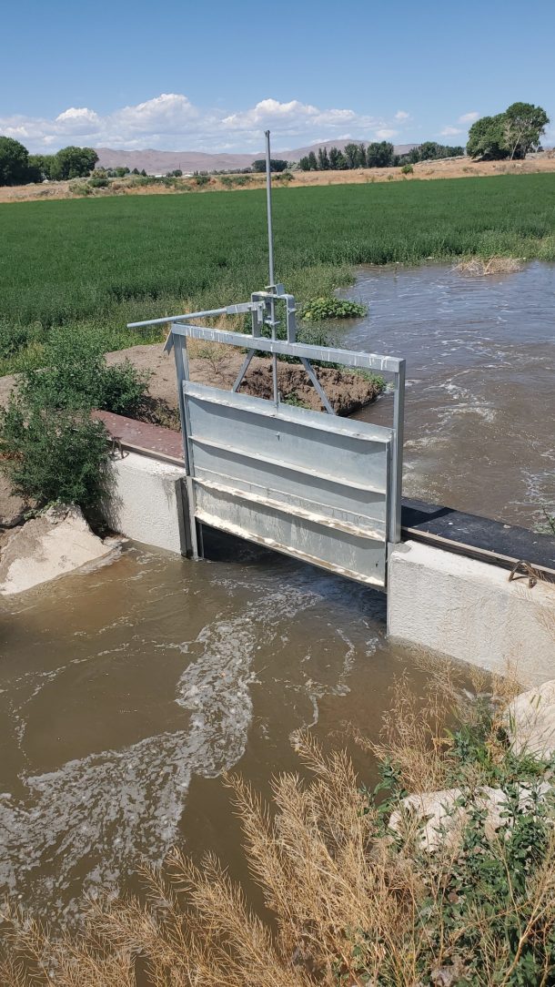

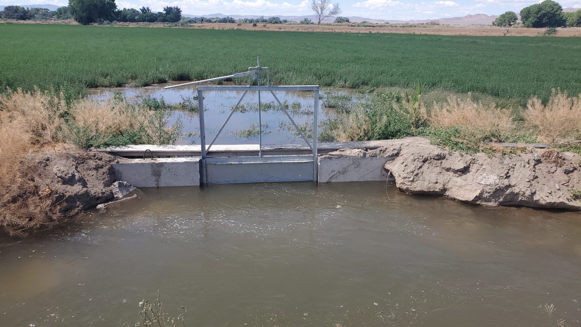

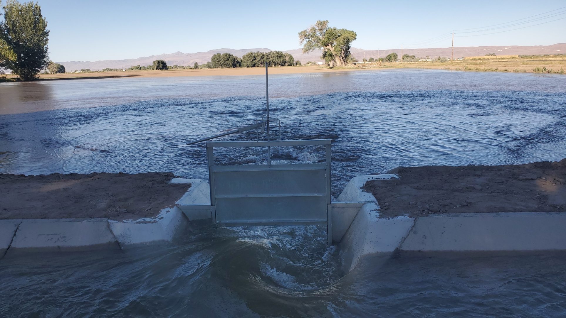

Each headgate is fabricated from A36 eighth-inch plate, flat bar, quarter-inch angle, and three-quarter solid rod, weighing approximately 200 pounds. The design consists of a durable outer frame and a sliding plate mechanism that allows operators to raise or lower the gate with a rod-and-lever system. During installation, the gates are set into the concrete walls while the concrete is poured, ensuring that water pressure does not distort or shift the gates over time.
Recognizing the need for a more sustainable and cost-efficient solution, Roger Lambert Construction partnered with their local galvanizer to explore hot-dip galvanizing. The metallurgical bond formed during the galvanizing process provided complete and uniform coverage, including the critical internal and hard-to-reach areas of the gates. Unlike paint, the zinc coating offers a sacrificial layer of corrosion protection that resists wear from constant water exposure.
The results have been dramatic, with galvanized coatings delivering a lifespan two to three times longer than paint in submerged and high-moisture environments. This extended durability reduces the need for touch-ups and replacements, saving significant labor and material costs over time. Additionally, the metallurgical bond formed during the galvanizing process enhances structural integrity, providing complete protection for the steel without compromising the function or performance of the gates.
By transitioning from painted coatings to galvanizing, Roger Lambert Construction has delivered a superior product that provides decades of reliable performance to Nevada’s agricultural community. The change not only minimizes long-term costs but also ensures that irrigation systems remain efficient and dependable — a critical factor for farmers who depend on consistent water delivery to maintain healthy alfalfa crops.
