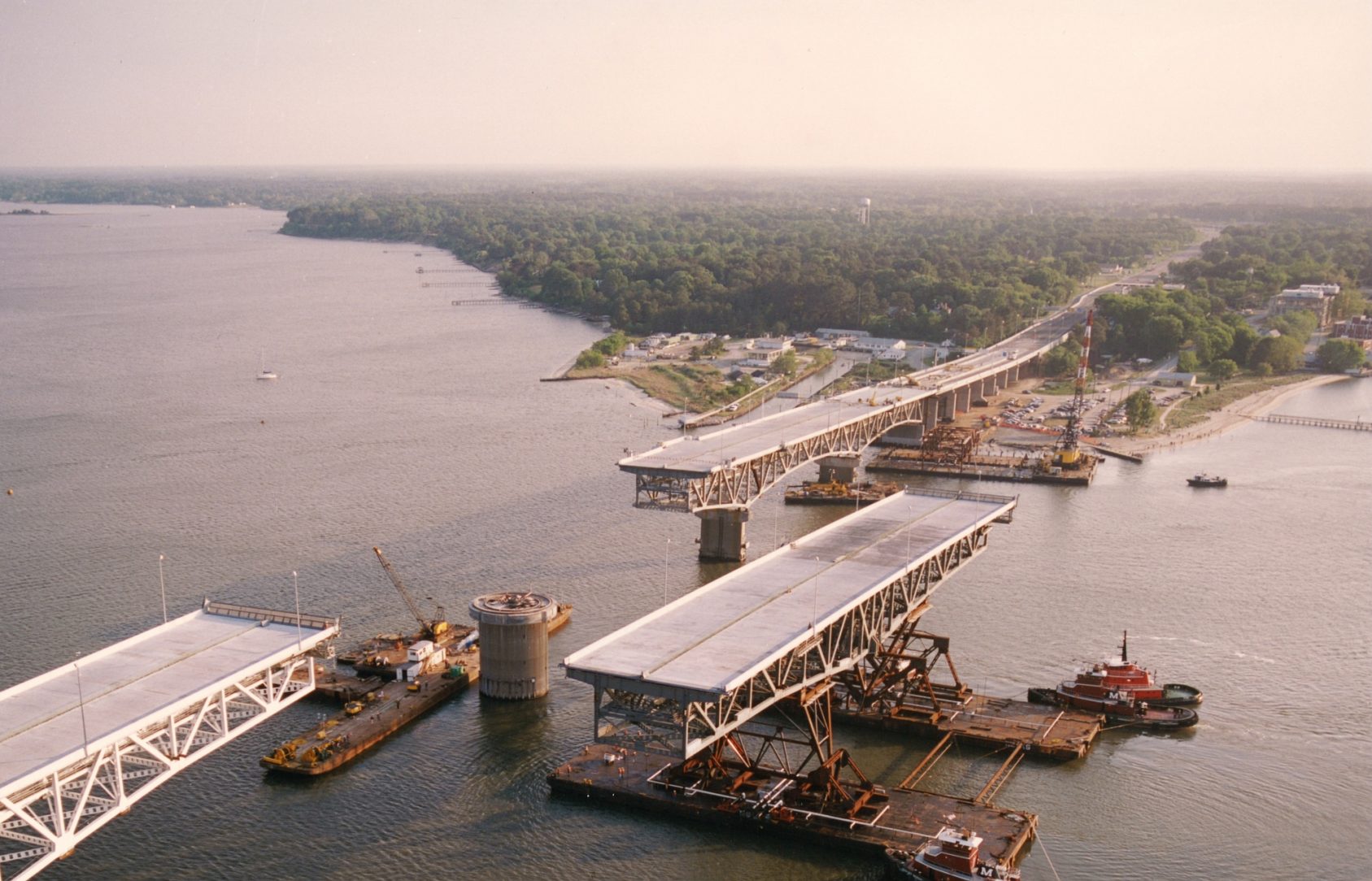

The George P Coleman Bridge widening of the truss section was given a 24-day construction period, but the job was completed in half that 12 days. The bridge was staged on temporary towers held by barges with a floating dock in between the halves. Then, they were able to connect the halves and float the old span out and replace it with the new span. Hot-dip galvanized steel played a part in this unique installation, used in all the handrails, stairs and ladders of the new span. Because of the tight schedule, hot-dip galvanizing made sense because it is factory controlled and independent of weather and humidity requirements, allowing it to meet the schedule flawlessly.
