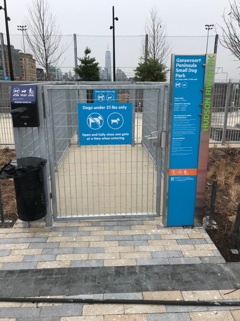

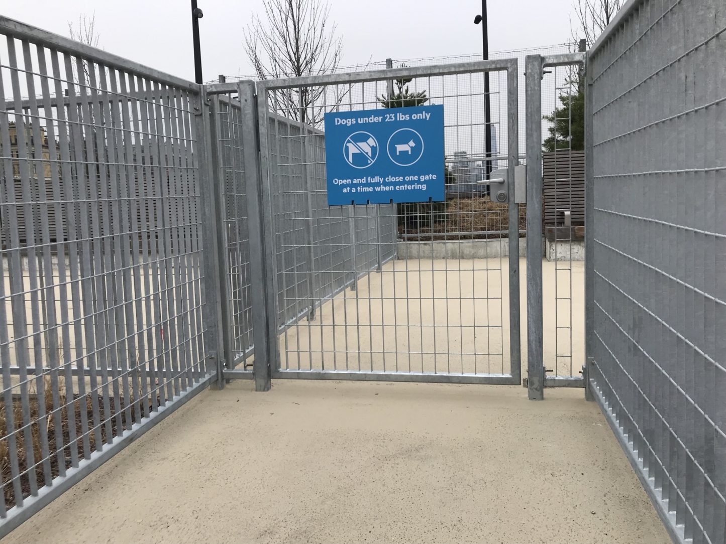

Galvanized Orsogril fence panels at 4ft tall and a total 548/LF. super strong coating layer for the ultimate chew protection from inside or outside, very small openings make getting teeth into it virtually impossible and its heavy weight adds even more dig protection. Orsogril fence panels were galvanized to reduce rust and corrosion. As its durability, low cost, less maintenance and security, Orsogril has been an important member of the dog park. The heavy gauge panels guarantees the solid structure and ensures the dogs can't tear or break the fence panels. Galvanizing prevents corrosive attacks from all weather, dog urine and feces.
