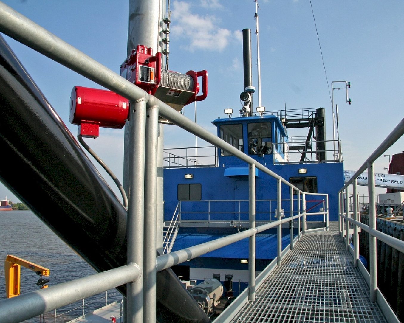

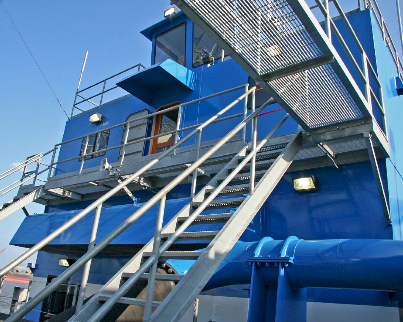

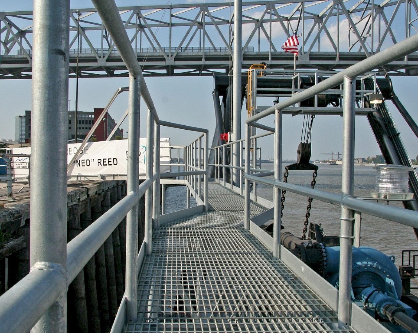

All stairs, ladders, walkways, work platforms, and handrails.
Steel: 500 tons
HDG: 10 tons
