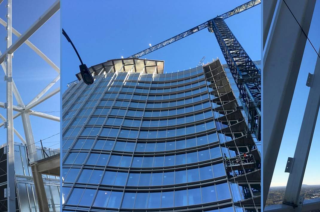

Two features of this building contribute to its beautiful appearance and its net-zero energy rating; its photovoltaic roof and its energy diffusing outer wall panels. Both of these features needed strong and durable supporting structures that could pass the test of time.

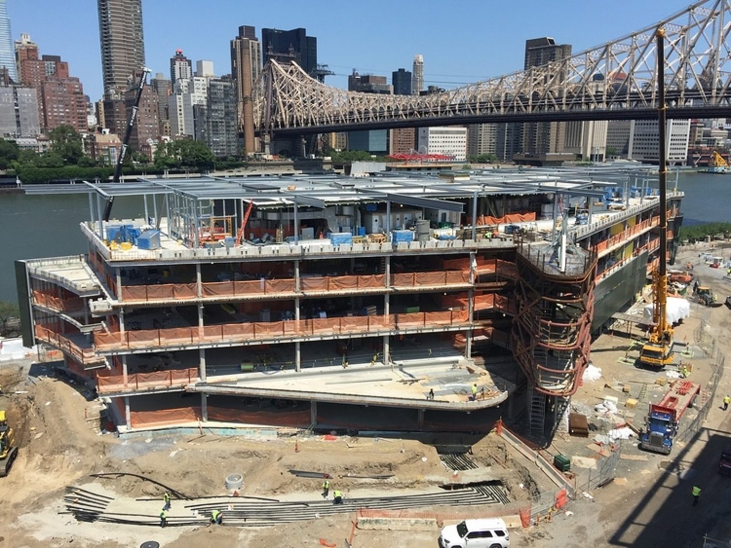

This test was made all the more challenging as the Center sits on the southern tip of Roosevelt Island, adjacent to Manhattan and directly under the always busy Queensboro Bridge. Right in the middle of New York City, air quality is less than ideal, and the pollutants and salty mist from winter traffic overhead all contribute to an aggressively corrosive environment. Add to that the high saline humidity from the East River. which actually is a salt water estuary, and any building components will be severely challenged.
While a sky-high budget for this multi-billion dollar campus project would have allowed for many more exotic corrosion solutions, the unbeatable performance of hot-dip galvanizing still carried the day. Ease of specifying, rapid steel fabrication and turnaround time by large modern galvanizing plants all contributed to the selection of galvanized steel. The rugged nature of hot-dip galvanizing also streamlined erection and the almost non-existent maintenance requirements were compelling, especially for areas that would be very hard to access after construction.
All of the hundreds of tons of exposed structural steel that supports the hi-tech features of the Bloomberg Center are now protected by hot-dip galvanizing. Its selection at this “cost is no object” symbol of pride for the Big Apple is a testimony to the power of hot-dip galvanizing even when its low initial cost isn’t a prime factor.
