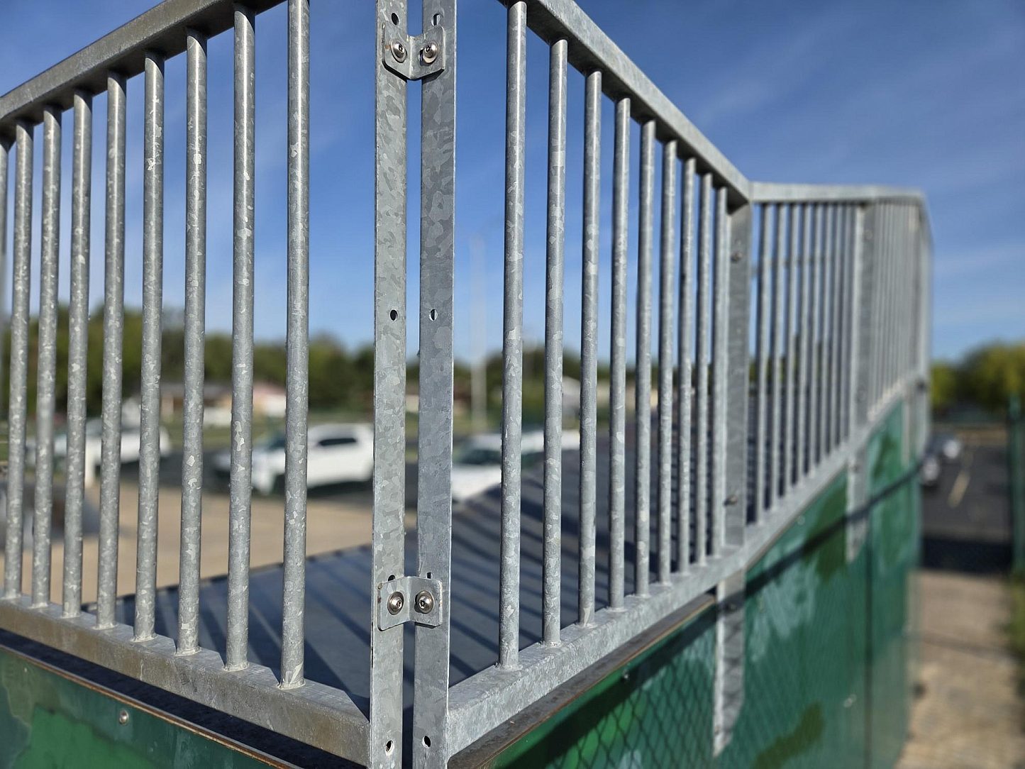

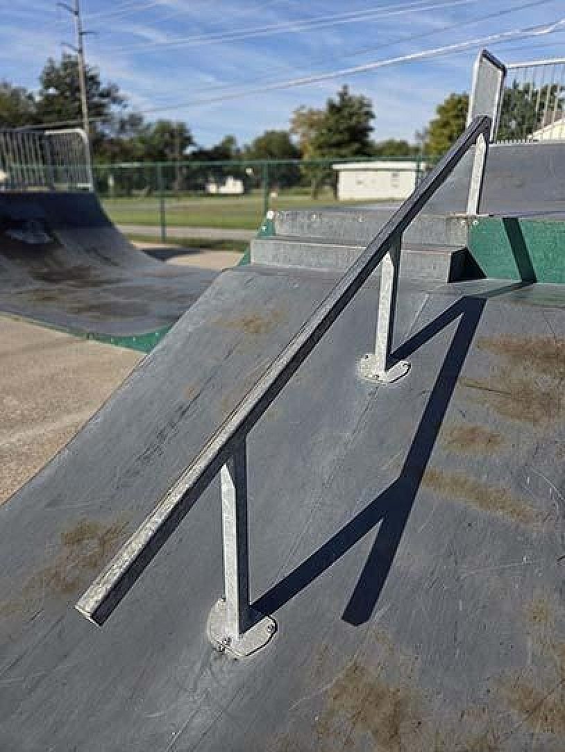

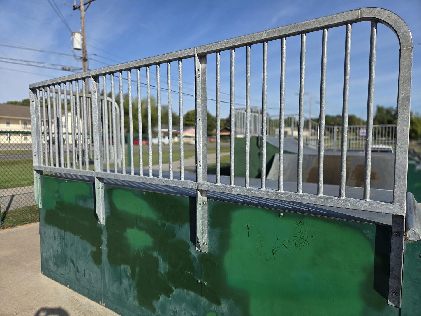

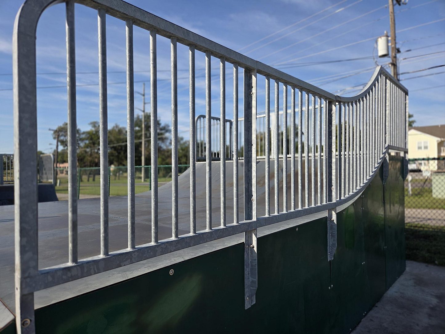

Knowing that the park would endure constant impact from the environment as well as use from skaters, the city made the decision to galvanize the ramp frames, guardrails, light poles and fixture brackets.
The durability of galvanizing the steel members has proven itself with time; nearly 17 years after installation and the coating protection system continues to perform exceptionally well, still meeting all ASTM specifications for thickness and corrosion resistance. Mil readings taken in 2025 recorded an average of 3.58 mils of zinc coating which is impressive after 17 years of services. Plus, according to the zinc coating life predictor, these mil readings indicate the steel in this skate park will last another 80 years further proving the strength and durability of this coating system.
