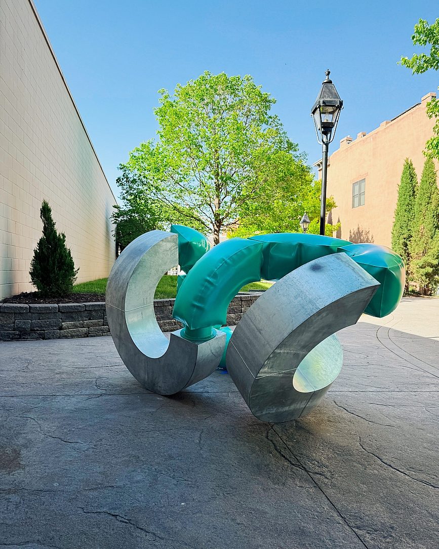

The sculpture represents the intersection of artistic innovation, community identity, and the unmatched durability of hot-dip galvanizing. Installed in downtown Hastings, Nebraska, it occupies a revitalized public space on a lot once home to a cigar factory. The transformation of the site parallels the transformative power of galvanizing itself – elevating steel into a long-lasting landmark that both honors local heritage and enriches the city’s creative district.

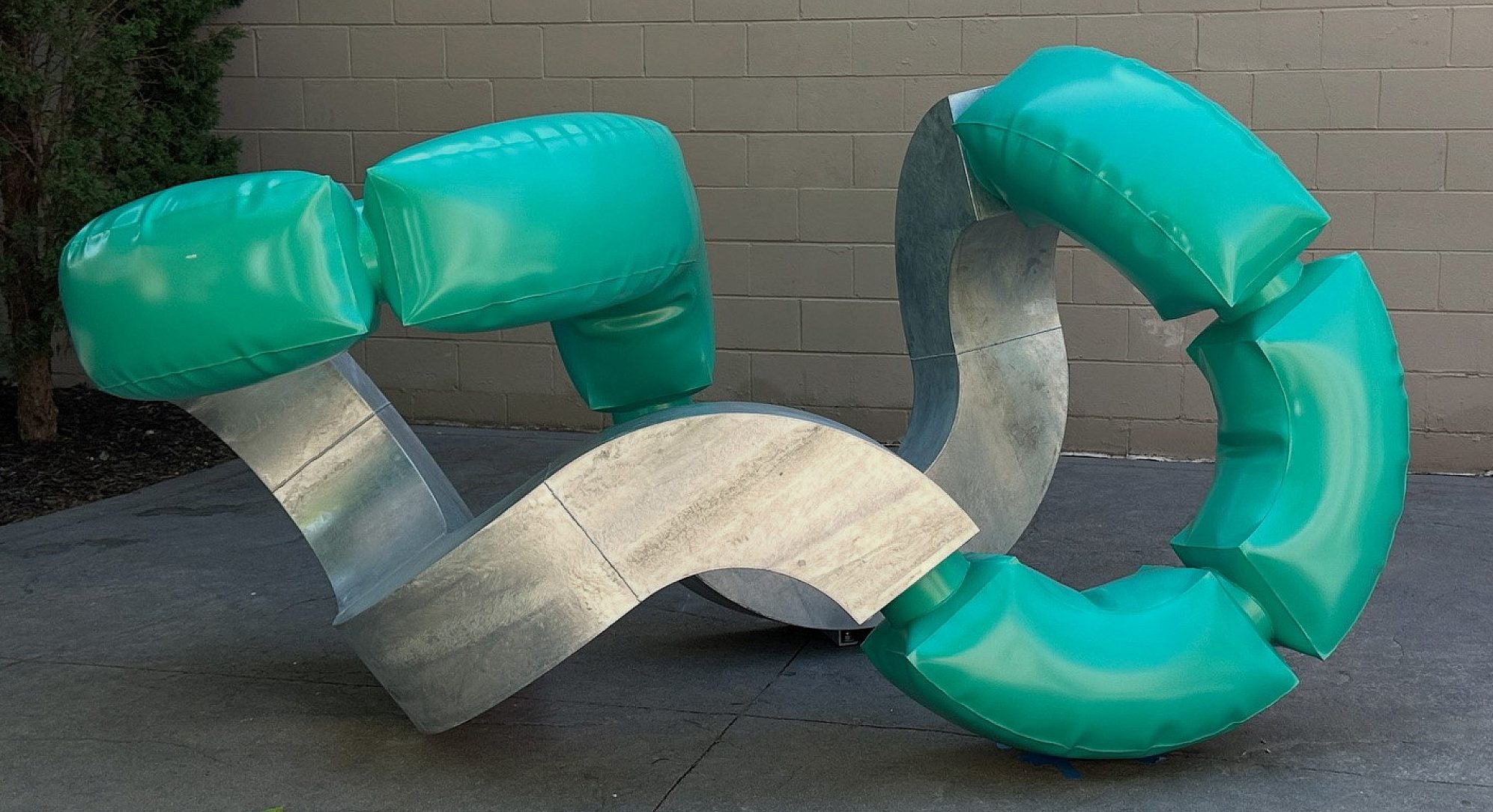

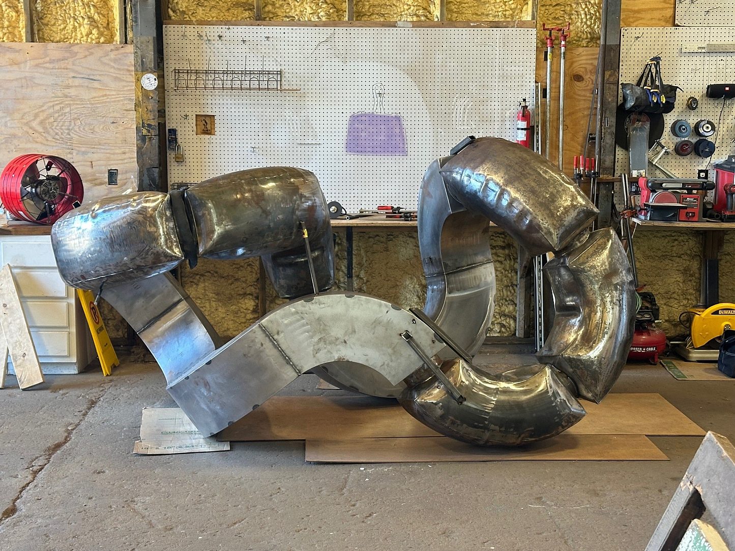

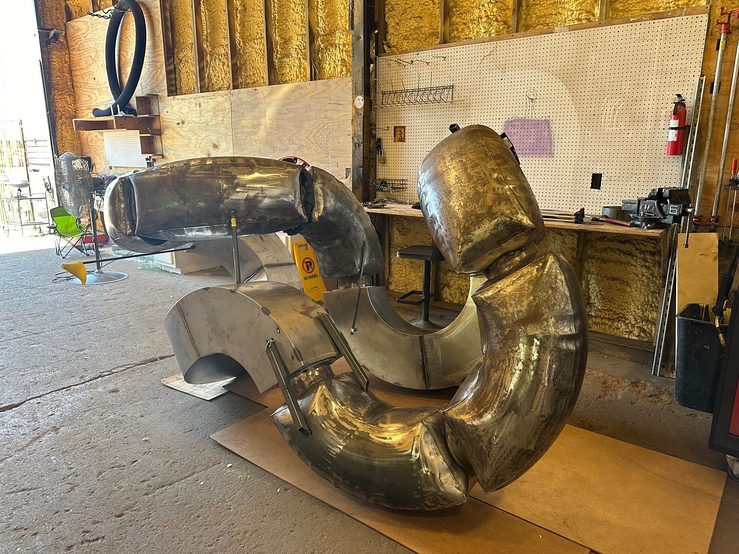

The sculpture’s signature inflated steel forms were created using Badham’s proprietary process, in which hollow steel components are heated in a ceramic kiln or glass annealer to approximately 1,300 degrees Fahrenheit – glowing orange and pliable – before being carefully expanded with compressed air. This technique produces geometry unlike any traditionally fabricated steel structure. The process challenges tolerance, introduces unpredictable change, and requires precision in fitting the inflated shapes together. Each form presents a new engineering puzzle, making structural reliability and surface protection essential.
Hot-dip galvanizing became an integral part of achieving those goals. Hastings has a long history with galvanized steel – center pivot irrigation, invented locally, has always depended on HDG – and the community specifically favored galvanizing in this commission. The artist also had prior positive experience with galvanized public sculptures, reinforcing the value of a coating capable of withstanding outdoor exposure for generations.

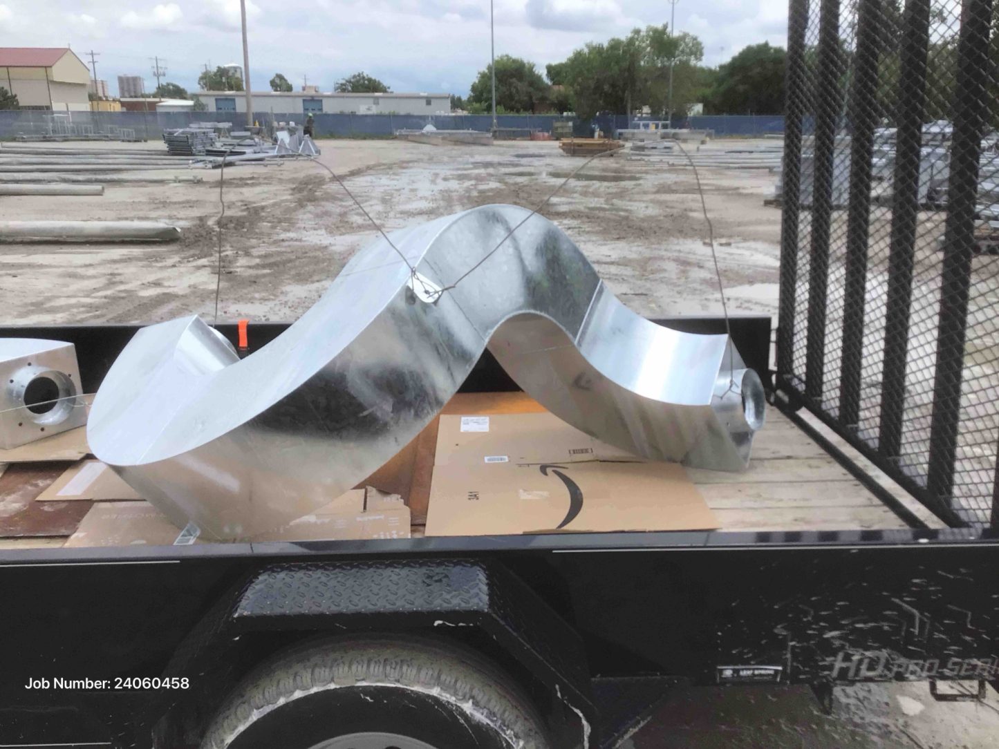

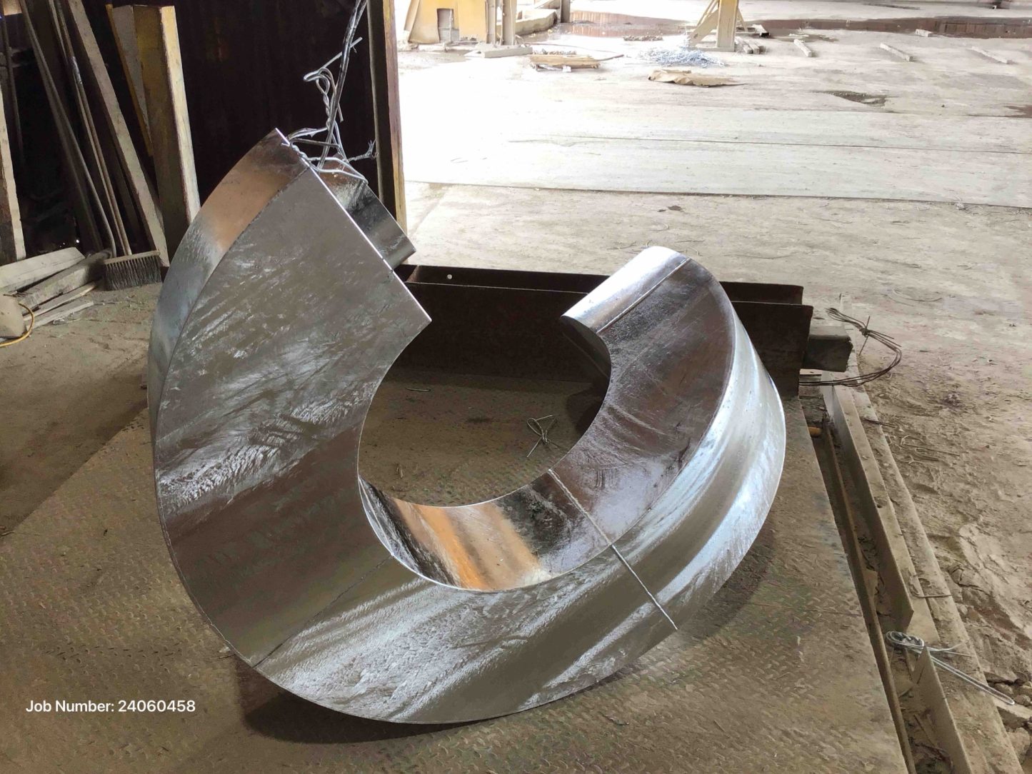

The unconventional geometry of the inflated steel introduced unique galvanizing challenges. Powder coating was initially considered, but the forms did not accept it well. Ultimately, the sculpture required extensive surface preparation, including blasting and manual finishing work completed in Lincoln, Nebraska. During the HDG process, the piece was galvanized multiple times to achieve the precise finish desired by both the artist and city. Through these iterations, Badham gained a new understanding of how zinc flows over the complex surfaces and how certain inflated shapes respond in the kettle. The galvanizer worked closely with the artist to ensure full coverage, interior protection, and uniform appearance across all structural elements.

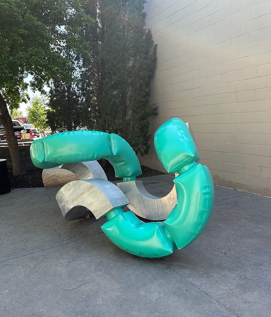

The final sculpture was painted in a distinctive teal that ties back to local manufacturing – specifically the iconic teal-green PVC pipe seen throughout the region – and echoes the movement of water central to pivot irrigation systems. The zinc finish also contributed to the sculpture’s visual composition, adding a bright, reflective base that countered the bold teal and emphasized the dimensionality of the inflated forms. With a footprint of roughly 5 feet by 5 feet and a length of 10.5 feet, Winder II is anchored with concealed hardware, creating the illusion that it floats lightly along the ground plane. Despite its delicate visual balance, the piece stands securely, its galvanized substrate guaranteeing long-term corrosion resistance and structural integrity.
