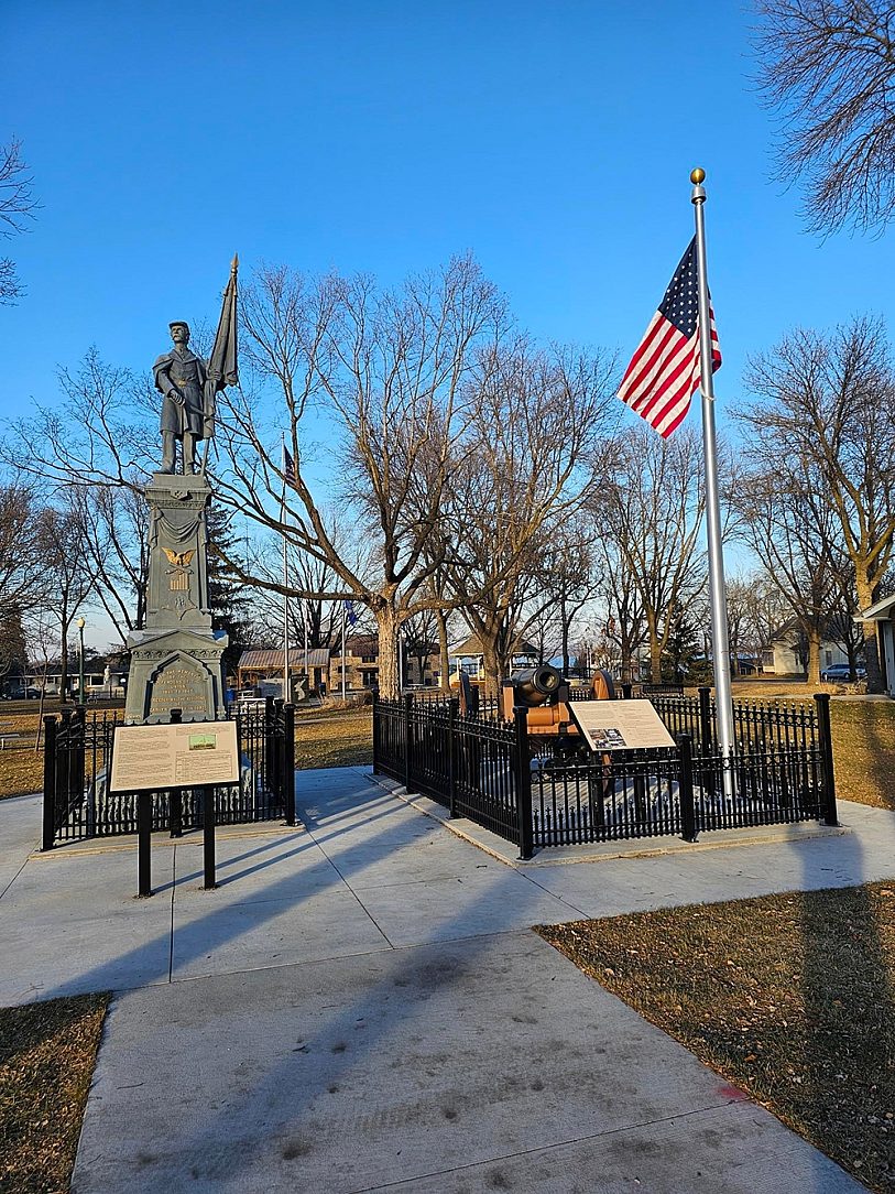

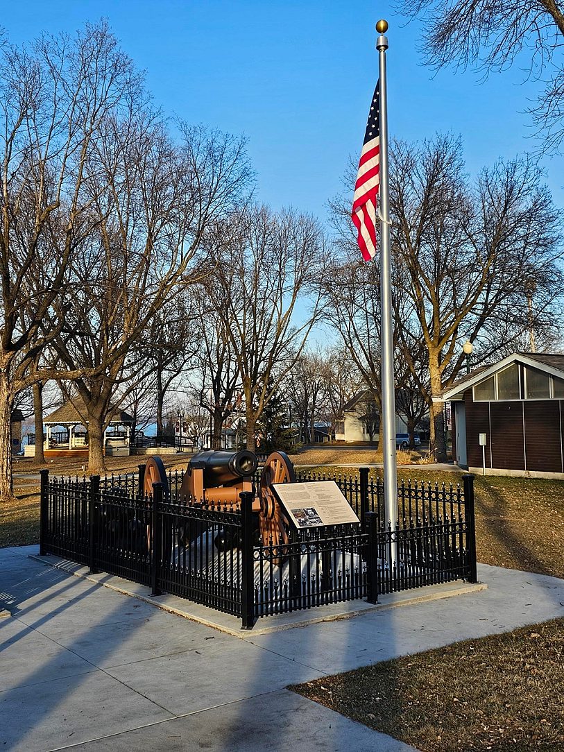

With restoration complete, and City Administrator Shane Fineran collaborated with a local fabricator for the fencing around these displays. Waconia, with its extensive miles of fencing, recognizes the durability and aesthetic appeal of a duplex coating. Hence, the choice for the perimeter was straightforward. The collaboration extended to Hecksel Machine in Watertown, Minnesota, a seasoned expert in galvanizing. They promptly commenced their role in the project.
Achieving a uniform coating on materials is crucial for obtaining a smooth and attractive finish after applying the duplex coating. Incomplete galvanizing or rough surfaces may occur due to trapped air pockets or insufficient drainage, emphasizing the importance of thorough application.
To address these challenges, specialized venting, handling processes and quality control measures are often employed in galvanizing facilities dealing with this type of project. Additionally, careful planning and technical expertise are essential to ensure the effective galvanizing in preparation for the duplex coating.
As part of the design process, the galvanizer recommended several design best practices to make the project a success. Additional holes were recommended (at optimal placement) to provide proper zinc drainage and a progressive dipping process was employed to accommodate the fencing.
Now completed, the city of Waconia warmly welcomes residents, employees, and veterans to the newly finished park at its center. It's a serene space for the community to pay respects to our lost soldiers. This heartfelt tribute is crafted to endure, offering decades of quiet reflection and enjoyment for everyone in town.
