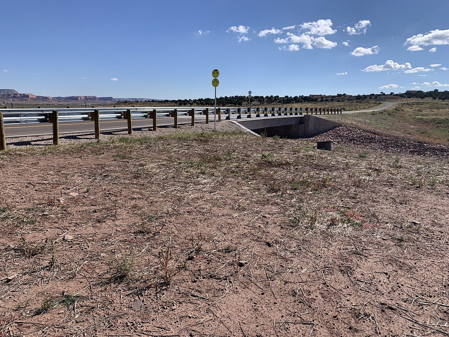

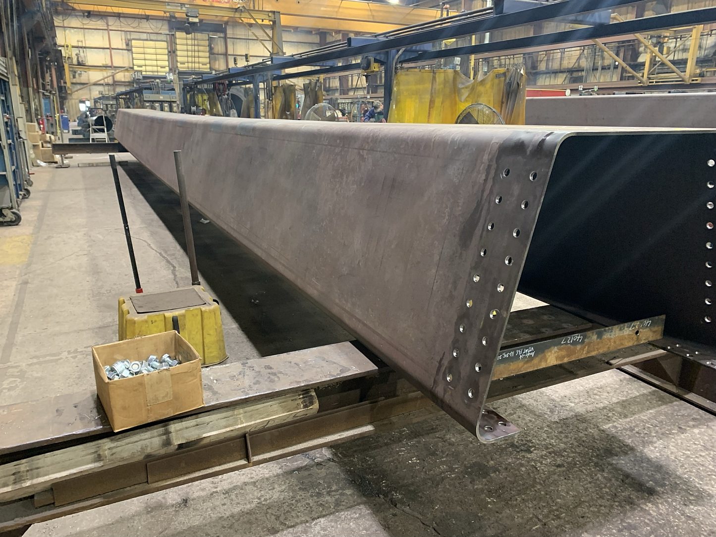

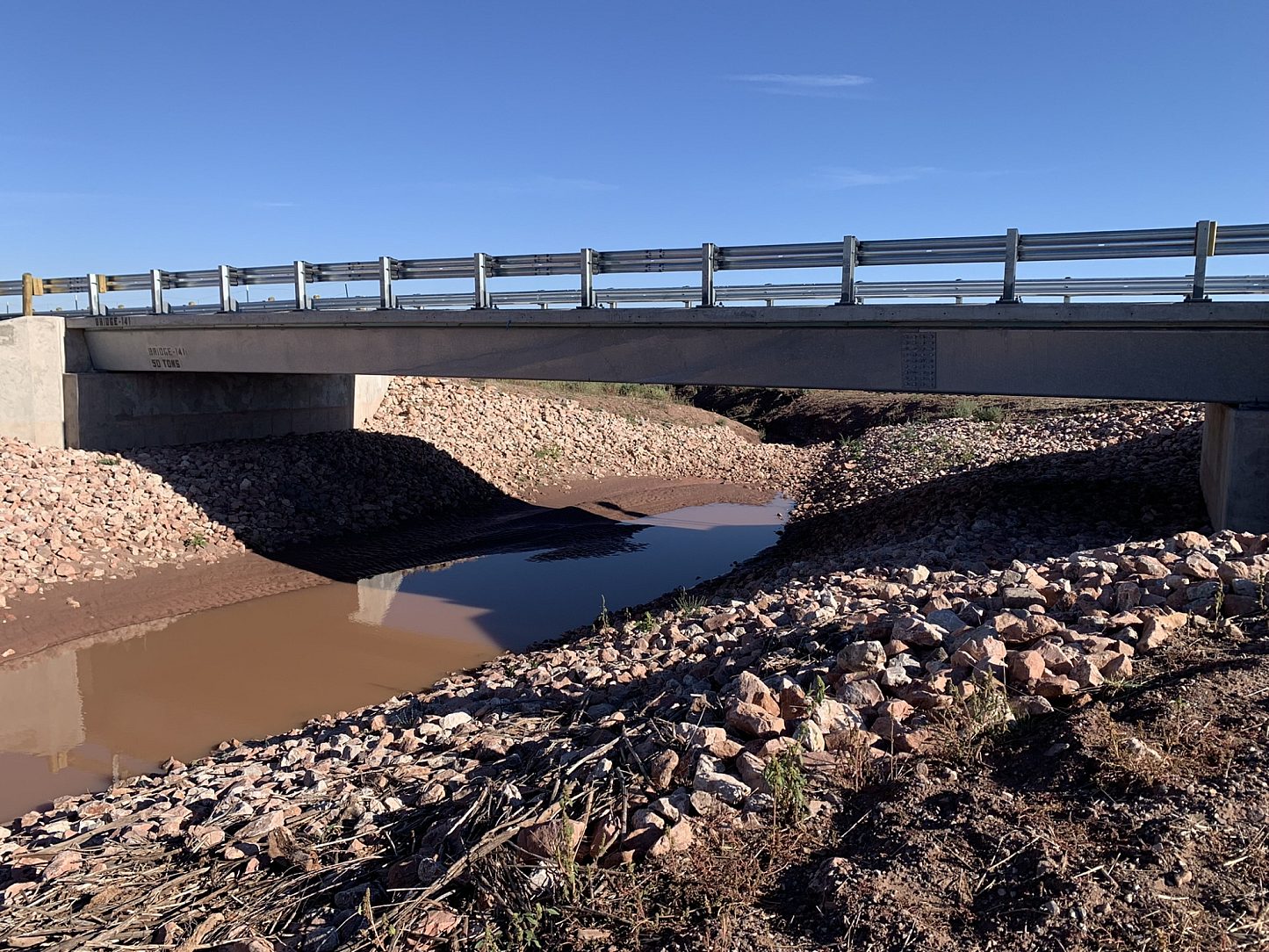

For the first bridge, the US Army Corps of Engineers originally specified a three-sided concrete arched culvert. When they learned about press-brake formed steel tub girders, they approached a well-known fabricator to learn more about the alternative option. When they found out the steel tub girder would not only increase hydraulic flow but also come at a lower cost, the decision was simple. By the end of 2020, Weldin Construction was under contract with USACE, and the design process commenced.

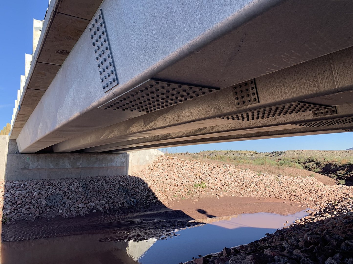

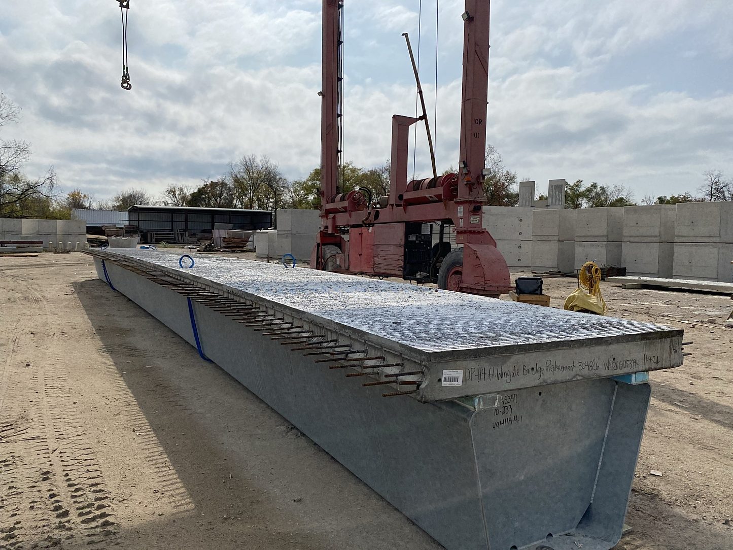

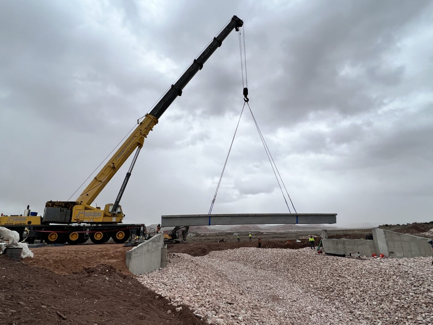

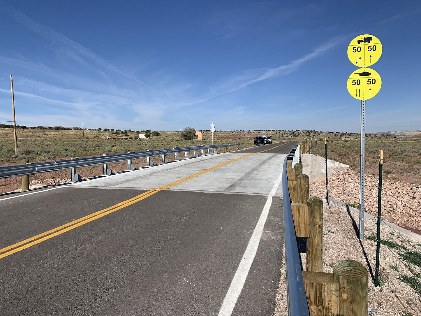

The 70’ span x 25’ wide bridge had to be designed to comply with NMDOT Standard Specifications, utilize NMDOT Standard Steel Railing, and accommodate MLC 50 (Military Class) tracked vehicles. After rigorous design review by LBTD Engineering and USACE, the U-BEAM™ press-brake-formed steel tub girder design was approved for fabrication. After fabrication and hot-dip galvanizing, the steel U-BEAMs were sent to Tricon Precast for the precast deck installation. The complete units were shipped to the installation site on April 11th, 2022, and due to the accelerated construction design, they were installed the following day.

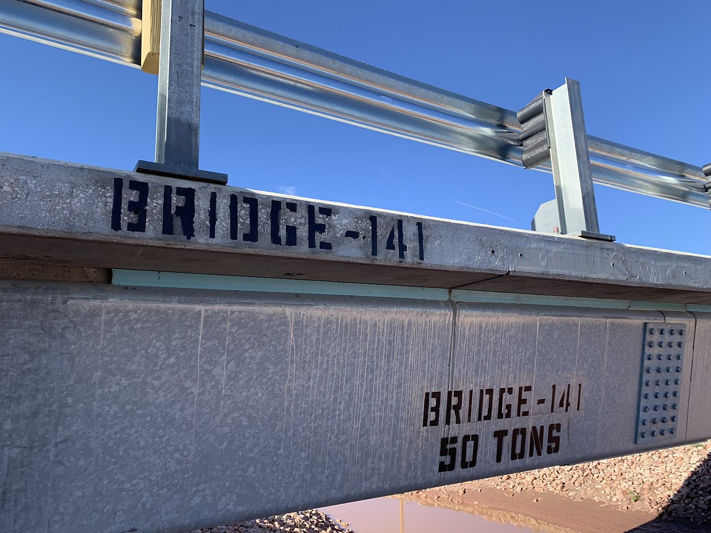

Hot-dip galvanizing is the finish specified for all U-BEAM™ Bridge projects. Although steel is a lighter construction material compared to concrete, it is susceptible to corrosion. This is especially concerning in infrastructure projects where safety is a top priority. The metallurgically-bonded zinc coating developed through hot-dip galvanizing provides extremely durable barrier protection that completely isolates the steel from the environment. Even if damage creates a void in the coating, zinc’s sacrificial properties will preferentially corrode to protect the underlying steel. Finally, after exposure to the environment’s wet and dry cycles, a patina develops on the surface to protect the zinc coating as well. These characteristics provide long-lasting protection that can extend product life by decades, and the U-BEAM™ boasts a 75-year expected lifespan on the hot-dip galvanized coating, plus additional service years on the underlying steel.

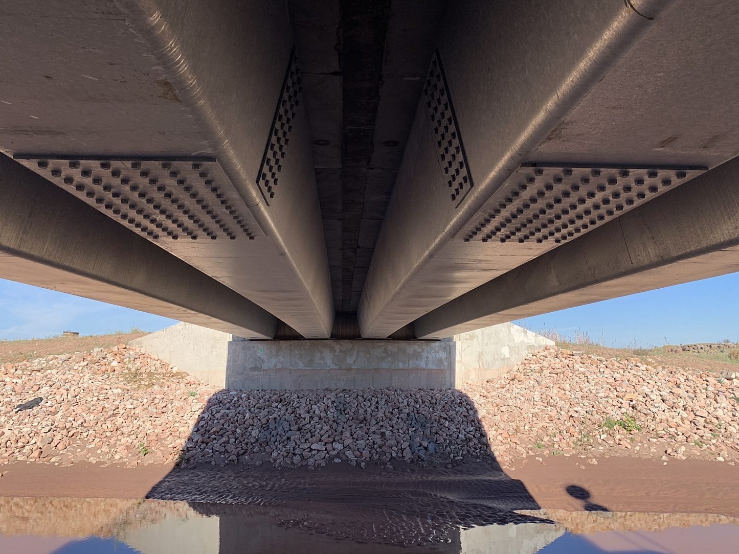

Press-Brake-Formed Steel Tub Girder: 8 Beams weighing 12,600 pounds each
