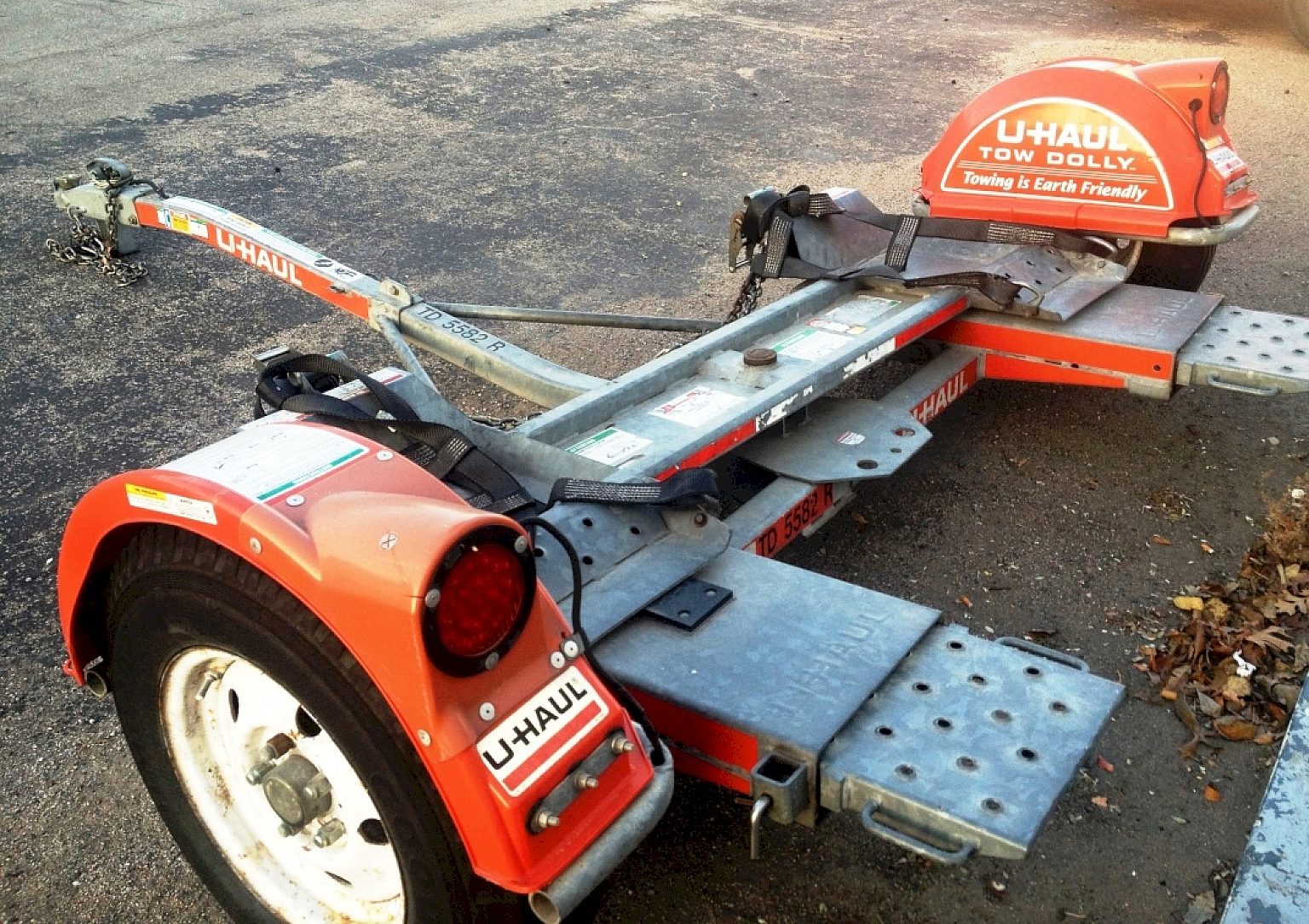

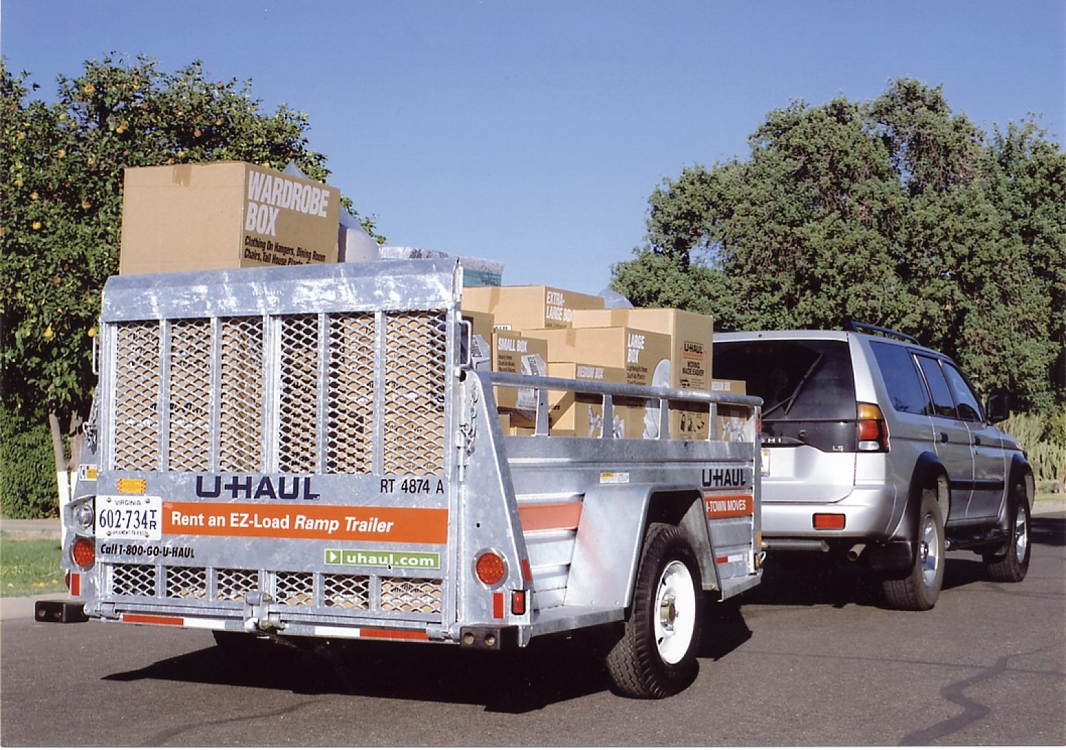

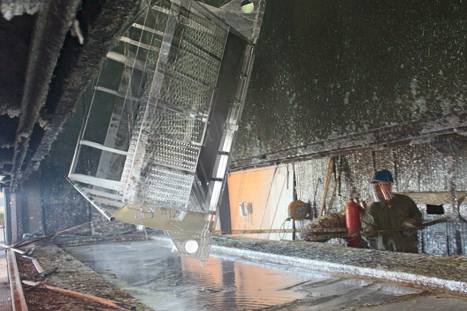

In 1995, HDG was introduced to U-Haul management who took great pride in the orange and black tradition that had made U-Haul famous. One of the first products to be galvanized was the auto tow-dolly. U-Haul engineers and the galvanizer worked hand in hand to create a design adaptable for the kettle. Venting and drainage, masking for axles and moving parts all had to be considered for the process. The famous U-Haul logo and warning information became decals. When the learning curve was complete, the dollies were a great success and it was time to move on to more U-Haul products. Auto Transport Trailers were next because they were subject to the harshest conditions such as road salts, abrasion from road materials, such as sand and gravel, and misuse from zealous end users. U-Haul acknowledges they cannot monitor the use of the product, but by using HDG, they know it is protected from corrosion. U-Haul officials replied,History has proven that. Since the HDG coating is harder than the steel itself, it became the perfect application. U-Haul is now dedicated to the use of HDG for any steel product that could be adapted to it. Open top trailers, truck bumpers and frames and the latest product, individual storage containers with HDG frames. U-Haul designers report, the galvanizer pushed us to design for quality galvanizing and we pushed back, together we reached the quality product we knew would be sustainable. Since HDG Steel is one of the most recycled products in the world, U-Haul trailers and trucks are giving back to support the push for a greener environment.

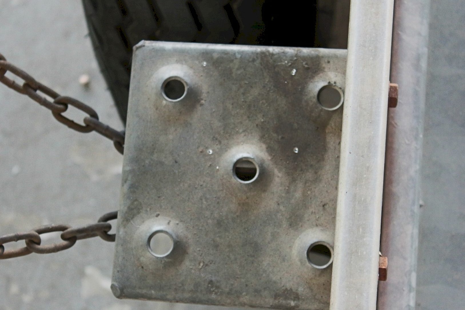

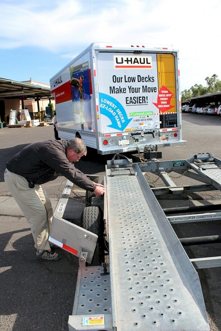

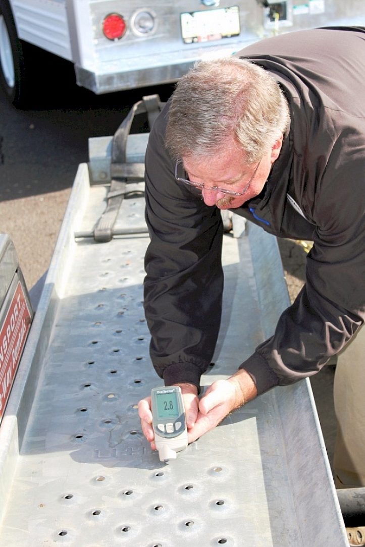

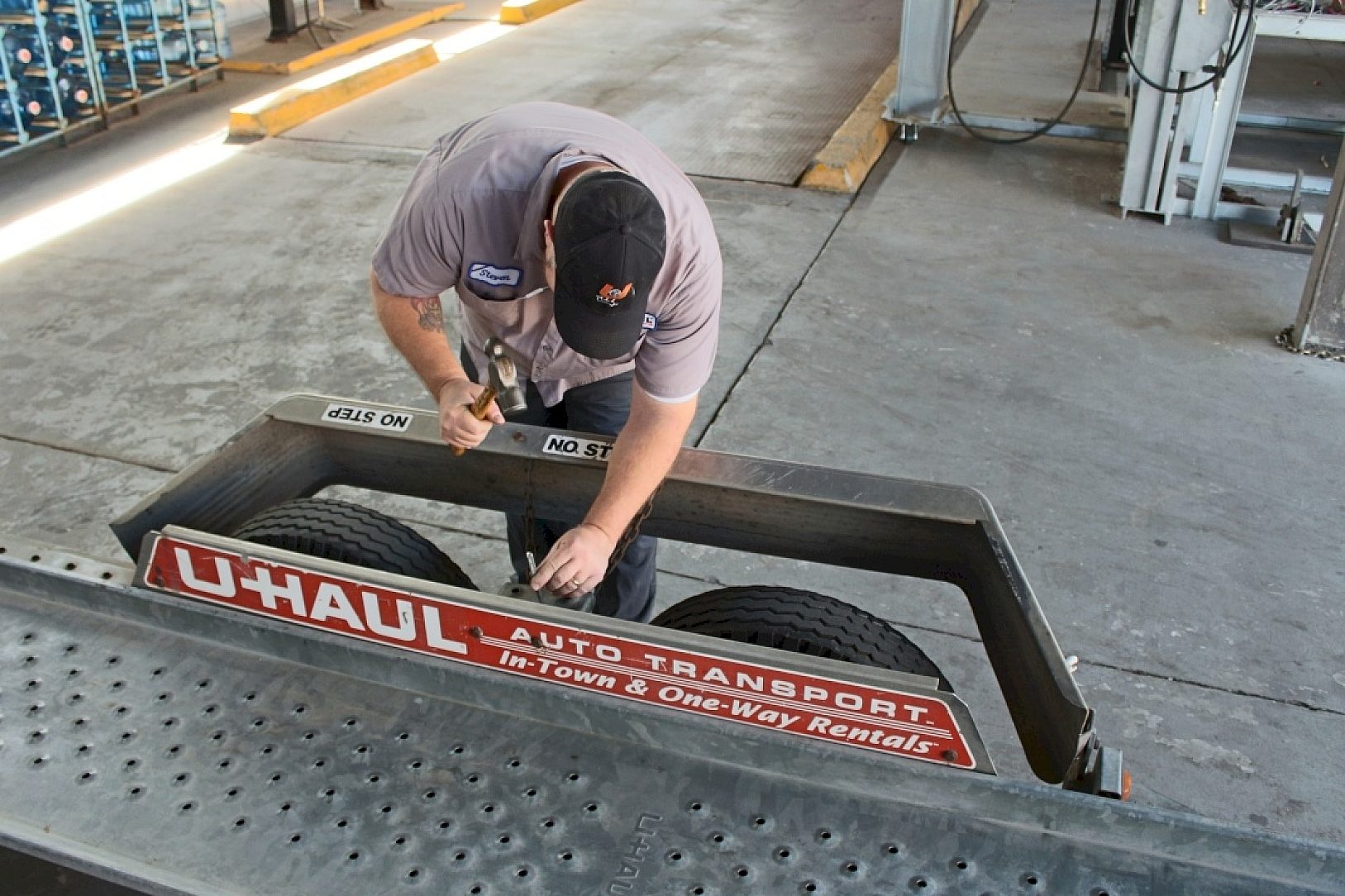

The case study for U-Haul products was performed in accordance with ASTM 896 using an auto transport trailer galvanized in 1996. The annual mileage for a typical U-Haul truck, trailer or tow dolly would travel around the earth 194 times per day, every day of the year. The unit studied has traveled to 31 states and has been subjected to rain, sleet snow, heat, road abrasiveness and normal use or misuse of the do-it-yourself mover. The test results indicated 3.5 mils of zinc remain on the trailer, and according to the Service Life Chart, the coating will have a service life of over 50 years.

| Tongue Tube | 2.70 | 2.60 | 2.70 | 3.00 | 2.80 | 2.60 |
| Cross Channel | 8.60 | 8.40 | 8.00 | 9.20 | 9.30 | 8.10 |
| Tire Platform | 2.30 | 2.30 | 2.40 | 2.10 | 2.30 | 2.30 |
| Car Tire Tread Plate | 2.80 | 3.10 | 2.90 | 3.40 | 3.00 | 3.00 |
| Rear Tire Rail | 2.40 | 2.50 | 3.00 | 2.80 | 2.60 | 2.60 |
| Left Rear Step | 3.00 | 2.80 | 3.70 | 3.00 | 2.50 | 3.00 |
| Left Fender under chain support | 3.30 | 3.30 | 3.00 | 3.30 | 3.10 | 3.20 |
| Rear Indicator Light Housing | 3.50 | 3.50 | 4.10 | 3.70 | 3.40 | 3.60 |
| Right Ramp (Moving Part) | 2.80 | 2.80 | 3.00 | 3.00 | 2.80 | 2.90 |
| Right Front Channel (Moving part) | 3.30 | 3.00 | 3.10 | 3.20 | 3.40 | 3.20 |

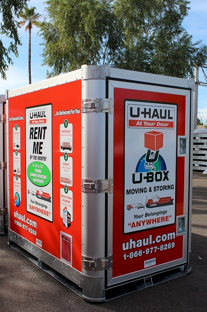

Tow dollies, open top trailers, truck bumpers, and frames. Auto transport trailers. Self-storage boxes.
