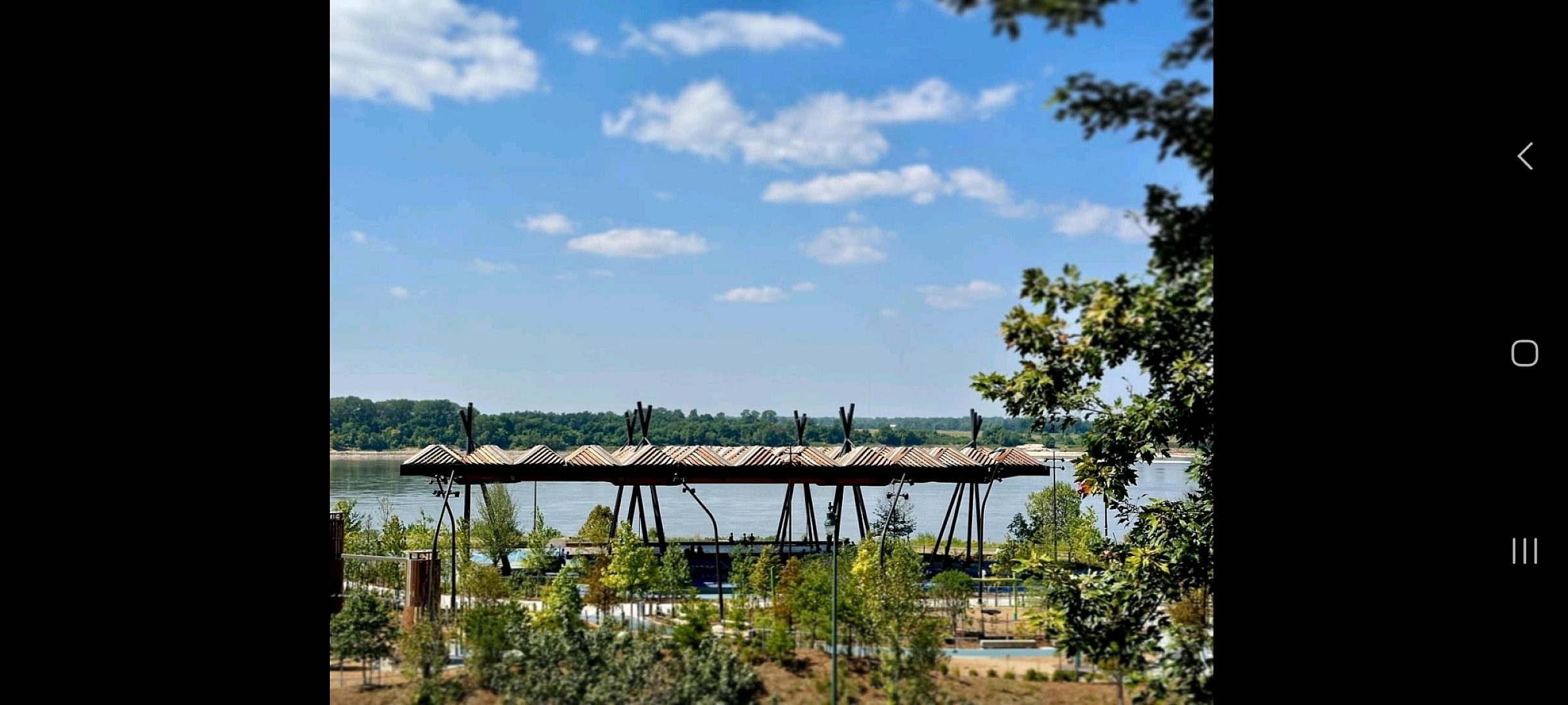

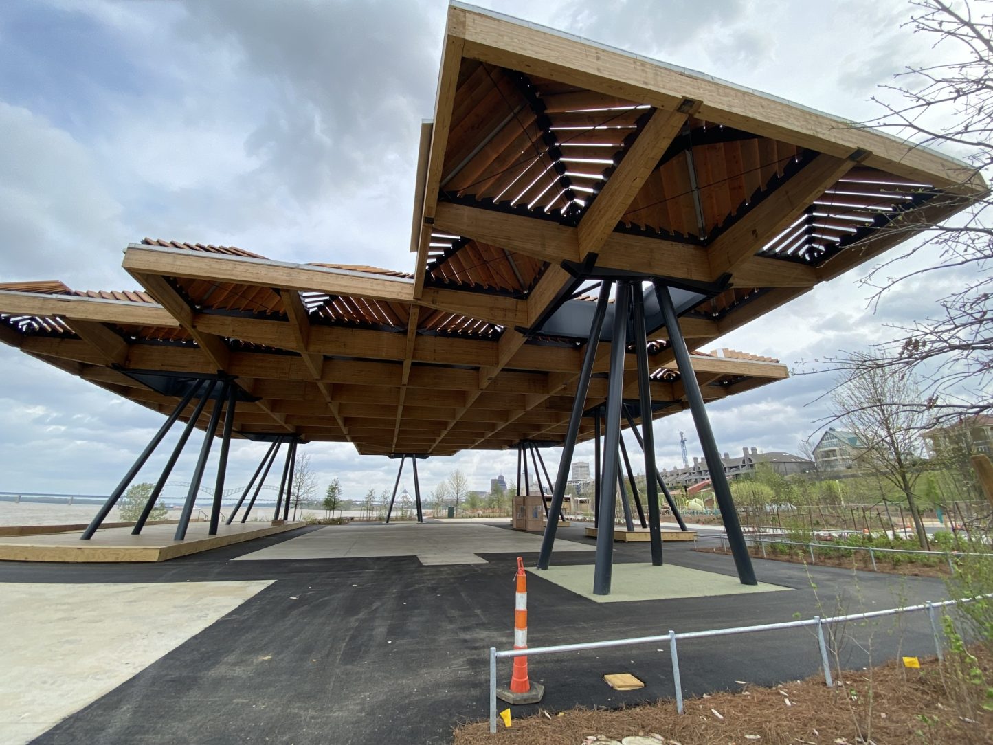

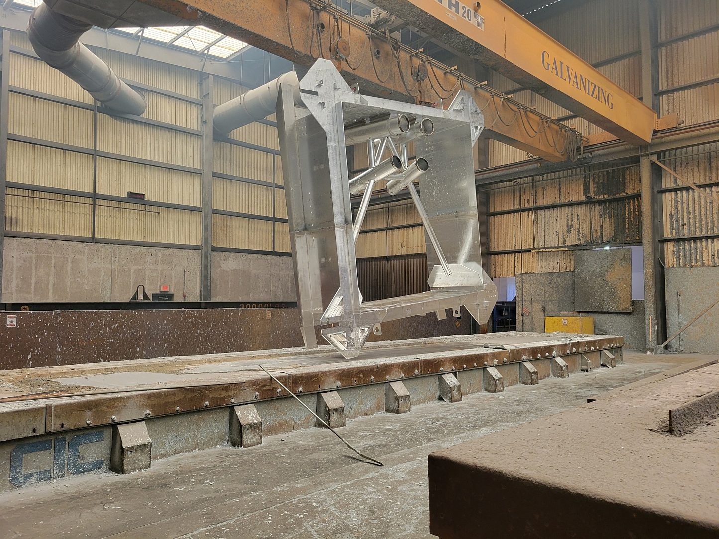

The Tom Lee Park Sunset Canopy framing features box frames measuring 6’0”x18’0”x18’0” housing a complex “Teepee” pipe column splice. A duplex system of hot-dip galvanizing and wet paint was specified for this project due to the coating durability, corrosion performance, and overall appearance. Early in the project Grinder Fabricating & Erection, Inc. decided they wanted to maximize the frame size with the internal pipe columns to aid the complicated erection process. They worked closely with the galvanizer over several meetings and reviewed several AGA design documents to make sure the hot-dip galvanizing would be successful.
