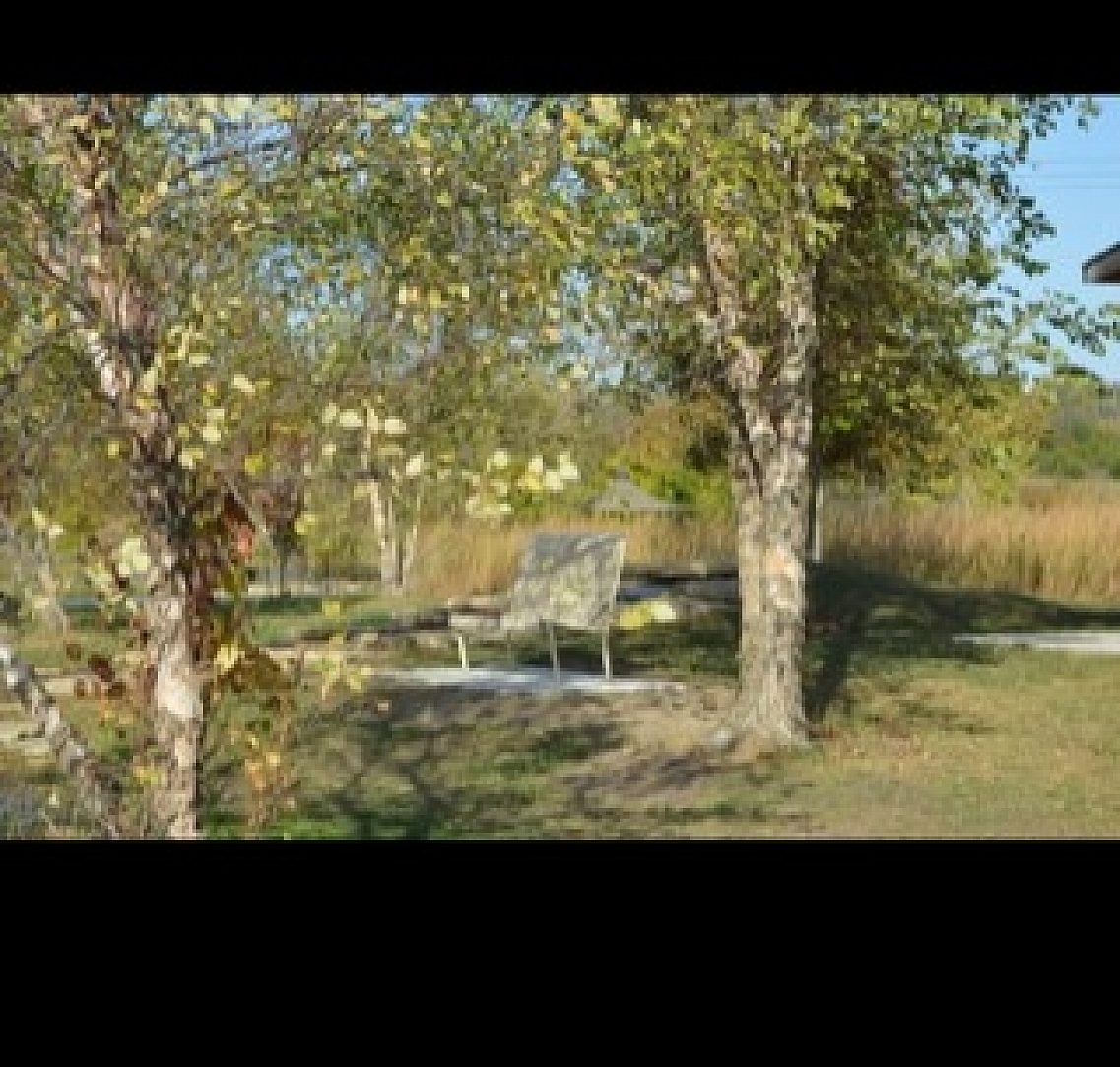

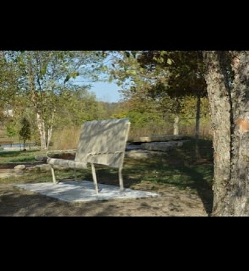

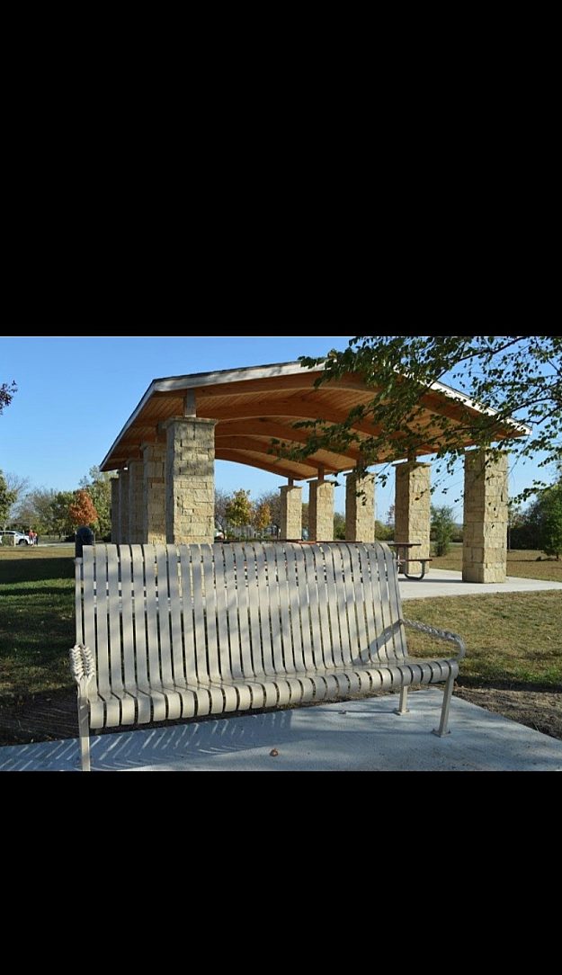

Since this was a memorial to his late wife, both Steve and Walt wanted this dedicated bench to last as close to forever as possible. Walt proposed galvanizing as he had experience with this process in the past and was aware of the longevity it would provide due to corrosion control. Steve wanted to add a little color to the piece so a powder coat was chosen by the end user to add a little pop to the memorial bench. Steve wanted the armrest to be braided solid steel which Kathy loved on a project Walt fabricated for them in the past. This braided armrest was a concern for Hot Dip Galvanizing due to its complex design but we were able to execute this without issue as we knew the powder coat would amplify any imperfections. This required the galvanizer to pay close attention to detail in the cleanup process as this was a significant piece for Steve. The combination of both Hot Dip Galvanizing and powder coating gave this bench a brilliant design for many park goers to enjoy for many years to come!

This bench was fabricated together with flat bar, pipe/tube and a decorative braided solid steel on the armrest.
