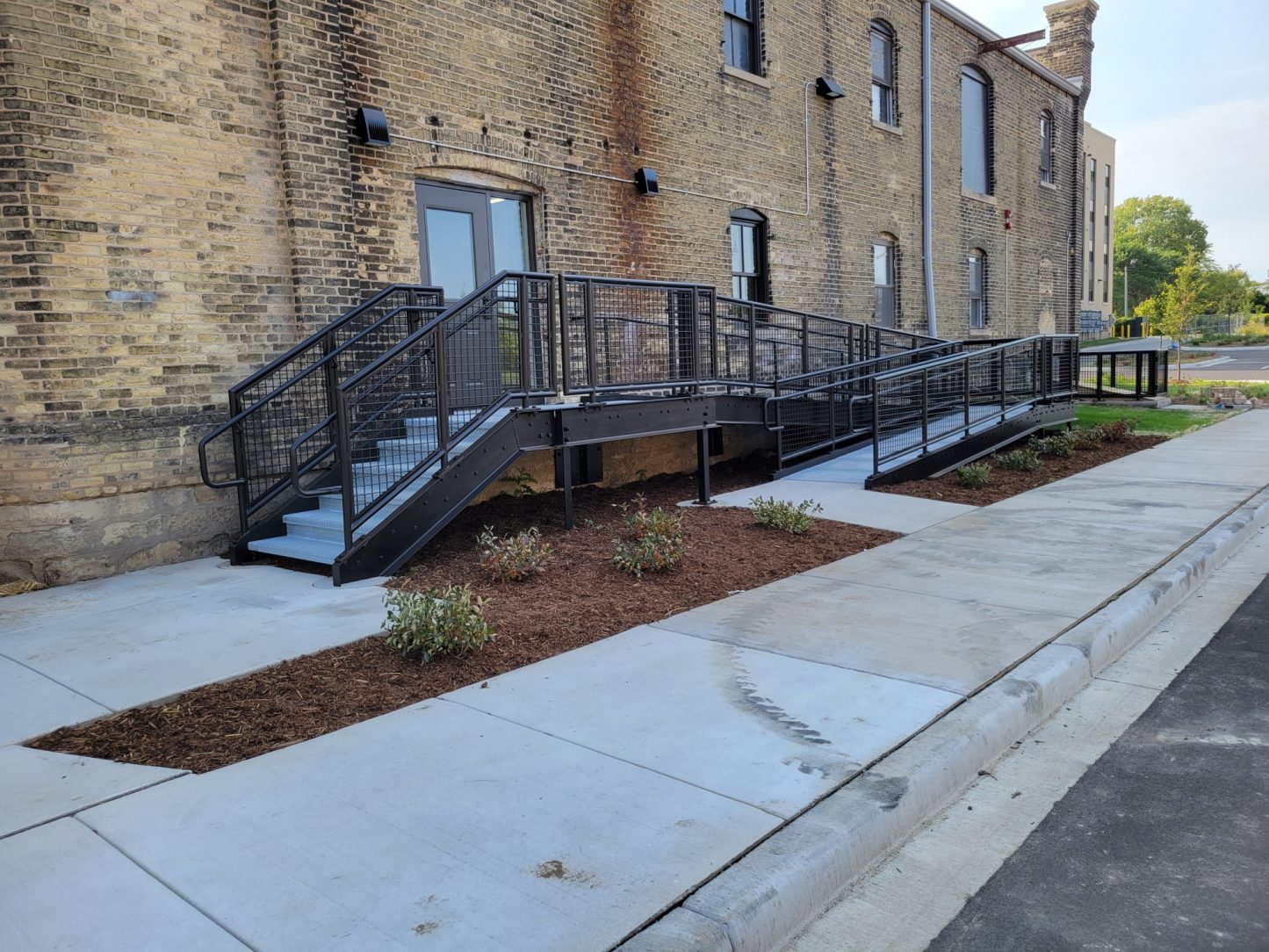

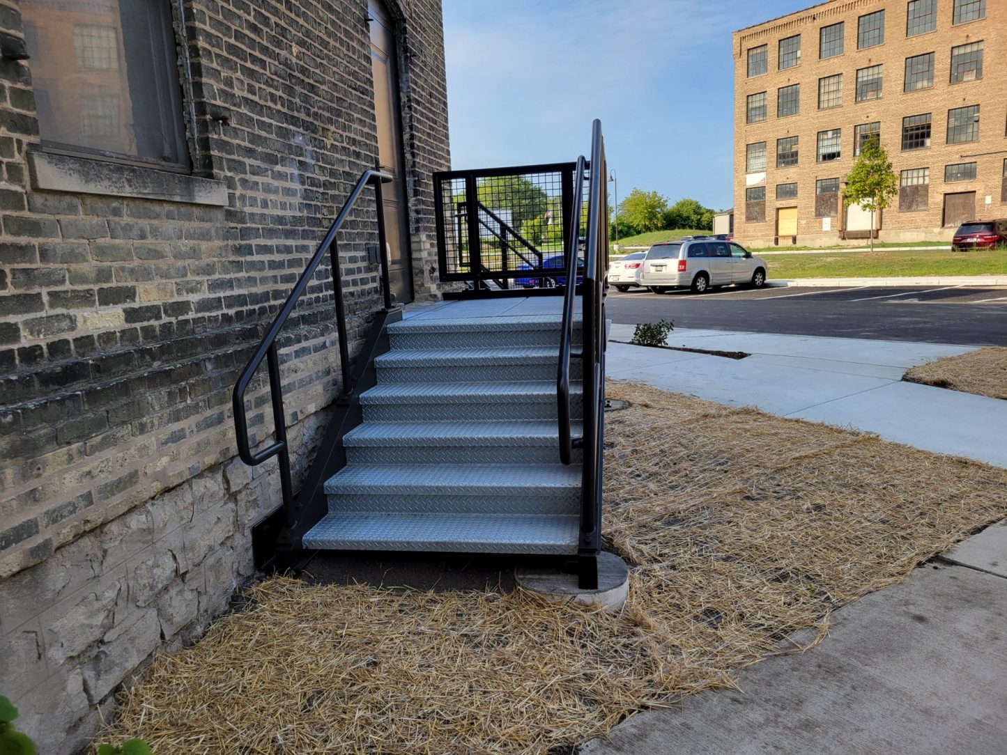

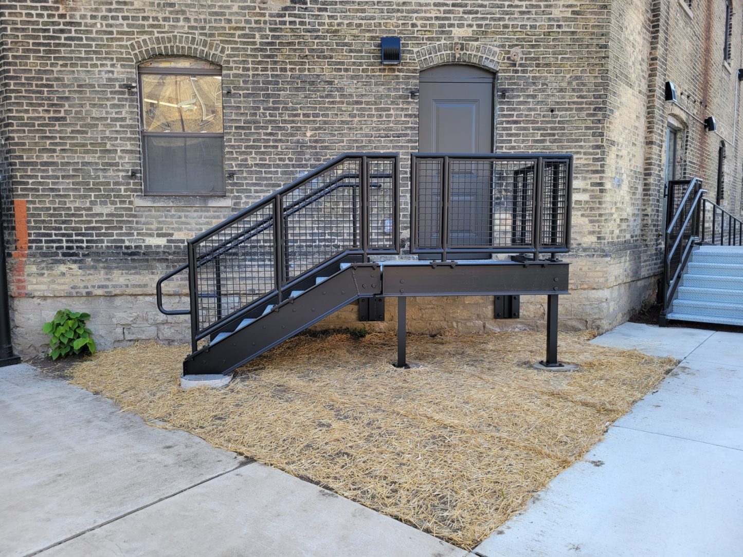

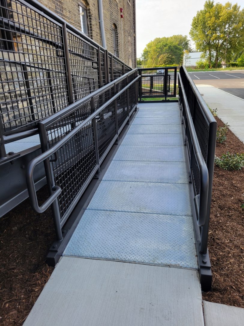

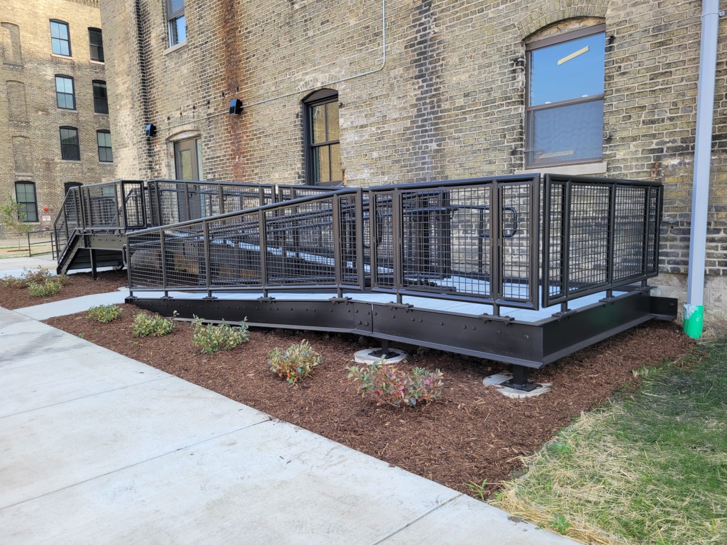

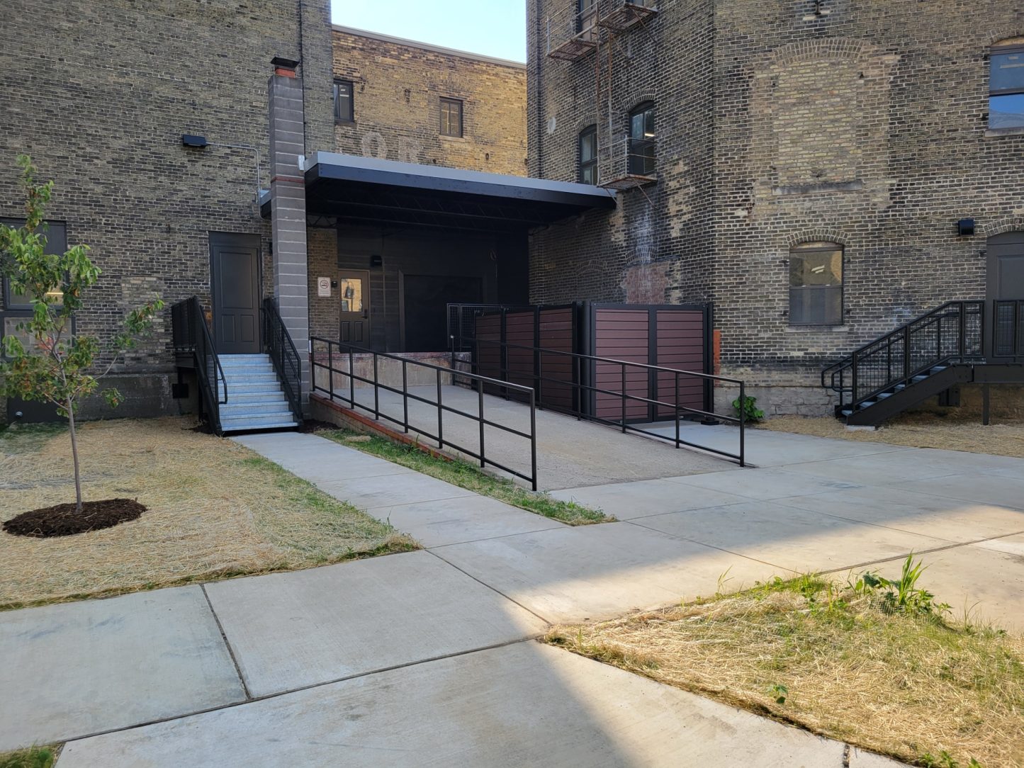

A standout feature of this project is the use of galvanized entry stairs and ramps. These elements were meticulously framed and then subjected to a multi-step finishing process to ensure durability and aesthetics. The framing was galvanized for long-term protection, followed by a brush blasting technique to clean the surface, then an epoxy primer was applied to ensure a strong bond for the final black finish. This finishing process is an example of a duplex system, which combines the protective benefits of galvanizing with an additional topcoat to enhance durability and aesthetics. The checker plate treads, which are integral to the stairs and ramps, were left in their galvanized state to preserve their industrial look and enhance the durability of these high-traffic areas. The combination of galvanized steel with a sleek black finish on the framing not only contributes to the building’s modern appeal but also nods to the project’s industrial roots, creating a unique fusion of old and new.

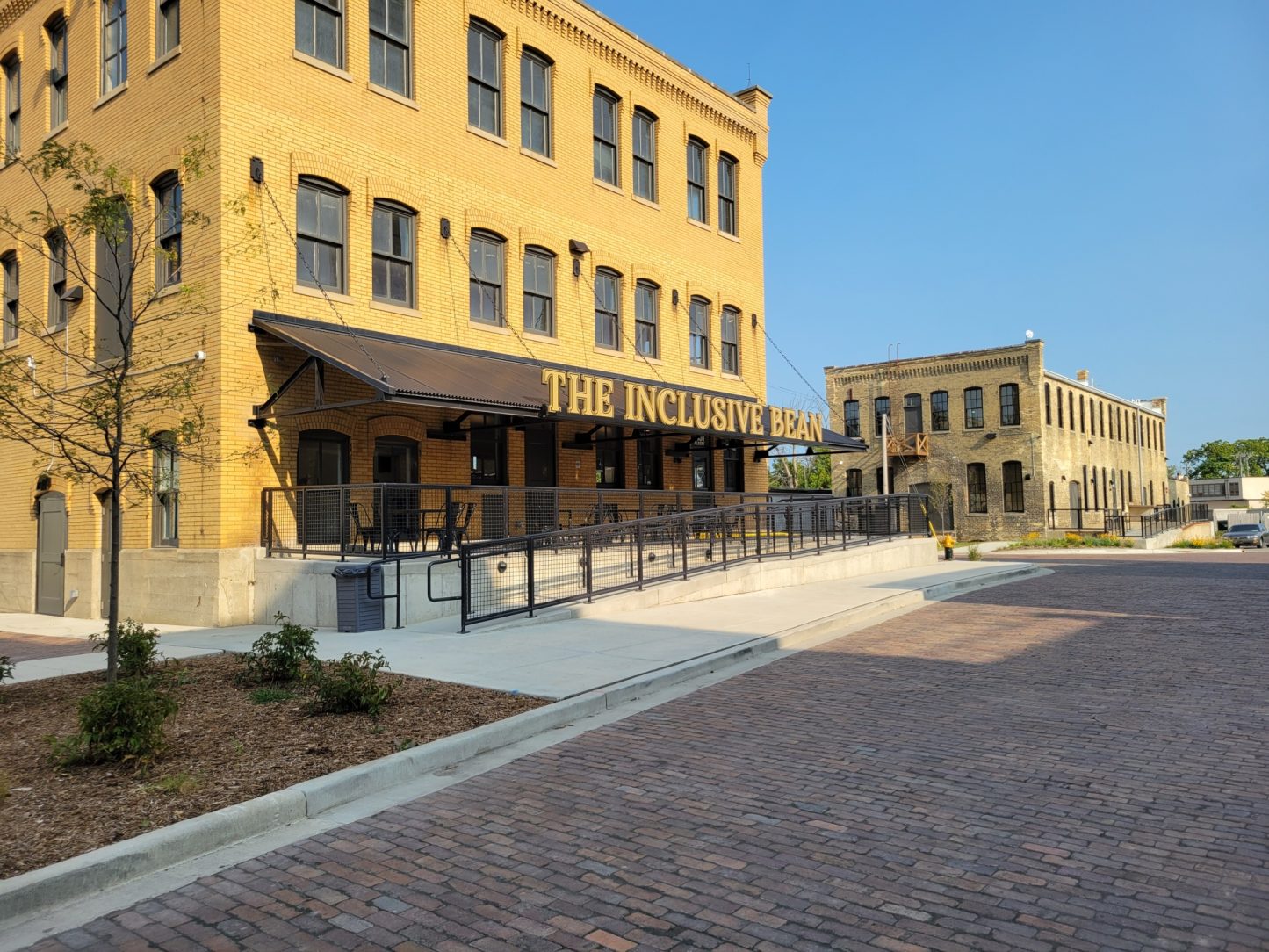

The Inclusive Bean, a non-profit coffee shop within the development, empowers individuals with disabilities by offering opportunities to build essential work and social skills, fostering greater independence. With accessibility at its core, the café features thoughtfully designed entrances, interiors, and galvanized ramps and stairs, ensuring a welcoming environment for everyone. By creating a diverse workforce and inclusive space, The Inclusive Bean exemplifies the project’s broader commitment to equity and functionality. Its dedication to accessibility underscores the development’s mission to support a community that is both inclusive and forward-thinking.

A standout feature of this project is the use of galvanized entry stairs, ramps, & handrails.
