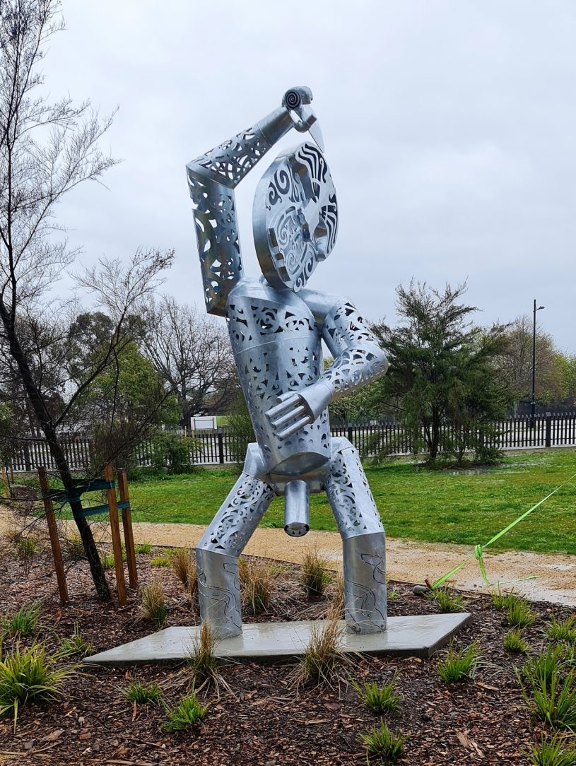

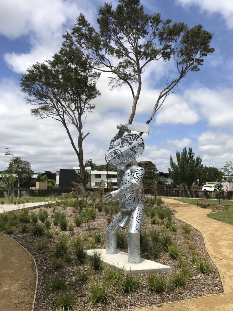

We hope the art piece will resist the elements for 100 years or more because of hot-dip galvanizing. It will enable the Rangitāne people to acknowledge their past while enjoying the present and teaching future generations about the story behind the design and their history at the site where the sculpture is erected.

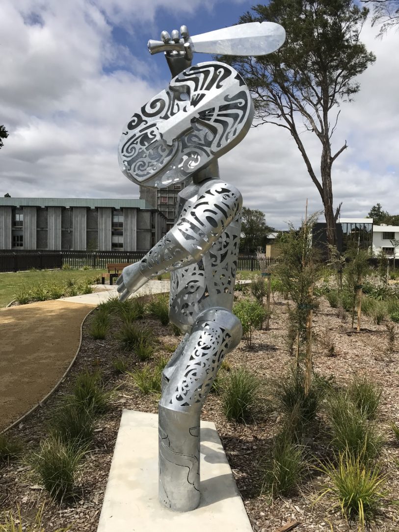

The tangata whenua (people of the land) with an 800+ year connection to Te Tapere Nui o Whatonga (Manawatū region) honor the battles fought by their ancestors with a new steel sculpture situated within a rohe (territory) where Rangitāne warriors trained in the arts of warfare. A Hokowhitu/Hokowhi Tumataenga is an ancestral military term meaning 140 warriors suitably trains in the arts of Tumataenga (the god of conflict and warfare) ready to undertake the defensive tasks required of them by their iwi. The new statue represents the strength and courage of these warriors while also standing as a symbol to aspire on-lookers to be the best self they can be.

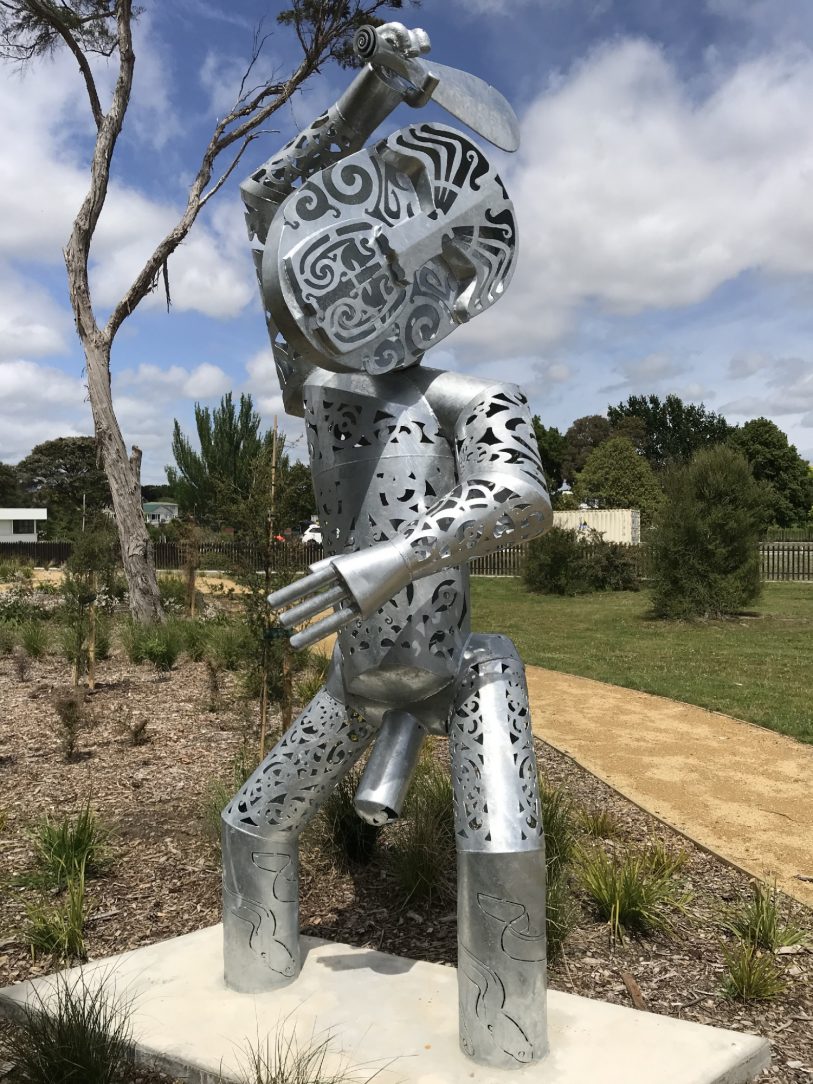

Typically, Iwi Māori sculptures are made with wood, stone and other solid materials; however, steel is growing in popularity for its flexibility in design. Due to the selection of steel for this project, the artist was able to add scale and internal carvings not normally possible when using other mediums. There are two internal figures fabricated into the art piece. A guardian figure in the head to support purity of thought and a second figure in the body to signify whakapapa (parentage) and chieftainship which is an important attribute for Rangitāne iwi males.
Although the selection of steel allowed the artist to incorporate unique and meaningful features, the team had to consider how to protect the final sculpture from the corrosive atmosphere. The salty sea air surrounding New Zealand can wreak havoc on steel that hasn’t been protected. Unsightly rust would be unacceptable on an important sculpture of this stature and it would not pay homage to the ‘Atua’ (God) it was named after. A local, highly reputable galvanizer taught the project team about the protective qualities of hot-dip galvanizing years ago when constructing the Whatonga sculpture and they determined it would be the best option for this sculpture as well. Longevity was the most sought after benefit; however, they also desired aesthetic look of silvered steel.
“We hope the art piece will resist the elements into the next 100 years or more because of hot-dip galvanizing. The contemporary hot-dip galvanized material will enable the Rangitāne people to acknowledge their past while enjoying the present and teaching future generations about the story behind the design and their history at the site where the sculpture is erected.”

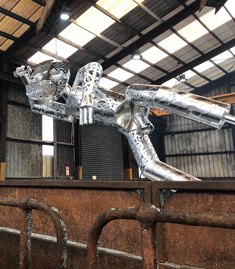

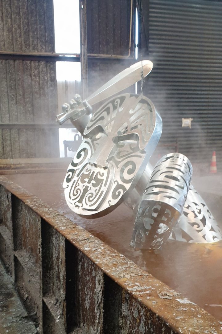

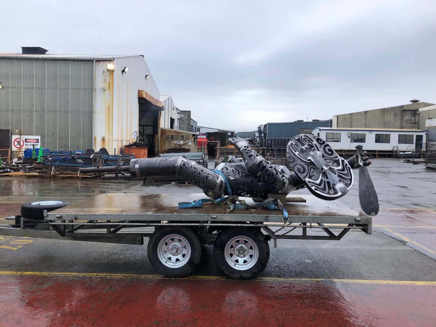

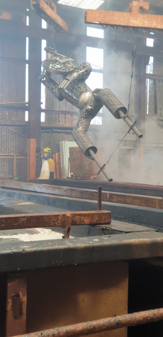

Hot-dip galvanizing offered a solution to corrosion control that enabled the project team to use a medium that could bring their vision to life. Communication between the artist, fabricator and galvanizer was important to ensure drain and vent holes were incorporated in to the design. All team members knew exactly how the item was going to be dipped before it even arrived at the galvanizer’s facility. Careful attention to the suspension of the sculpture during galvanizing was necessary to ensure all parts could be coated without creating air pockets or zinc traps. The extra effort was evident in the resulting finish quality. Hot-dip galvanizing will give lasting weather resistance to the sculpture for future generation to enjoy, and it will help the sculpture remain contemporary into the future.

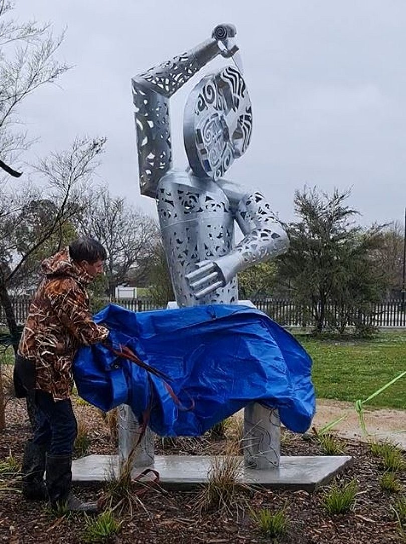

Owners of the Hokowhitu site commissioned this sculpture as a centerpiece for the first stage of a new urban dwelling development project. Artist Paul Horton collaborated with Chris Whaiapu- Rangitāne arts director, treaty settlement board member, and chair of Ngati Hineaute Hapu Authority, a fabricator, and a trusted local galvanizer to design and deliver the new sculpture named “Tane” honoring the Te Ao Māori Atua- Nga Ingoa o TANE (Tane of many names). Separating Papatuanuke (the earth mother) and Ranginui (the sky father), Tane is responsible for the terrestrial realm as the primary parent of forests and land animals. He is the bringer of light and knowledge to the world as one of the 142 elemental gods.
This name was chosen for the sculpture to encompass several realms of the Māori world view. The metaphysical being Tane the Atua of light and life; Tane, or Tanenuiarangi for Rangitāne, the tangata whenua; and Tane the man. The challenging pose or stance is to remind the males who look upon the sculpture to be the best person they can be for their whanau hapu and iwi (family), their roopu (community) but most importantly for themselves.
