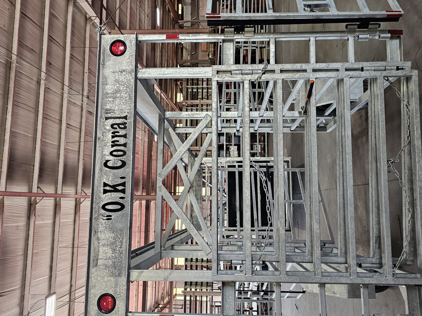

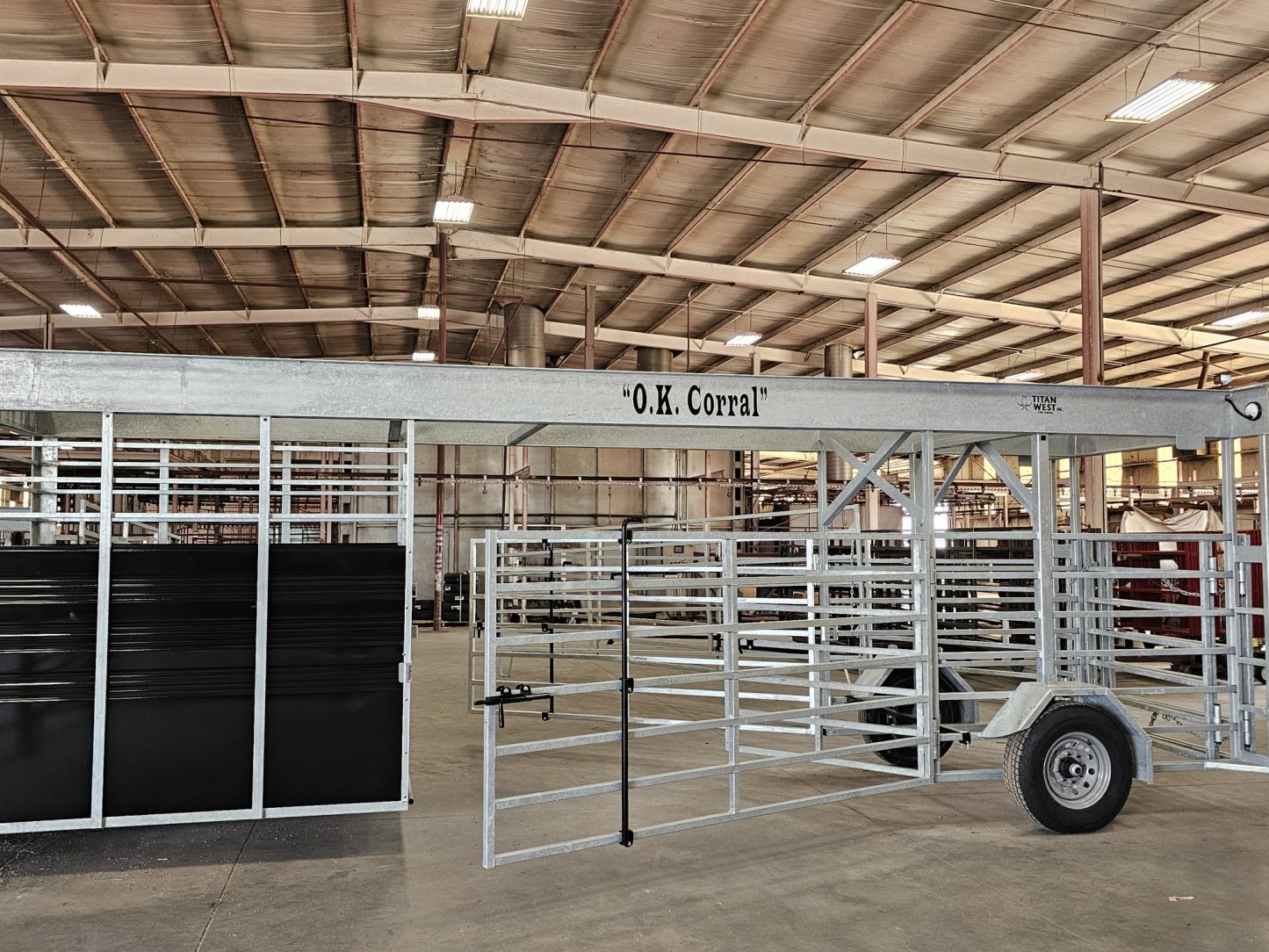

The team connected with a local galvanizer early in the process to ensure they could achieve a high-quality product. Not only was the galvanizer able to provide a large kettle capacity, but they offered technical guidance and support throughout the process. Through this collaboration, Titan West’s drafting, engineering, and R&D teams redesigned the entire frame, gates, and panels based on the galvanizer’s input. This included hole placement along the material for proper venting and draining while allowing the structures to be dipped as large, single assemblies.
