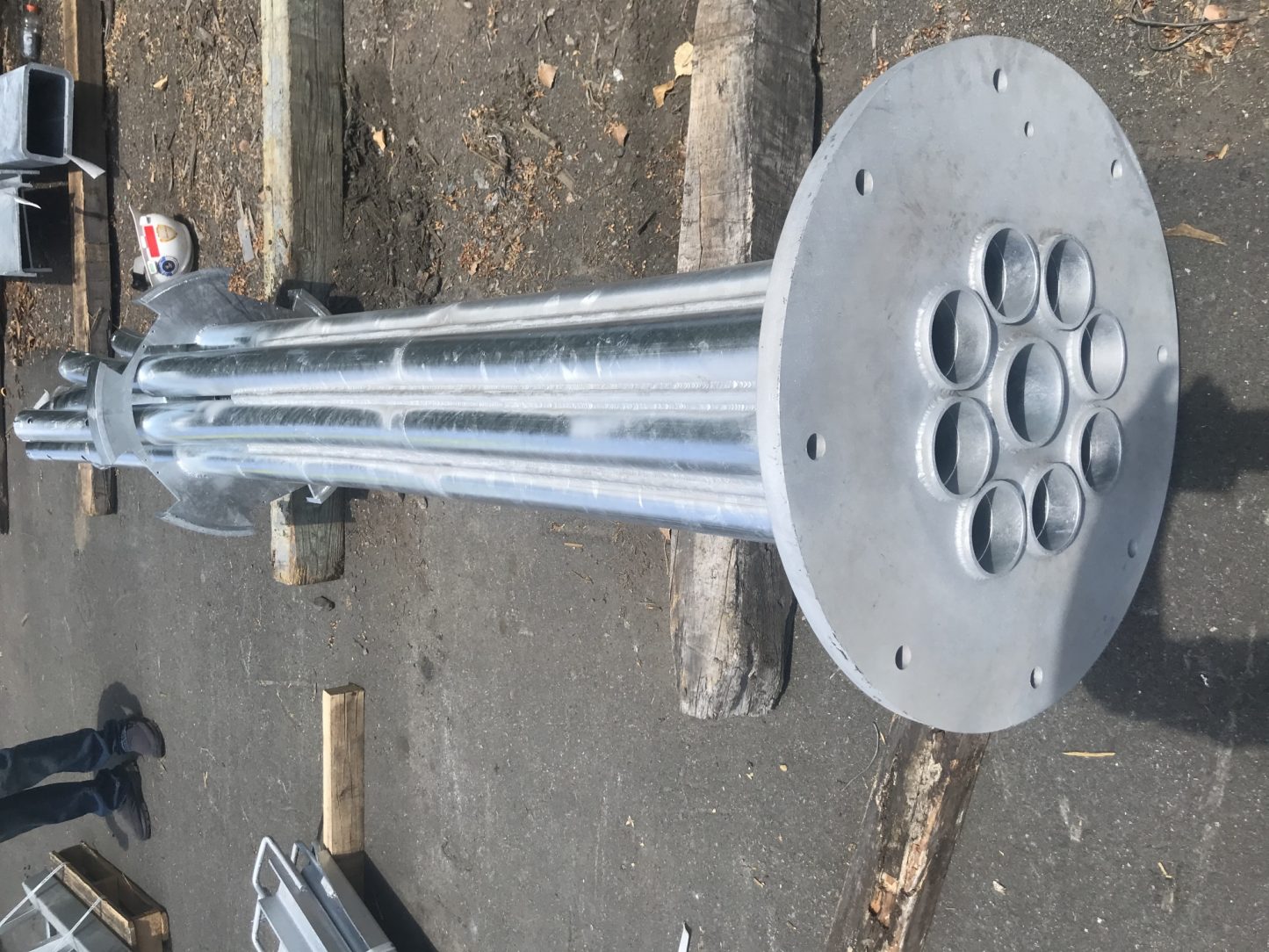

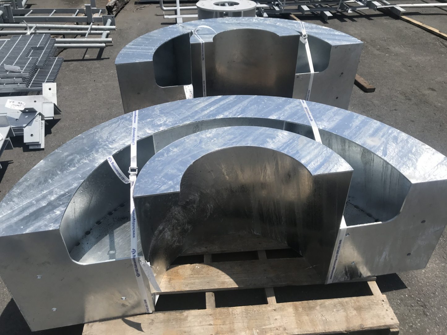

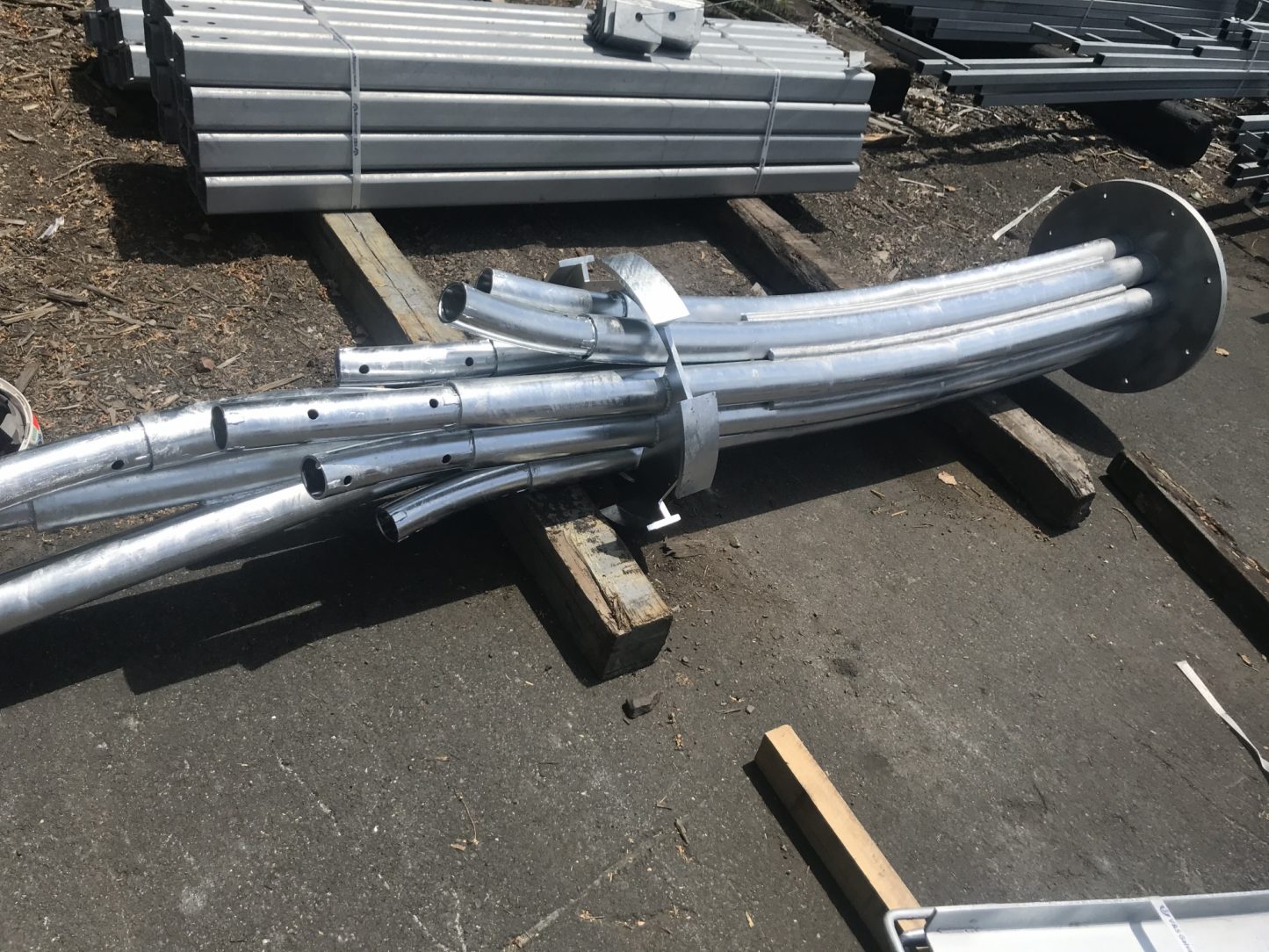

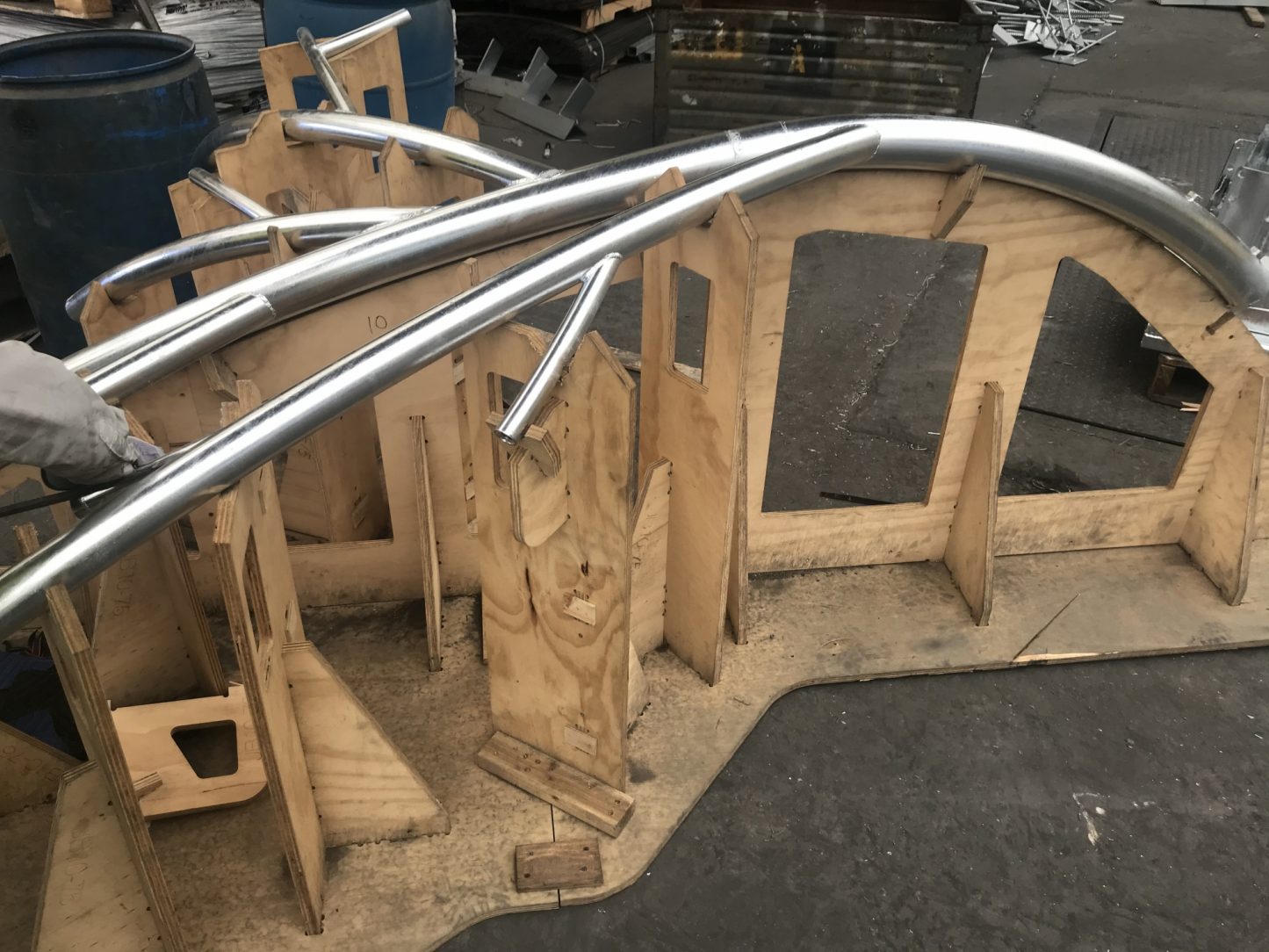

The fabrication work required complex fabrication and unique hot dip galvanizing dipping methods to craft the trunk and branches from A500 tubing. The work was then animated by 3.6 miles of Ethernet cable, fed through the branches, and fitted with individual speakers and lighting elements. UAP was engaged from the design development stage of this project through fabrication, galvanizing and installation.

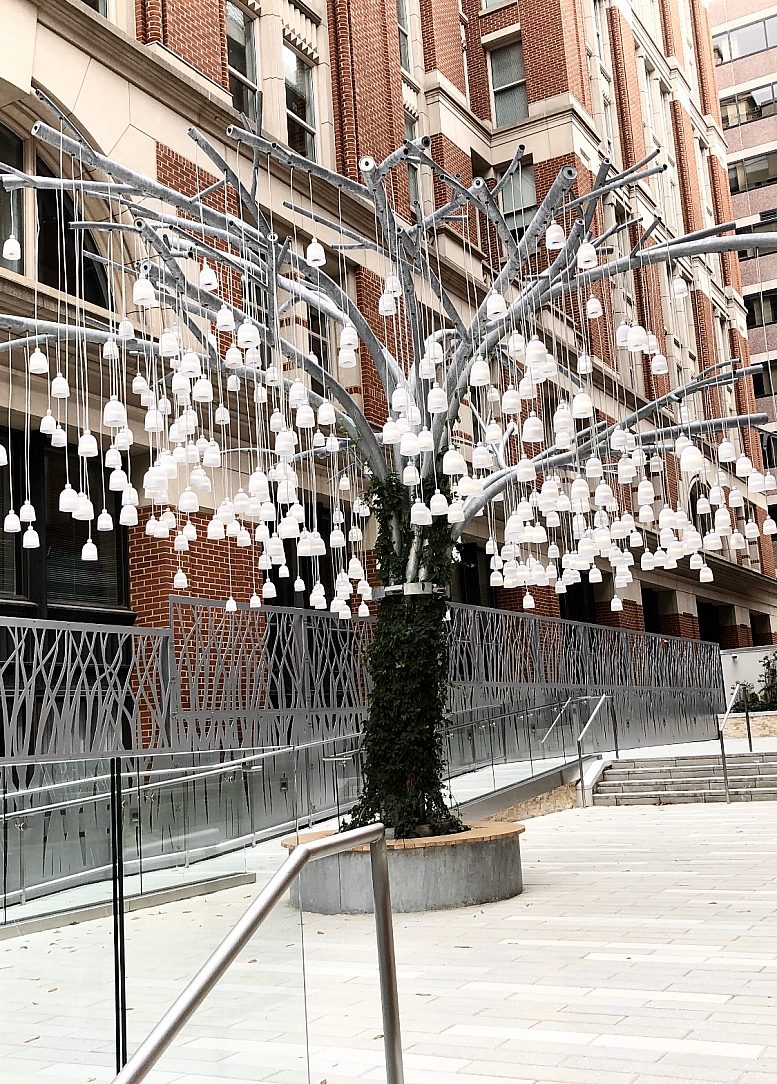

As visitors walk under the tree’s branches, the bell-shaped flower speakers, speaks 364 different languages recorded on a SD card that has been programmed with the different languages. When you walk around the Speaking Willow Tree it takes you a journey around the world of over 99% of the native tongues of the planet’s population
Located in Downtown Washington DC, the Speaking Willow Tree will be visible to millions of visitors throughout the year at the Planet World Museum courtyard. The galvanized steel used will provide decades of maintenance free corrosion protection that is crucial to protect the inside electrical components. The artist also chose to use galvanize the Speaking Willow Tree for aesthetic reasons to achieve a timeless look for years to come. All the light gage steel tubing members required a smooth finish, free of zinc build-up and smooth to the touch inside and out of each tree branch and truck, protecting it from visitors and the 3.6 miles Ethernet cable fed throughout the tree.

The trunk and branches of the tree made up of steel tubing and steel plates
