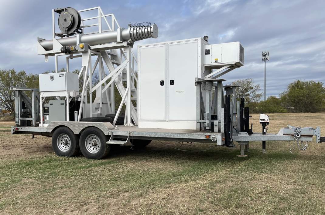

Combat Training Communication Trailer
San Antonio, TX United States | 2024

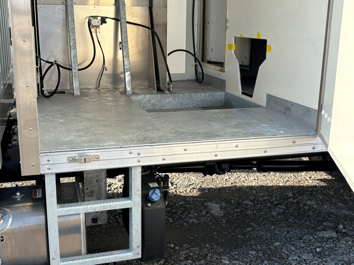

Shred-Tech's mobile shredding trucks are a familiar sight in communities nationwide, providing essential document destruction services. Unlike ordinary trucks, they face tougher challenges, such as constant vibration and stress from onboard shredding equipment, heavy payloads, and the added heat generated during shredding operations. By adopting HDG for the truck bodies, Allvan and Shred-Tech show their dedication to creating a durable, long-lasting solution capable of handling these demanding conditions.
The "rugged" yet clean look of the galvanized steel offers a distinct appearance that speaks to the durability and reliability of the service. The elimination of rust degradation, particularly in hard-to-reach areas, will maintain a positive visual presence in the communities these trucks serve, reflecting well on both the shredding company and the forward-thinking approach of Allvan. This project visibly demonstrates the advantages of HDG in a new, high-profile application, enhancing the overall community perception of galvanized steel.

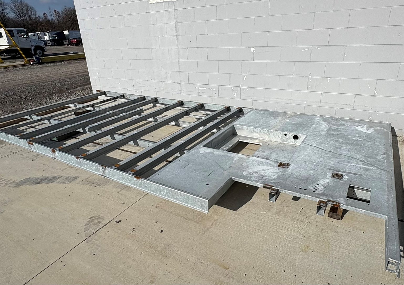

The initial cost analysis of transitioning to HDG proved its long-term financial benefits. While the original specifications from Shred-Tech initially presented a challenge due to the thin sheet metal, collaborative problem-solving between Allvan and their galvanizing partner resulted in a successful test run. Allvan was able to convince Shred-Tech that a slight increase in the weight of the sheet metal was necessary for a proper HDG finish, an important consideration for the overall success of the transition. By eliminating multiple layers of post-production painting and undercoating, the HDG process offers significant savings in labor, materials, and time. As Greg, the General Manager at Allvan, noted, "HDG requires some spot treatment touchups in areas degraded by welding. In general, HDG surface coating requires less effort and time during production." Moreover, the superior corrosion protection provided by HDG will drastically reduce maintenance costs and extend the service life of the trucks, resulting in substantial life-cycle cost savings. The increased lifespan of the truck bodies reduces the frequency of replacements, creating further cost savings for the customer and end-user.

Frame, Posts, Steps, & other trailer components
Steel: 3
HDG: 2
