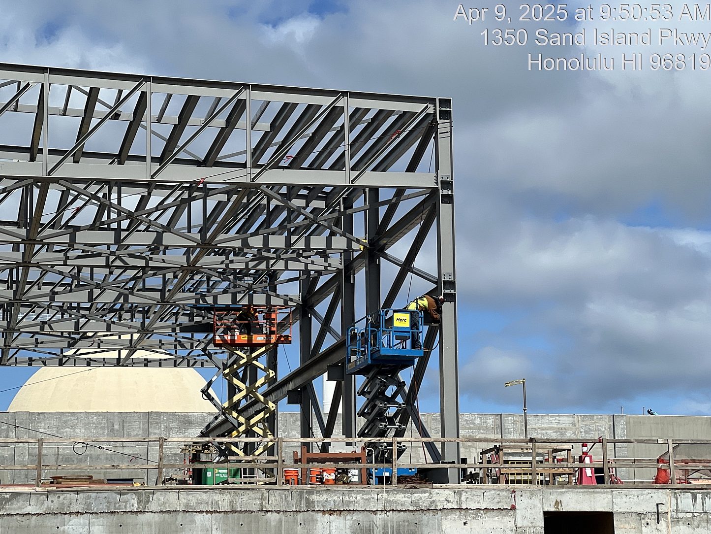

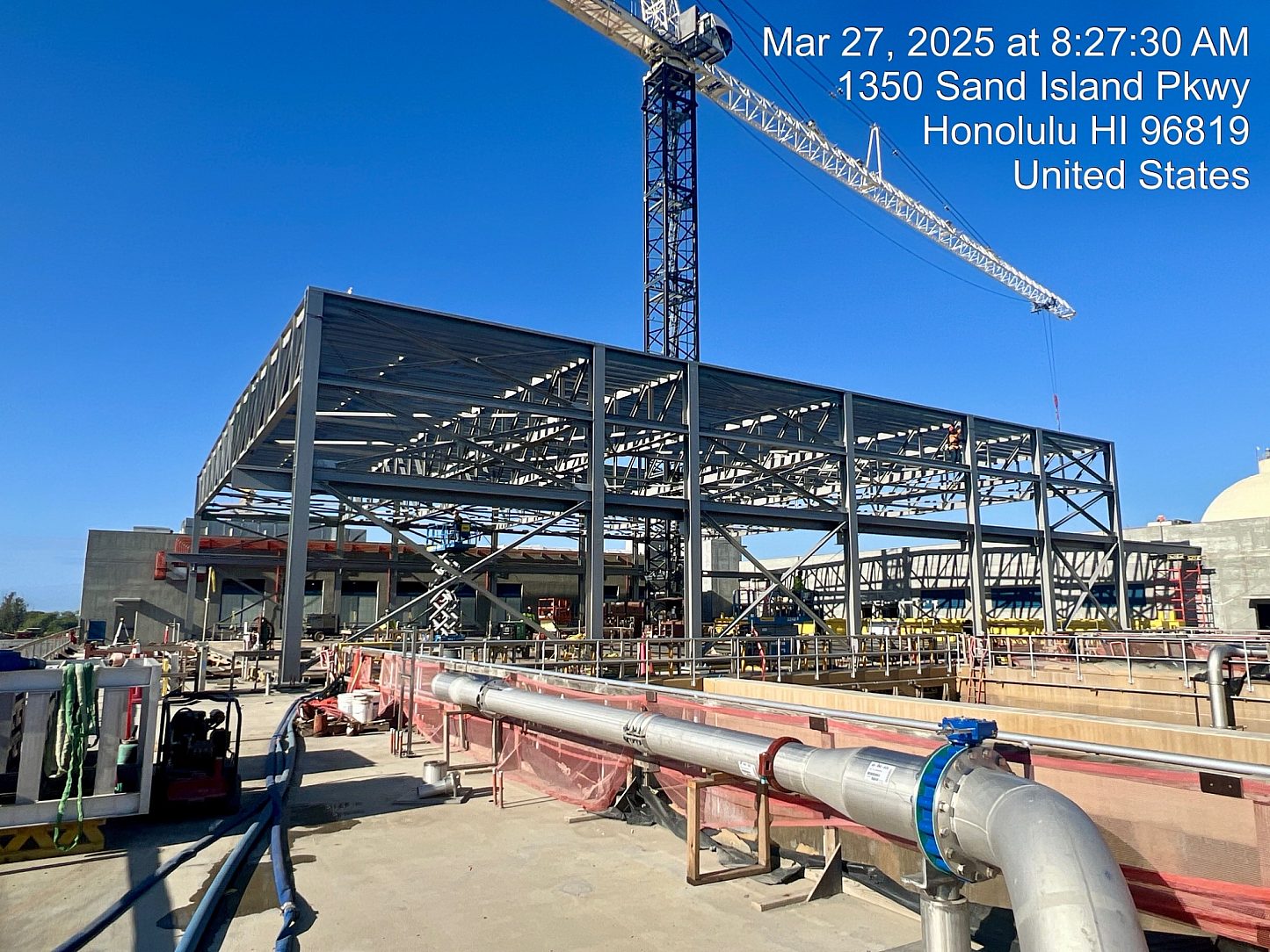

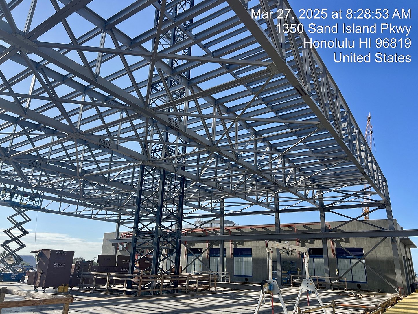

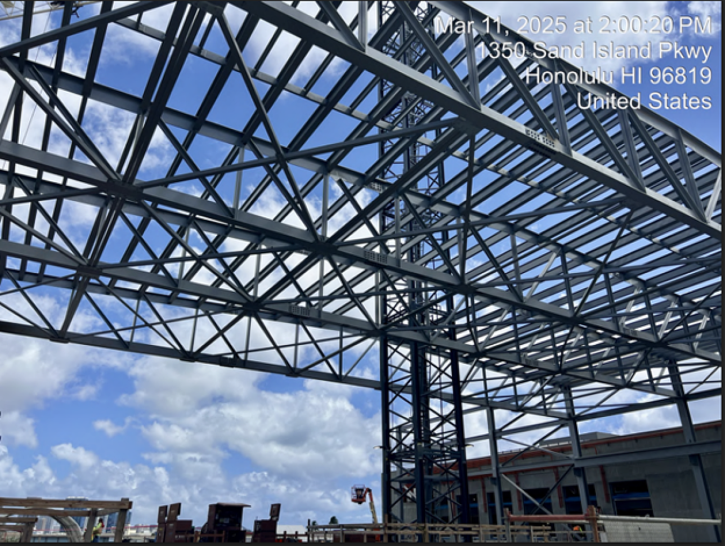

The fabricator supplied structural steel and miscellaneous metals for the Sand Island Wastewater Treatment Plant in Honolulu, Hawaii. One of the most significant fabrication and coating challenges involved the truss web members for the Membrane Bioreactor (MBR) Canopy. These trusses were designed with back-to-back angles that created a narrow interior gap, an area that could not be accessed for traditional blasting and painting. Recognizing this issue early in the process, the team collaborated closely with the design engineers to develop a coating strategy capable of fully wrapping and protecting the tight, enclosed space. The final solution utilized full hot-dip galvanizing, followed by a primer and topcoat system, ensuring long-term corrosion protection despite the geometry’s inherent inaccessibility.

The complexity of this project required extensive coordination across steel fabrication, coating applications, marine shipping logistics, and multi-phase construction activities—all while maintaining continuous operation of Hawaii’s largest wastewater treatment facility. The coastal location exposes structural steel to high humidity, salt air, and accelerated corrosion, making advanced protection essential. The multilayer corrosion-control strategy, consisting of hot-dip galvanizing followed by primer and topcoat, was selected to withstand these harsh environmental conditions and ensure complete coverage, even in areas that could not be prepared through conventional means. This approach also contributes to long-term cost effectiveness by minimizing maintenance requirements and extending the service life of the structural components.
