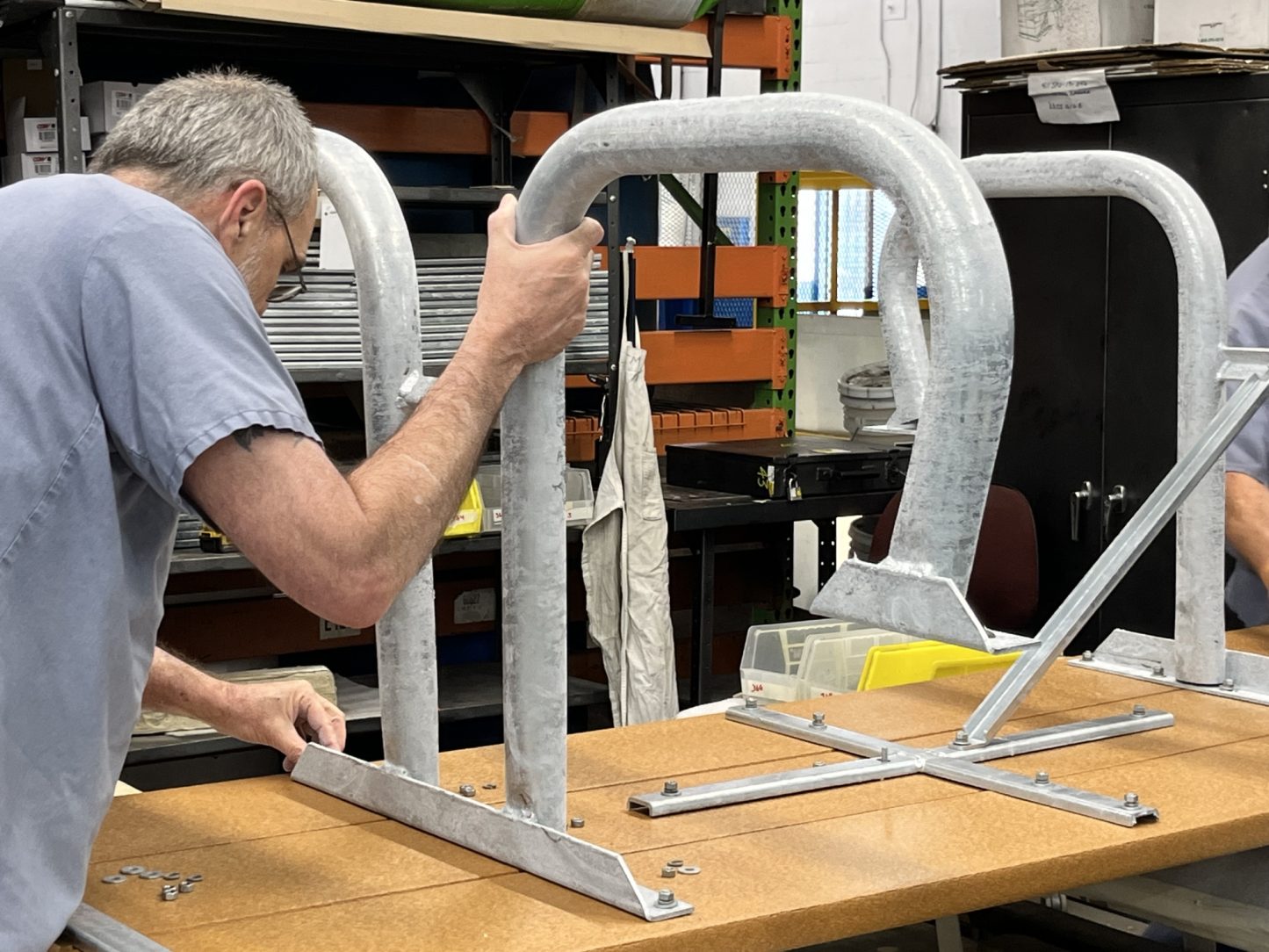

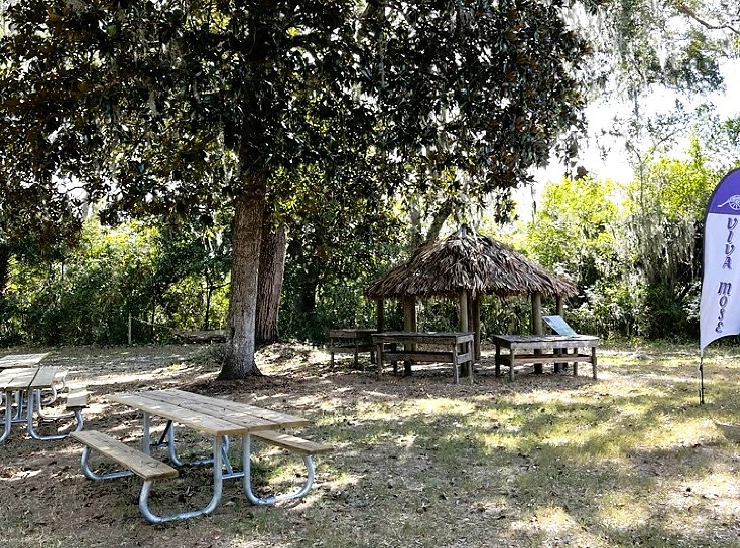

The frames and legs of PRI Enterprises’ picnic tables are fabricated from hollow structural steel tubing and then hot-dip galvanized before assembly. This process is critical for durability, especially in Florida’s harsh climate of heat, humidity, and salt spray. Hot-dip galvanizing ensures decades of maintenance-free use, offering superior corrosion protection compared to paint or other coatings - at a fraction of the cost.
Meeting ASTM A123 specifications requires strict adherence to ASTM A385 during fabrication. Success depends on superior customer service, meticulous attention to detail, and seamless communication between PRI Enterprises and its galvanizing partners. These standards guarantee that every product exceeds expectations and is delivered on time, every time.
