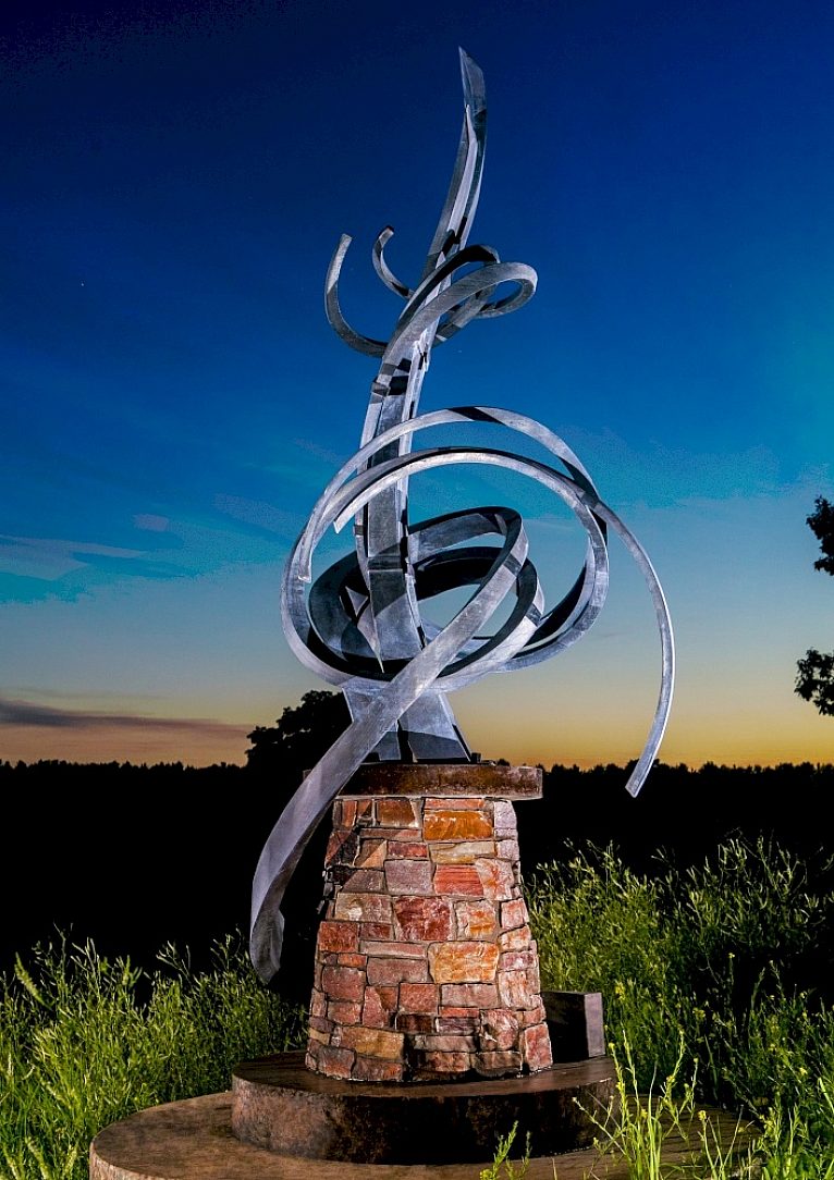

The end result? An amazing 14-ft. tall, 700-pound, one-of-a-kind piece of galvanized art that will last many years for future generations to enjoy.
The artist chosen was Michael Route. He displays his original iron pieces at his studio, Red Iron Studios based in Frederic, WI. Route says that during the design phase, his inspiration for this piece was buzzing bees.
His most difficult challenge was to determine how to meet the customers one requirement: the piece must not rust. Route was not familiar with hot-dip galvanizing (HDG). After some research, some phone calls and a visit to the galvanizing plant, he decided that galvanizing was the best solution to meet the customers anti-corrosion requirement.

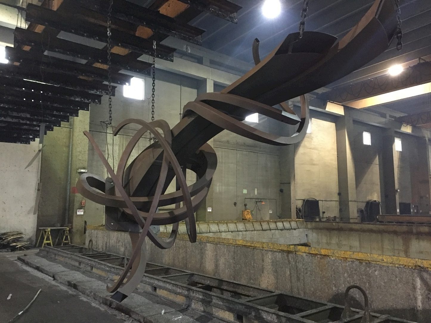

The next challenge Route faced was how to properly vent the piece to ensure the holes would allow proper galvanizing without affecting the artists vision. The curves and intertwining parts of this piece made it difficult. It was a joint effort between Route and the galvanizer to come up with a plan that met the needs of both parties.
When the piece was ready, Route brought it to the galvanizing plant and followed his creation through all stages of the galvanizing process. The end result? An amazing 14-ft. tall, 700-pound, one-of-a-kind piece of galvanized art that will last many years for future generations to enjoy.

The actual piece of art was galvanized, the stand which it sits was not.
