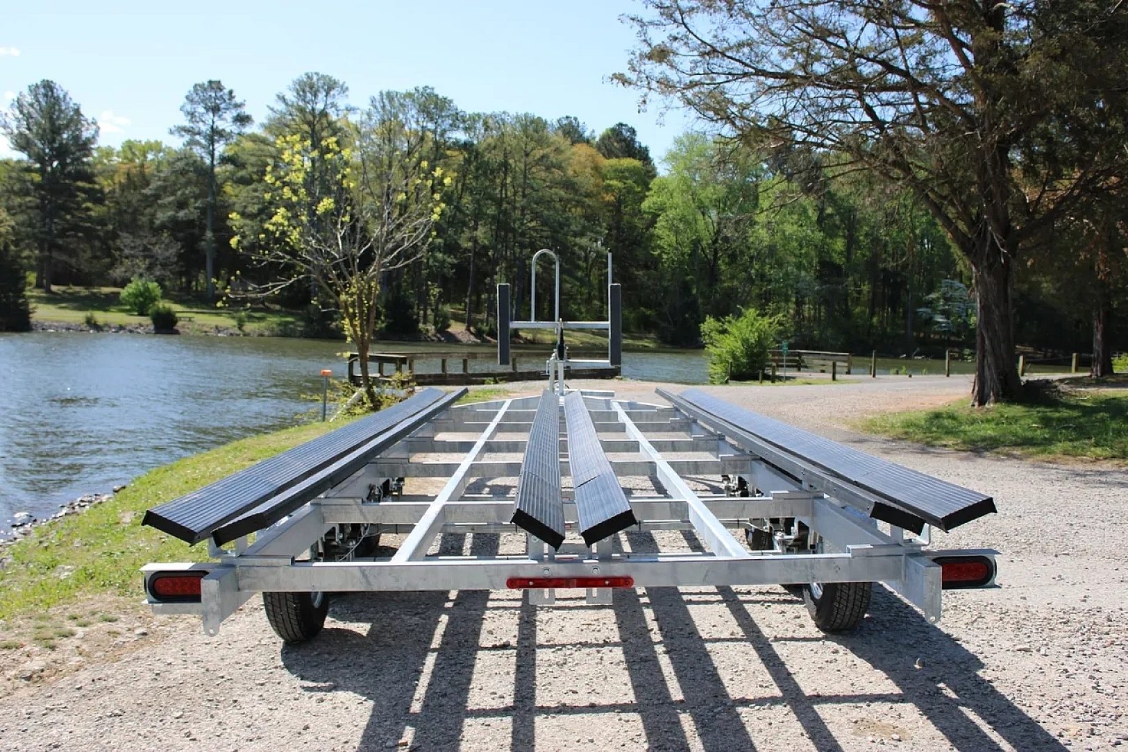

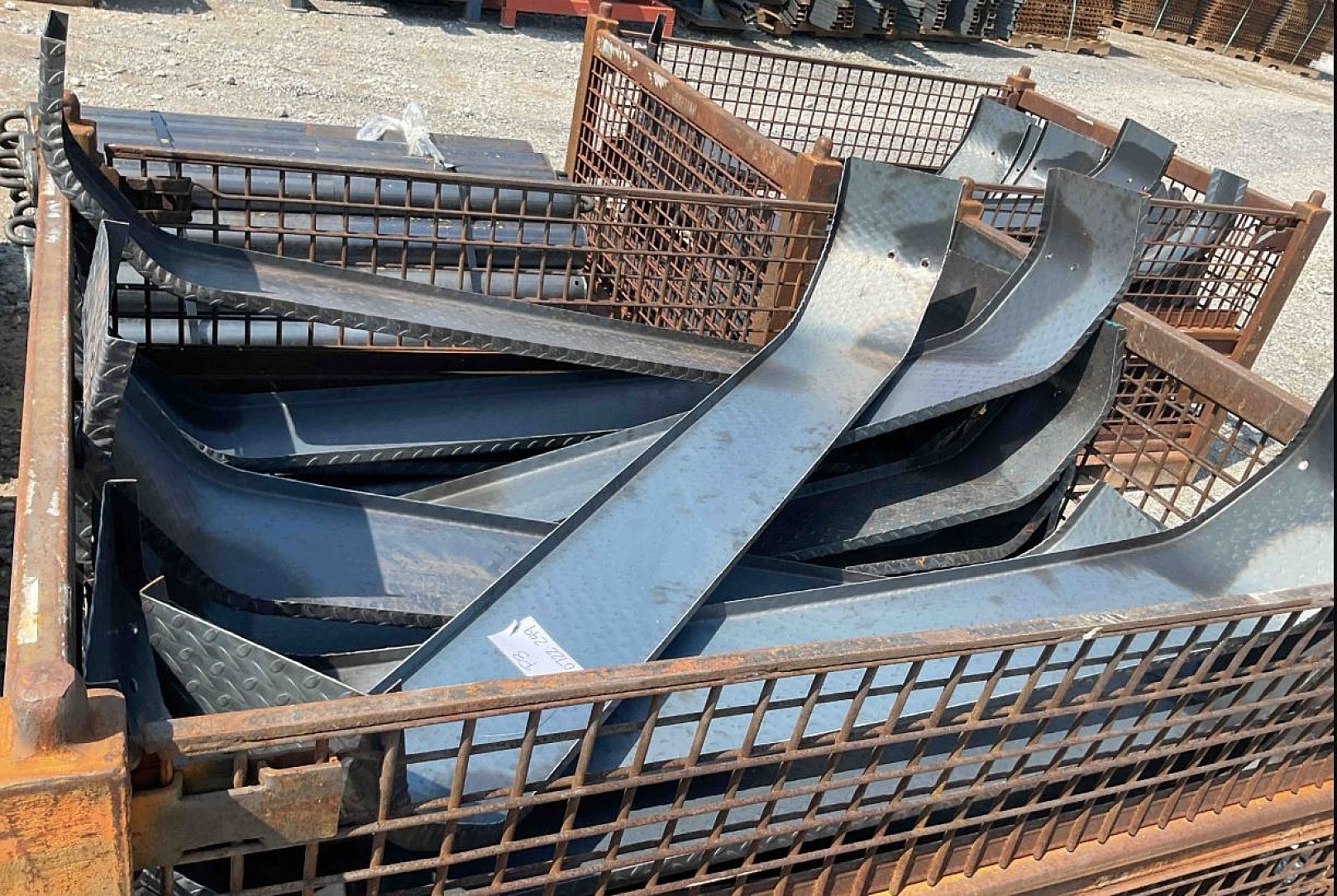

P3's commitment to HDG presented a classic engineering challenge: how to design a trailer with necessary vent and drain holes for optimal zinc flow without compromising the finished product's clean, premium aesthetic. P3 solved this through innovation in the fabrication stage. P3 meticulously engineered the trailer frame, with the help of their galvanizing partner, to hide these essential holes, placing them on the underside, behind non-visible support parts, or integrating them into holes used for lighting or other fixtures. This ensures that the trailer is completely coated and free of air pockets, resulting in a smooth and clean galvanized finish, all while keeping the process holes hidden from the consumer's view.
