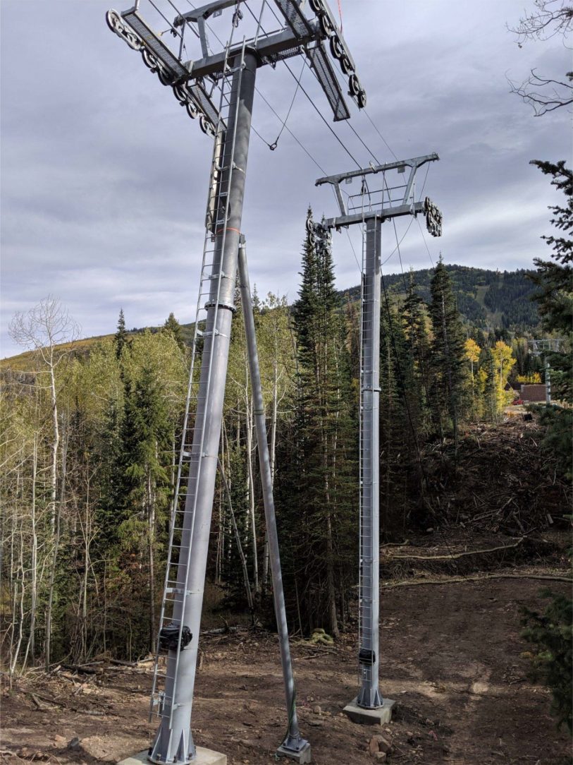

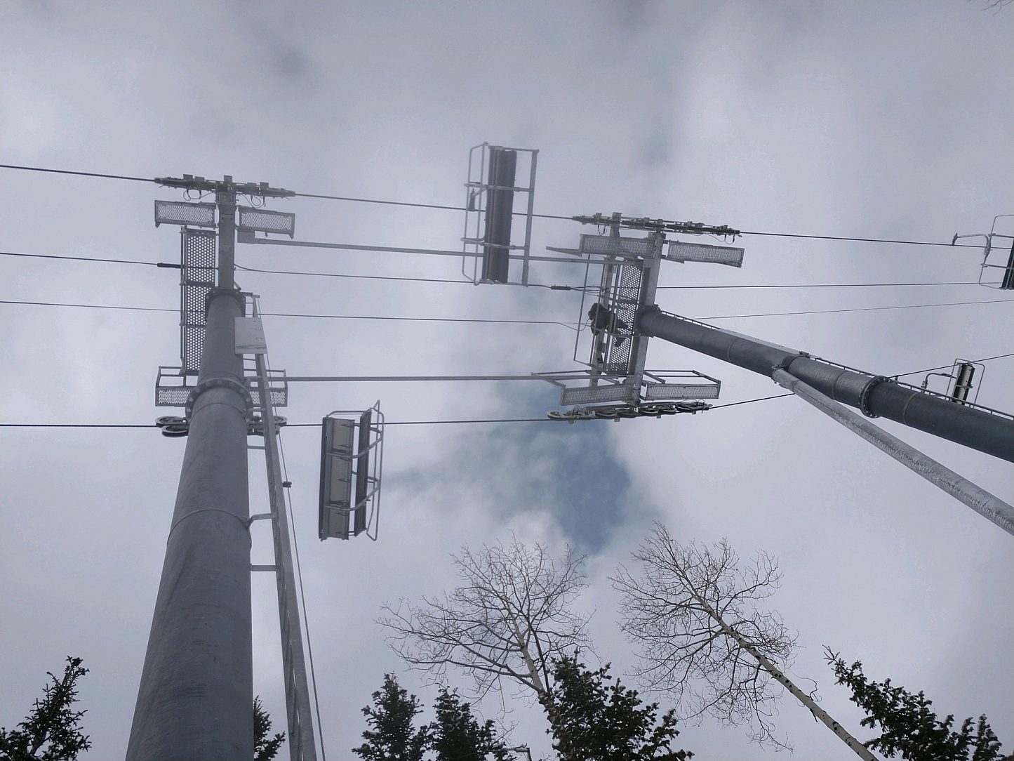

The Over and Out Lift is a fixed grip quad that was designed, fabricated and installed by Skytrac Services. The chairlift has a total of 14 towers spanning 2,412 horizontal feet and 278 vertical feet. It has 100 HP and 46,000 lbs. / ft. of torque. Hot-dip galvanizing was chosen for the majority of the steel components on the lift due to its superior corrosion resistance, longevity, and decades of maintenance-free service compared to other coating systems. Hot-dip galvanizing has a positive reputation within the industry with numerous installations exemplifying the strength of the coating. To provide the best experience possible for the resort, lift closures have to be kept to a minimum. Hot-dip galvanizing helps keep things running like clockwork because it’s virtually maintenance free, keeping customers happy and saving everyone money. Skiers and snowboarders visiting Park City Mountain Resort in the future will be able to breathe in the beauty of the Utah Mountains atop this long-lasting lift.

Line towers, cross arms, lifting frames, walkways, sheave beams, and drive structures
Steel: 119
HDG: 110
