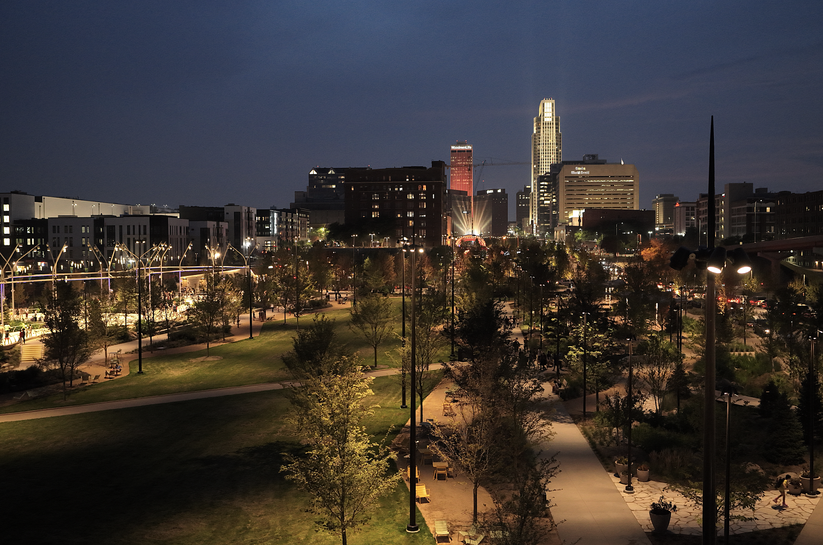

Downtown Omaha, Nebraska, has grown along the Missouri River since the city was first established in the 1800s. In 2018, project leaders secured nearly $400 million in public and private funding to connect and revitalize three parks spanning 72 acres – Heartland of America Park, Gene Leahy Mall and Lewis & Clark Landing. The vision for The RiverFront project was to breathe new life into the area with a vibrant park destination closer to the river, and to cultivate greater connectivity through park design, amenities and activities.

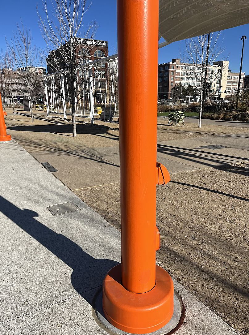

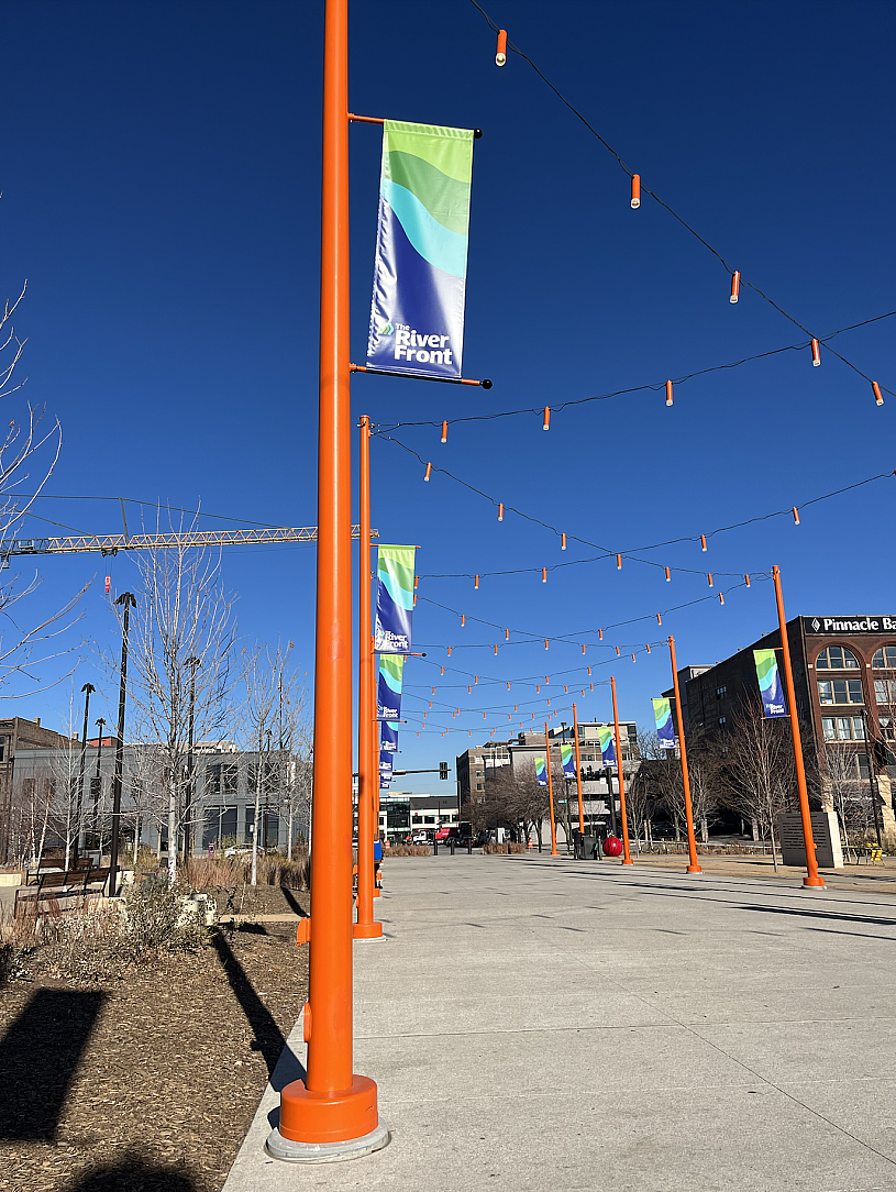

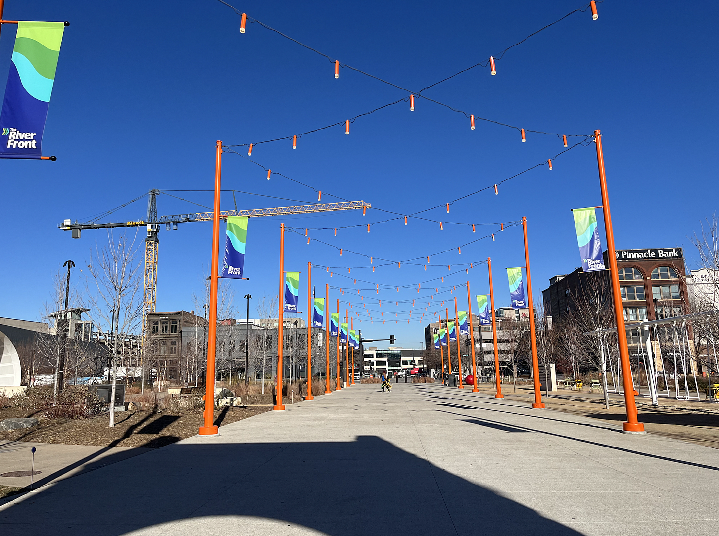

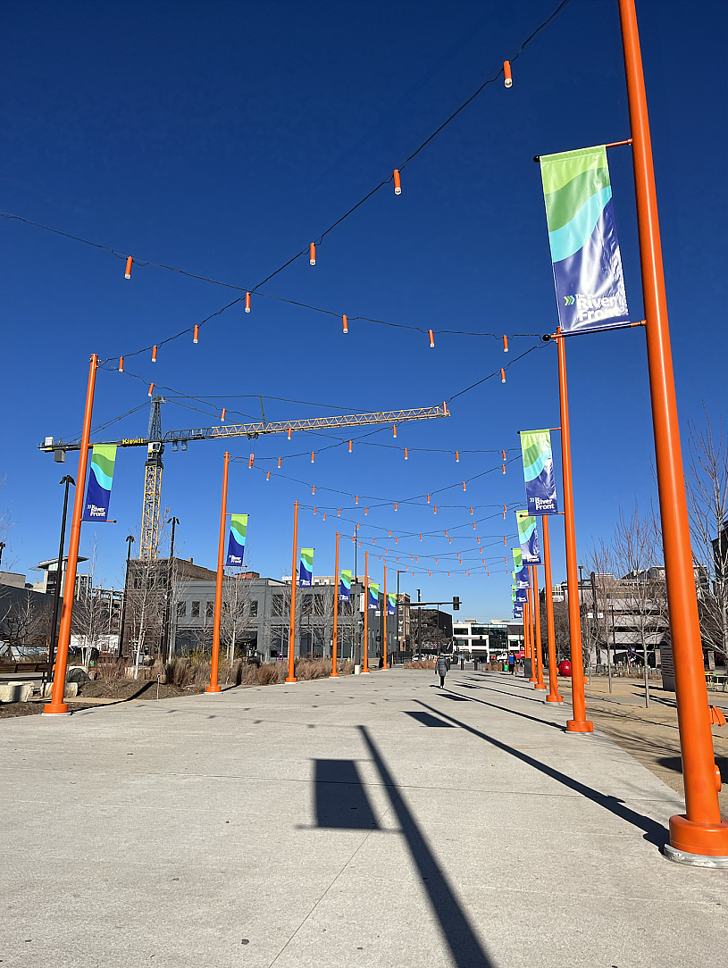

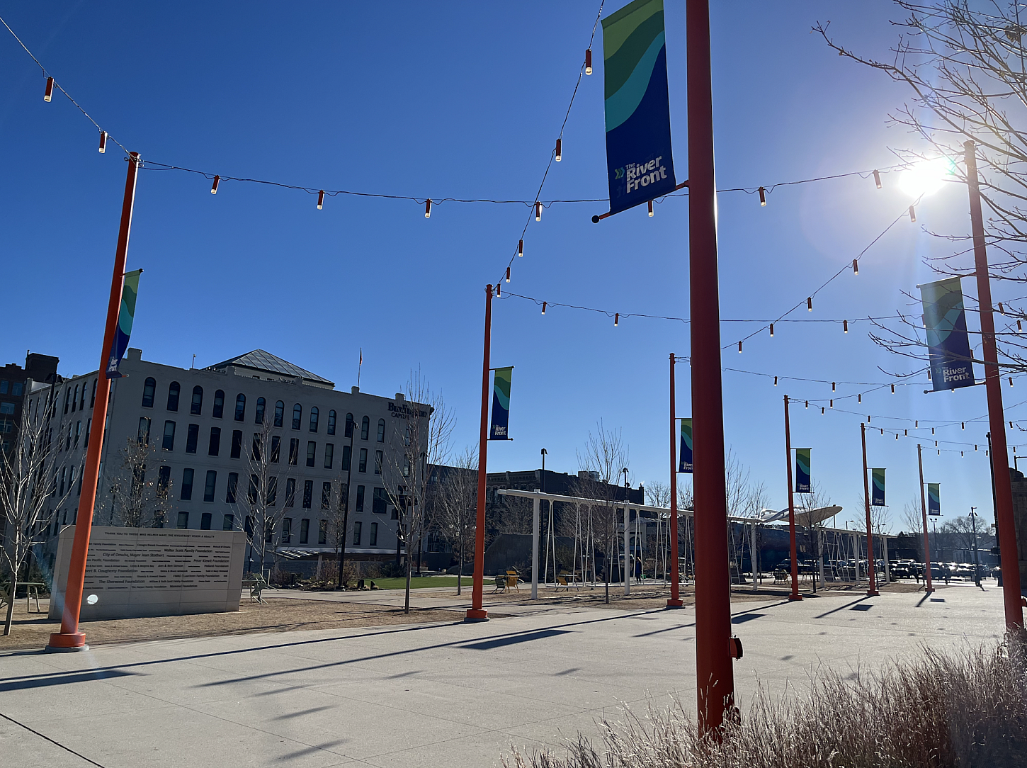

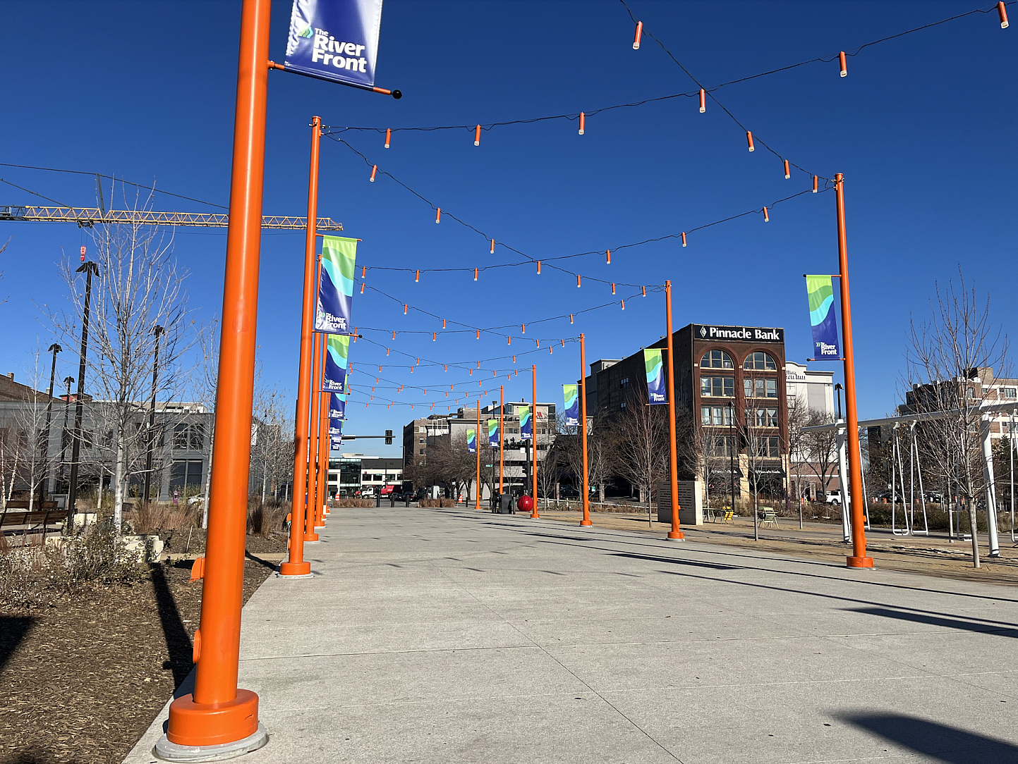

Several unique features developed by the manufacturer bring The RiverFront vision to life. Many in Omaha remember the landmark orange light poles at the Gene Leahy Mall. They aided in the re-imagination of the park’s entryway with a nod to this signature look of the past. The new, galvanized steel poles lining the entrance received an orange painted topcoat to remind visitors of the park’s rich history with color while standing strong into the future and reducing the frequency of maintenance or repairs.
Also, in the Gene Leahy Mall state-of-the-art, customized multimedia projection infrastructure is used for monthly activities and performances at The RiverFront. The manufacturer developed these galvanized steel structures to project in multiple directions with custom platforms to house the technology and a vibration damper at the top.
The project’s exposure to this Midwest environment that experiences a variety of weather conditions, increases its corrosion rate. By selecting a duplex coating of paint over hot-dip galvanizing, the steel poles will be protected from corrosion with an extended lifespan due to the synergistic effect of the two coating systems combined.
