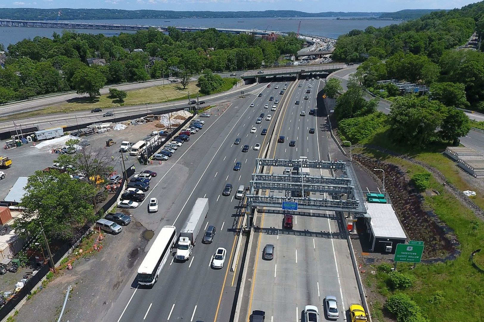

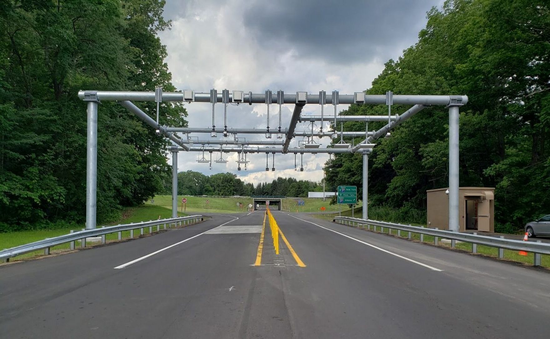

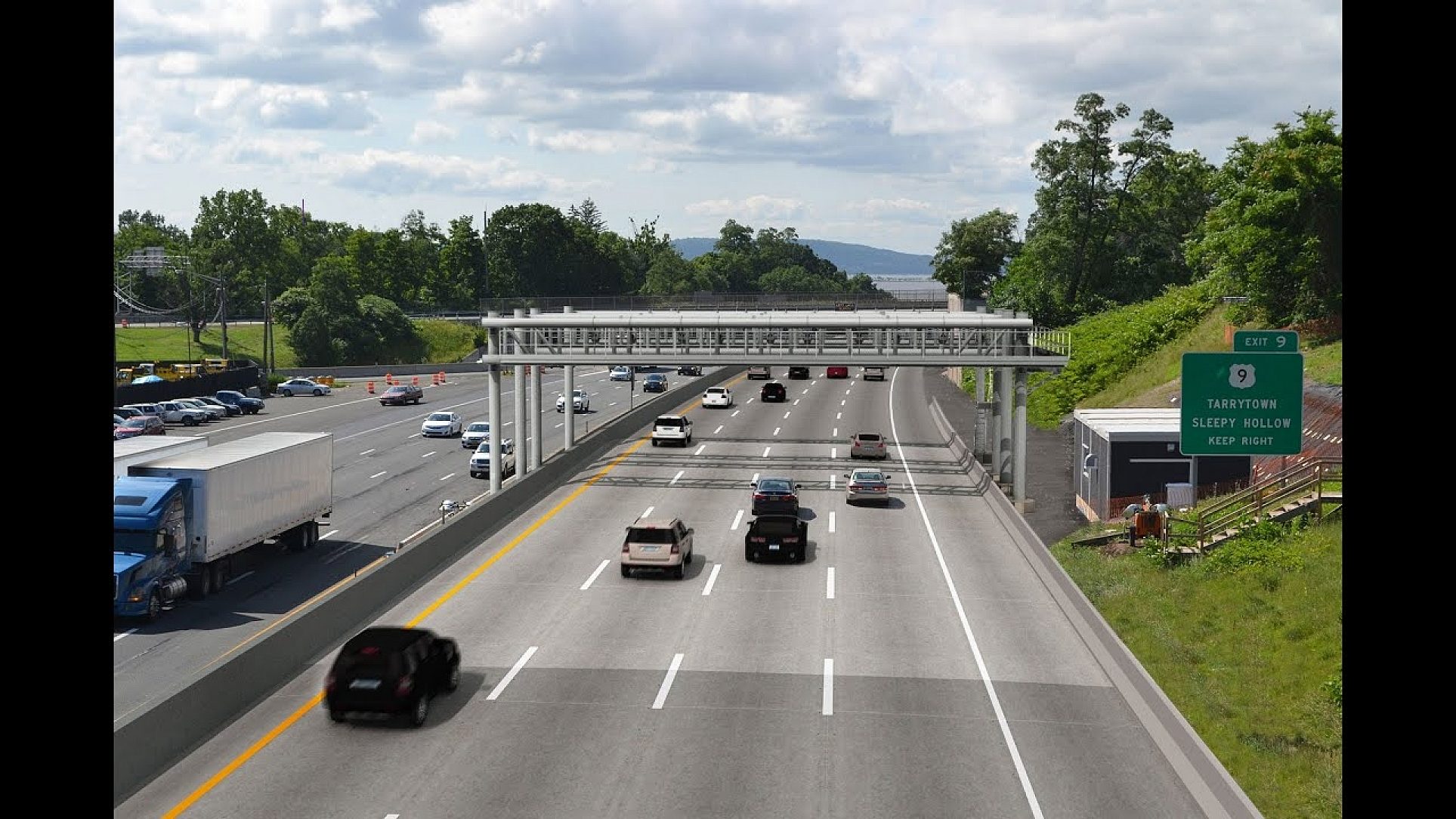

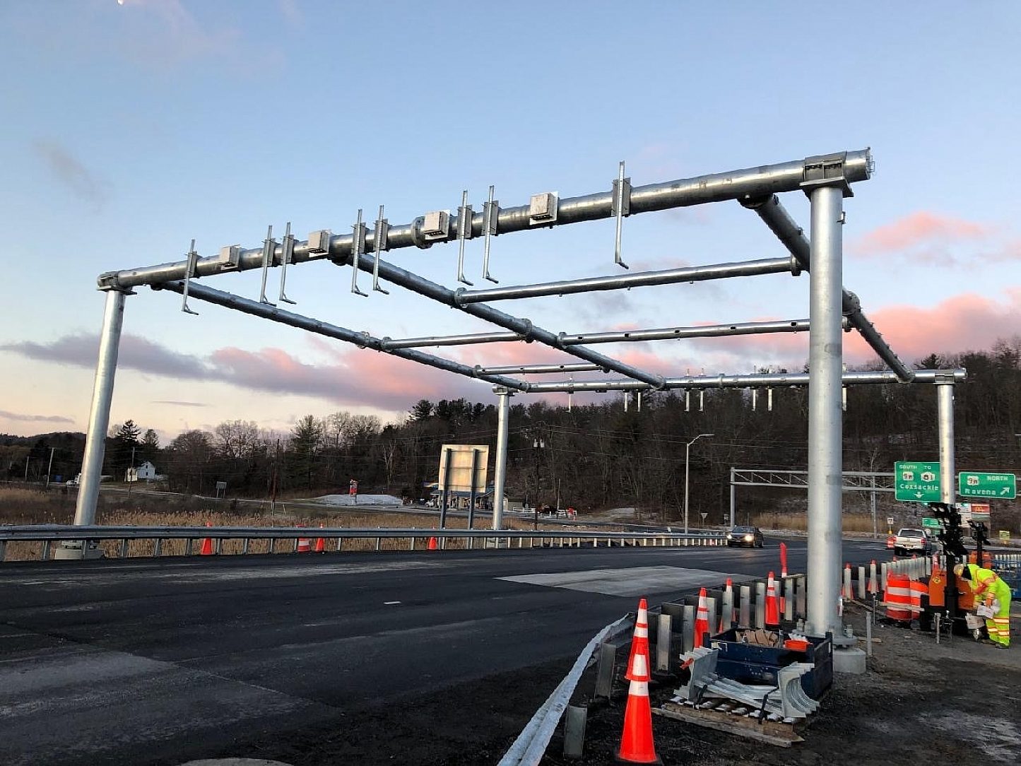

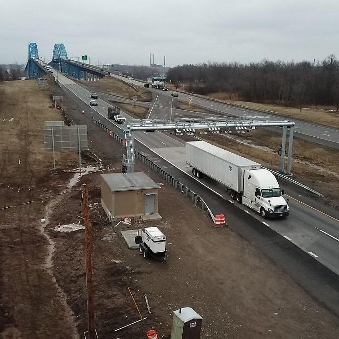

The $355 million project featured steel gantries with state-of-the-art technology have been installed along the Thruway to replace the old toll booths where cash tolls were collected. The new gantries are located over the Thruway or on exit ramps, depending on traffic volumes, safety, and other factors.

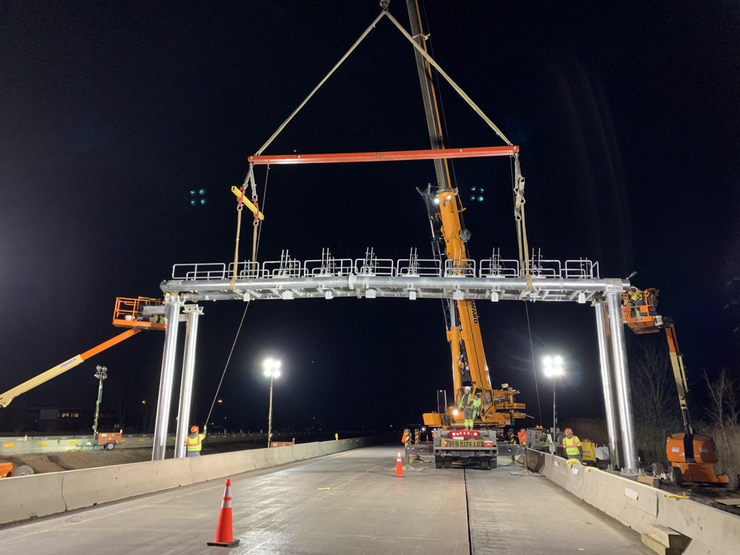

The schedule on the project was almost unbelievable. Construction began in the fall of 2019, and all gantries and toll systems were fully operational by November 2020. The final phase of removing the old toll plazas will take place in 2021.

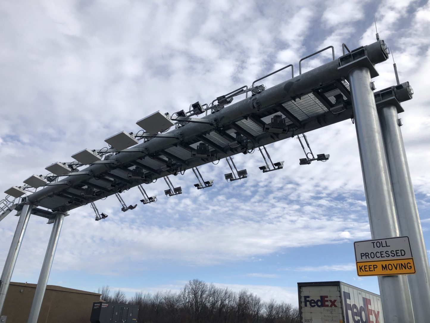

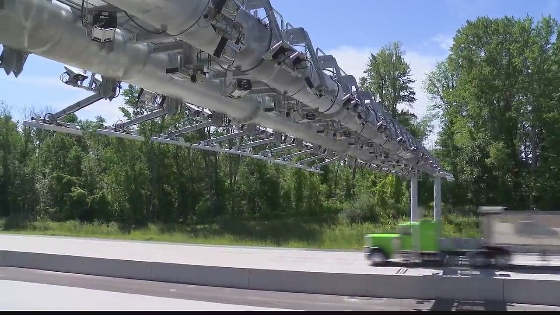

The Thruway Authority of NY took the initiative to modernize its antiquated tolling system. The project was designed to have over-the-road structures which would house cameras to track a vehicle’s path from the time the vehicle enters the thruway, to the time the vehicle exits. This 1,750-ton project was constructed of all galvanized steel. Galvanized steel was chosen as per the NY Thruway Authority’s specification, which calls for structures of this nature to be galvanized due to the coating’s performance and sustainability.
