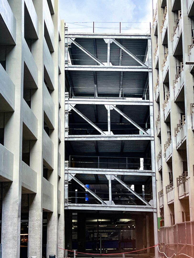

The vehicular bridges were fabricated with hot-dip galvanized structural steel, a deliberate choice made to ensure long-term durability, corrosion resistance, and reduced maintenance in Miami's highly corrosive environment. Galvanizing was selected over other protective coatings due to its proven ability to withstand humidity, salt-laden air, and heavy traffic wear with minimal upkeep over decades. It was also selected because of construction-related logistical access constraints and the need to meet vehicle clearance requirements.

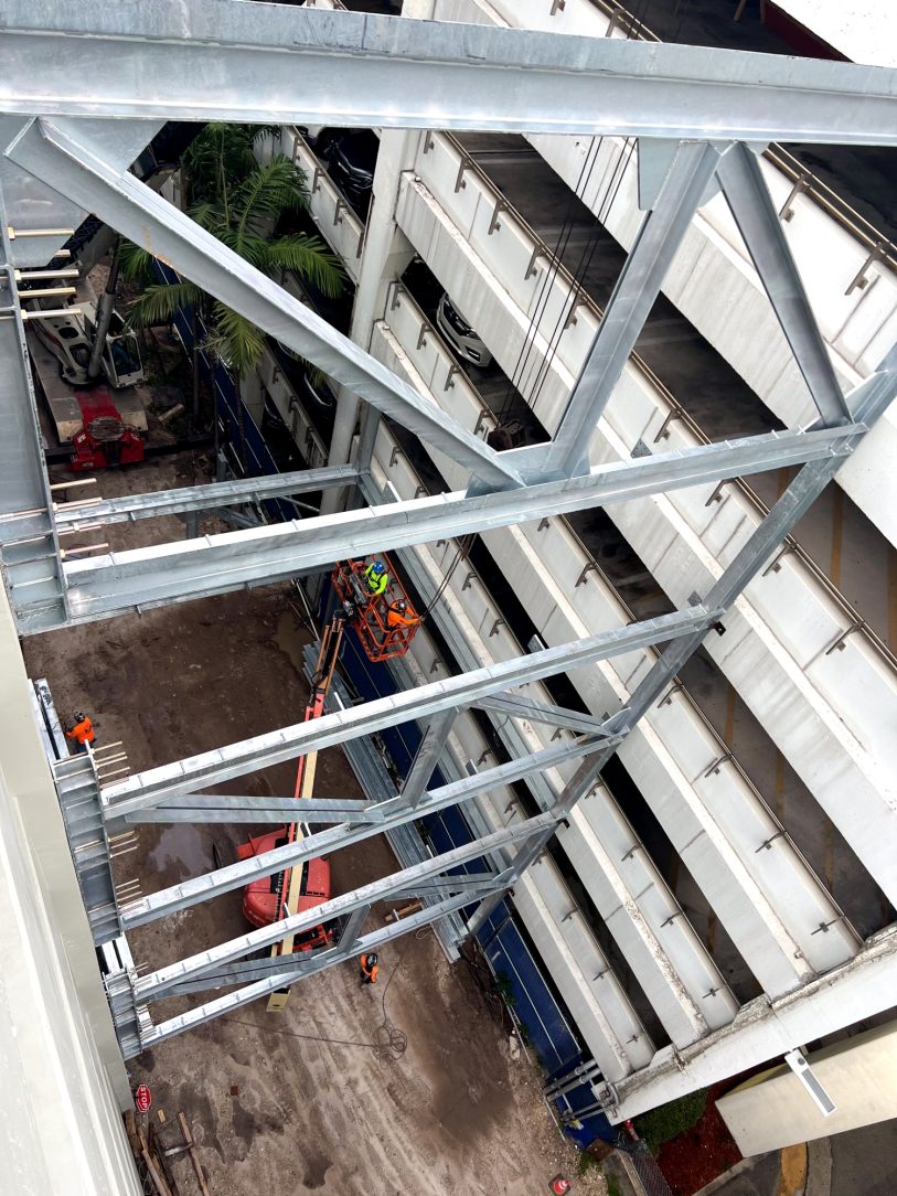

The galvanized components include the top and bottom girders, diagonal HSS bracing, columns, infill beams, and perimeter pour stops.
