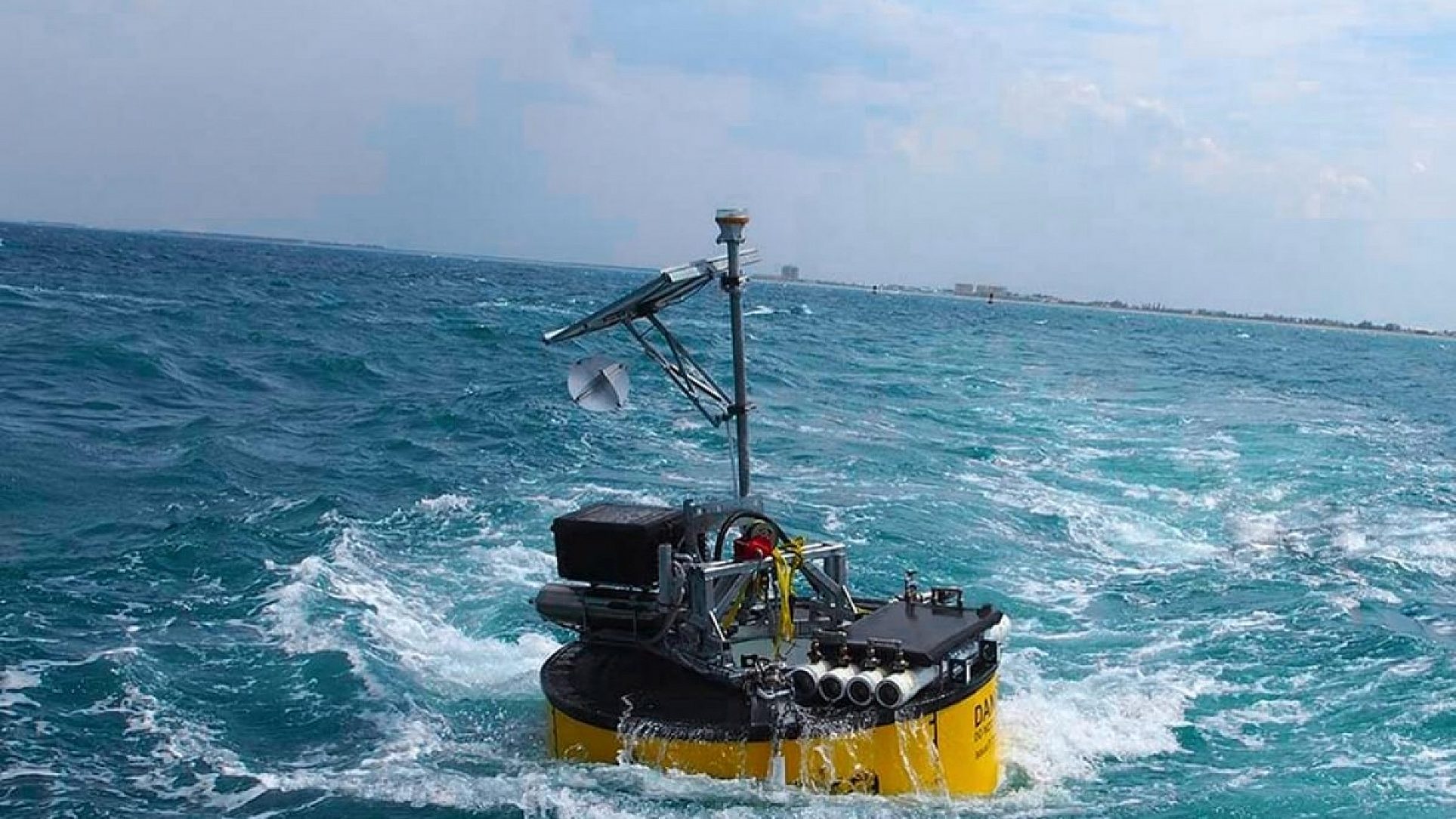

Enter Oneka and their desalination buoy. Each buoy uses reverse osmosis to desalinate about 2,500 gallons of seawater a day with zero energy use, zero land use and zero pollution. A big technical challenge for the engineers was to build the buoy that supports and powers all the desalination equipment. It had to be very strong and very corrosion resistant to survive the brutal environment of the open ocean surface. The salt water and air, incessant wave action and boat impact during installation and servicing all challenge any design.

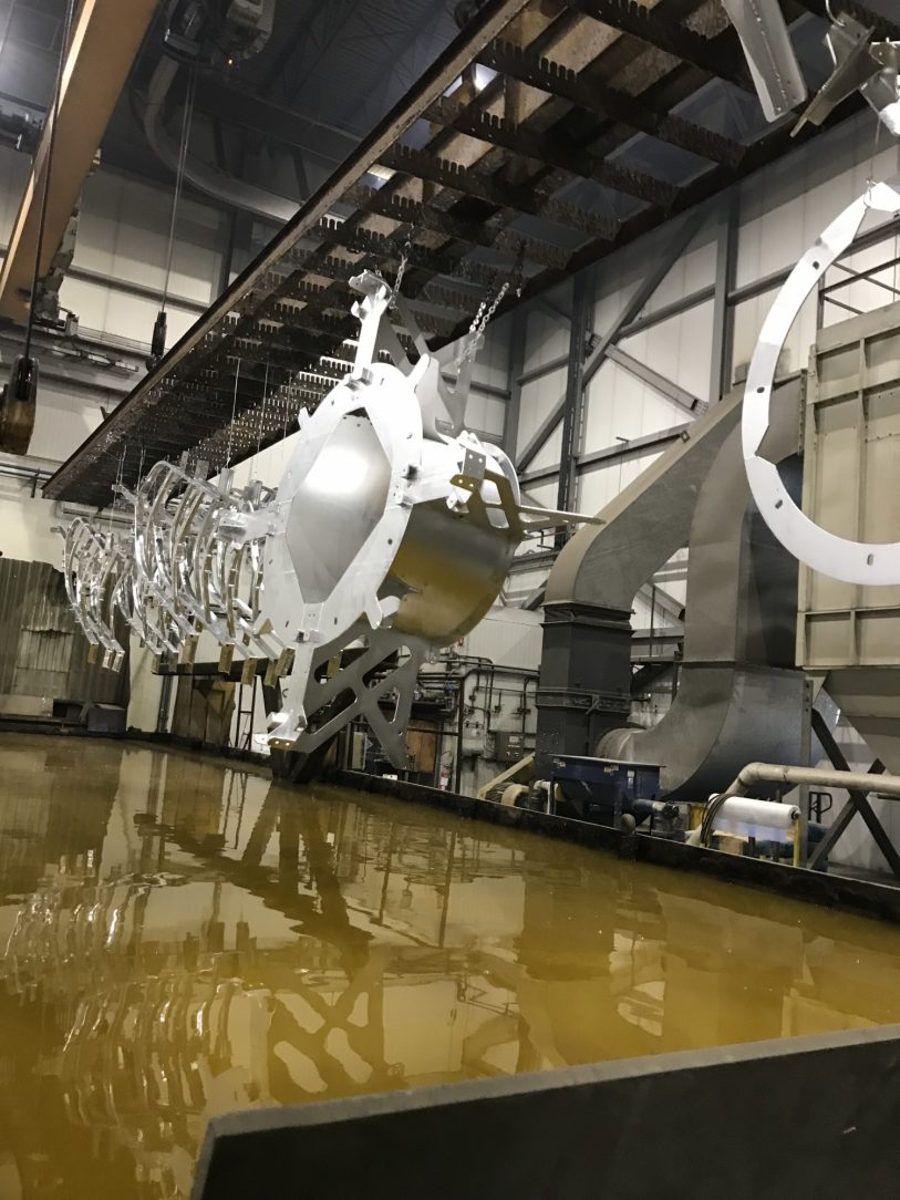

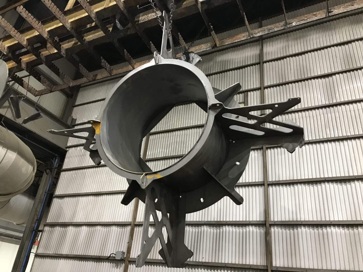

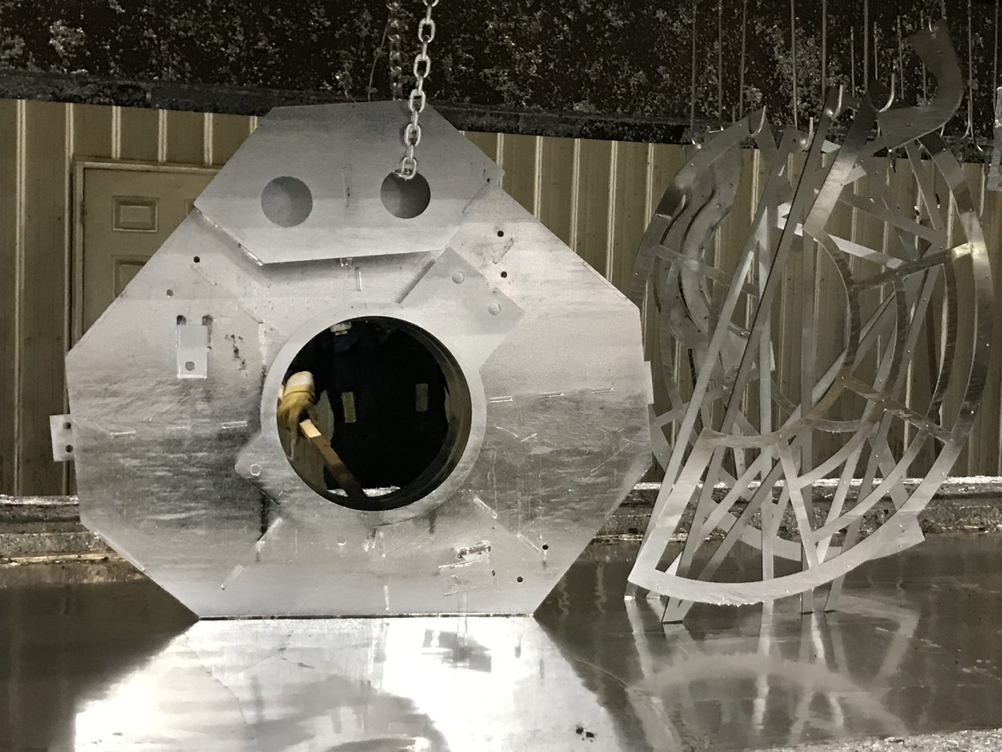

Earlier versions made with painted steel failed miserably and other metals proved far too costly and/or fragile for this difficult application. Hot-dip Galvanizing with its long-proven record in marine environments was a logical possibility. Careful co-ordination between the client and the galvanizer optimized the design and the natural qualities of pure zinc shine in practice with a service life that will outlast the mechanical systems within the buoy.
