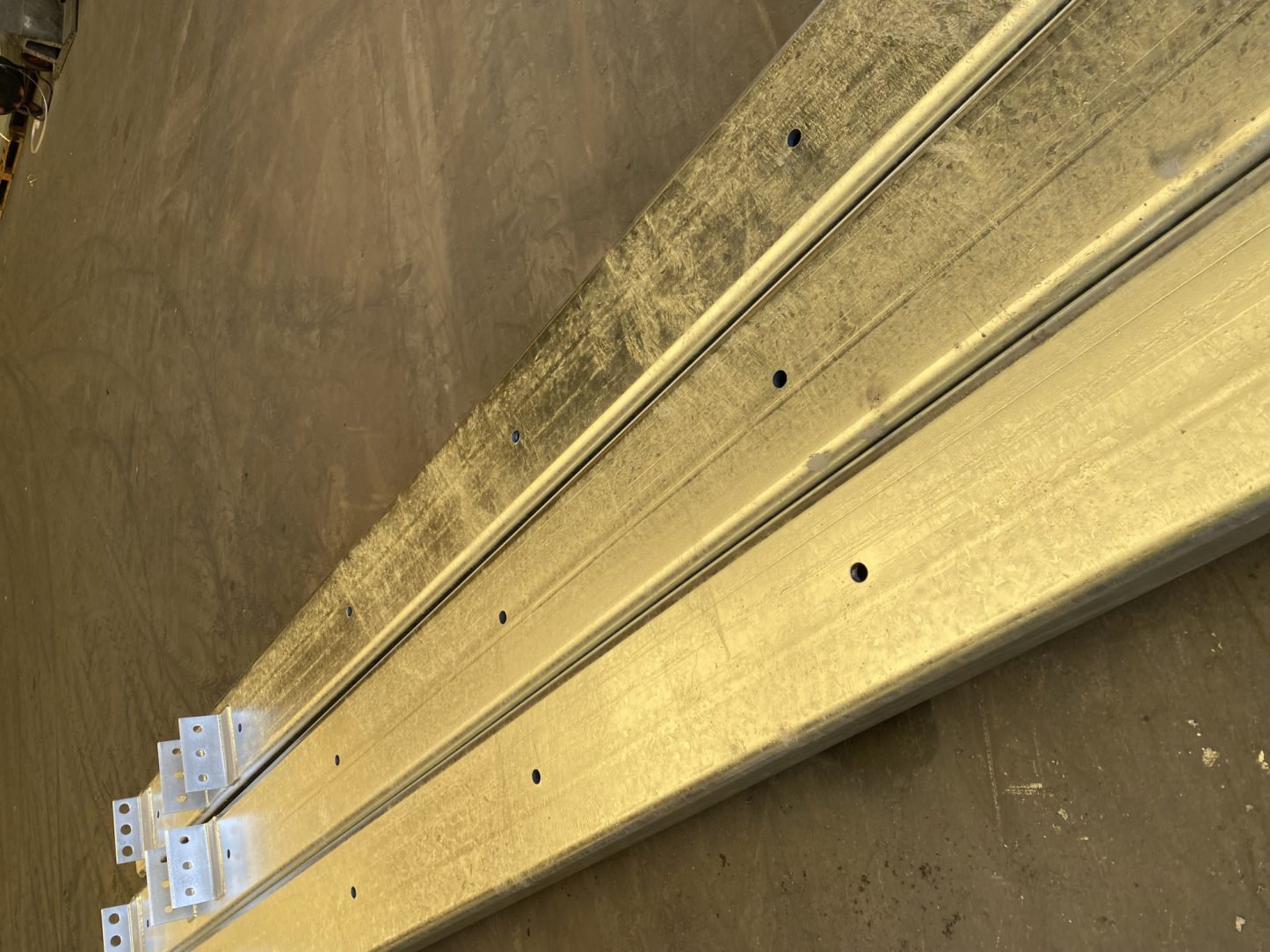

Stations for phase 1 of the city’s bus rapid transit system have been constructed along East Washington Avenue, University Avenue and Mineral Point Road. The 45 stations became operational in the fall of 2024. Each station is constructed with tube steel members that were hot-dip galvanized and painted after galvanizing. Since the steel members are AESS it was important for the fabricator to work closely with the galvanizer for vent and drain hole locations and sizes to make the project a success. A duplex system was specified to give the city the best of both worlds, the corrosion protection they need and the color that they want!
