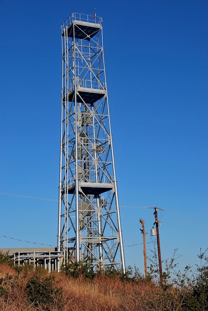

The latest self-supporting, galvanized steel tri-pod (LMR) tower that has been constructed is 109 tall and is located at an existing communications facility at the top of Mount Lukens in the San Gabriel Mountains of Southern California. Corrosion control over the service life of the tower was of supreme importance to guarantee the tower would be a reliable part of the new emergency communication infrastructure. The design team concluded that the best way to accomplish this was to build the tower using hot-dip galvanized steel that included pipe columns, tube columns, grates, angle, channel, ladders and handrails. The innovative tower design was a good application for hot-dip galvanizing due to the fact that very little field welding was required during erection. The various tower components had wired identification tags secured to them throughout the entire galvanizing process helping to quantify and collate the material when it arrived at the Mount Lukens site. Both hot-dip galvanizing and design ingenuity were key ingredients in addressing cost control pertaining to fabrication, galvanizing and final assembly of the tower based in an isolated remote location. The tower at Mount Lukens is ready to be put into service as soon as the (LA-RICS) initiative goes online countywide.
