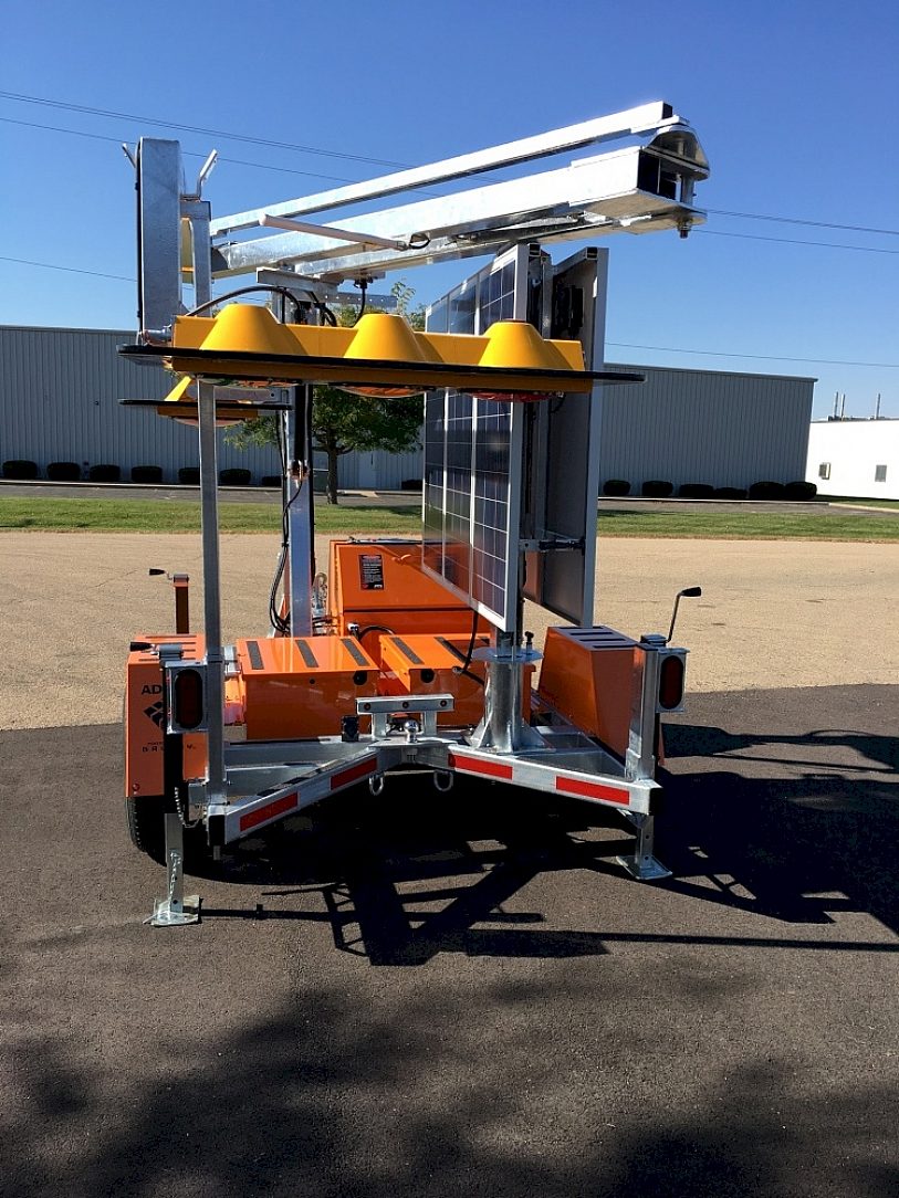

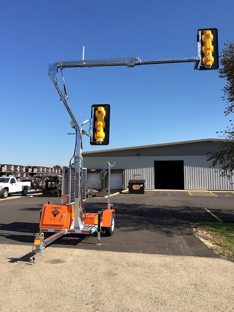

Originally these trailers were powder coated with a 7-10 year life expectancy at which time they were removed from service due to corrosion. While working with John Thomas to extend the life of these trailers we were able to switch the entire base and arms to galvanizing. All other parts of the trailer are replaceable if needed but the underbody itself is where they experience the most rust in part due to not being able to protect the inside of the tubes with the previous powder coat method. By galvanizing we are coating the outside as well a the inside of each tube offering more protection and corrosion benefits while extending the life of each trailer.
Galvanizing the signal trailer and arms made sense in more than one area. From a financial stand point HDG is a large cost deduction for John Thomas vs. the previous powder coat system. There is also less time spent making repairs due to the delicate nature of assembly on powder coated frames. Regarding the expected life cycle of a signal trailer, they were seeing a 7-10 year max on the highway due to constant exposure to salt, wear, and weather. By HDG we were able to increase the life of the trailer to a minimum of 40 years conservatively while offering the option to bring the trailer back in, make repairs or replace the mounted fixtures and send them back out onto the highway.
